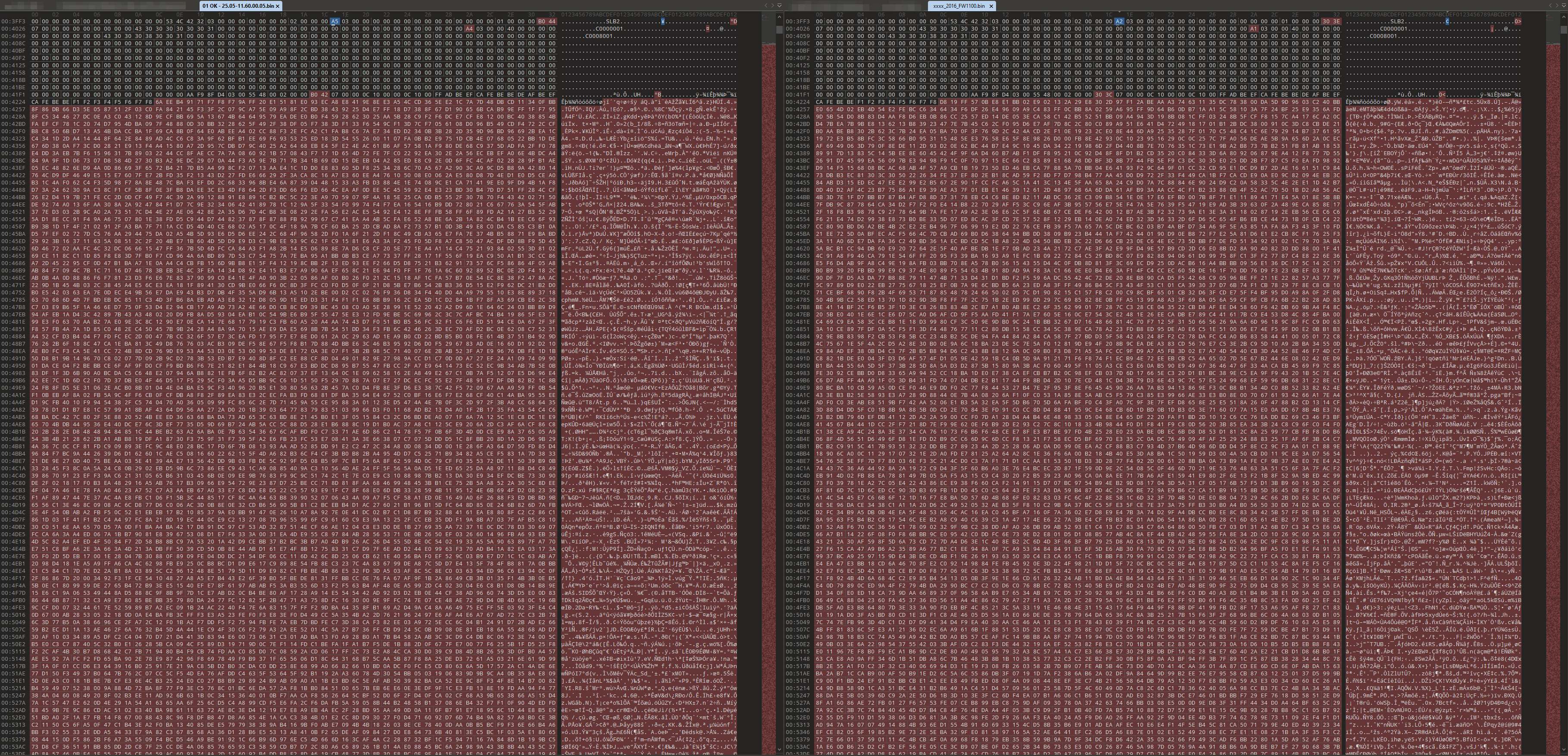

At first sight, content is definitely not the same ...
By side of that, I do know at which memory location I have to find/replace some values, anyway, is there a formal list somewhere just to to be on the safe side ?
