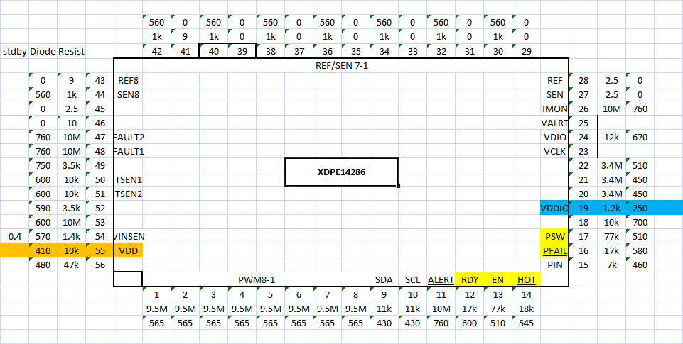

I would check around the XDPE chip:
B0088108 = XDPE bus error (case: defect XDPE chip. After replacement PS5 working again.)
808B00FF = SSD controller watch dog timer error. (case: XDPE faulty. After replacement PS5 working again.)

C00C0303 = VRM controller access error. There seemes to be still an issue with the XDPE chip.
I would check the both pins 9 (SDA) and 10 (SCL) for good readings.
Readings are somewhat off, but not sure if it's still in range of being fine.
Diode: 616mV
Resistance: 16,3k
I have checked the caps all around the Chip again. Like 90% of them beeped from both sides (measuring for continuity). I'm assuming it's because the area of the board cause I can't imagine all of them being broken.
What the current behaviour of the ps5? What's the power sequence when connected to a power supply? Are you getting the right signal on the enable pin of the xdpe?
