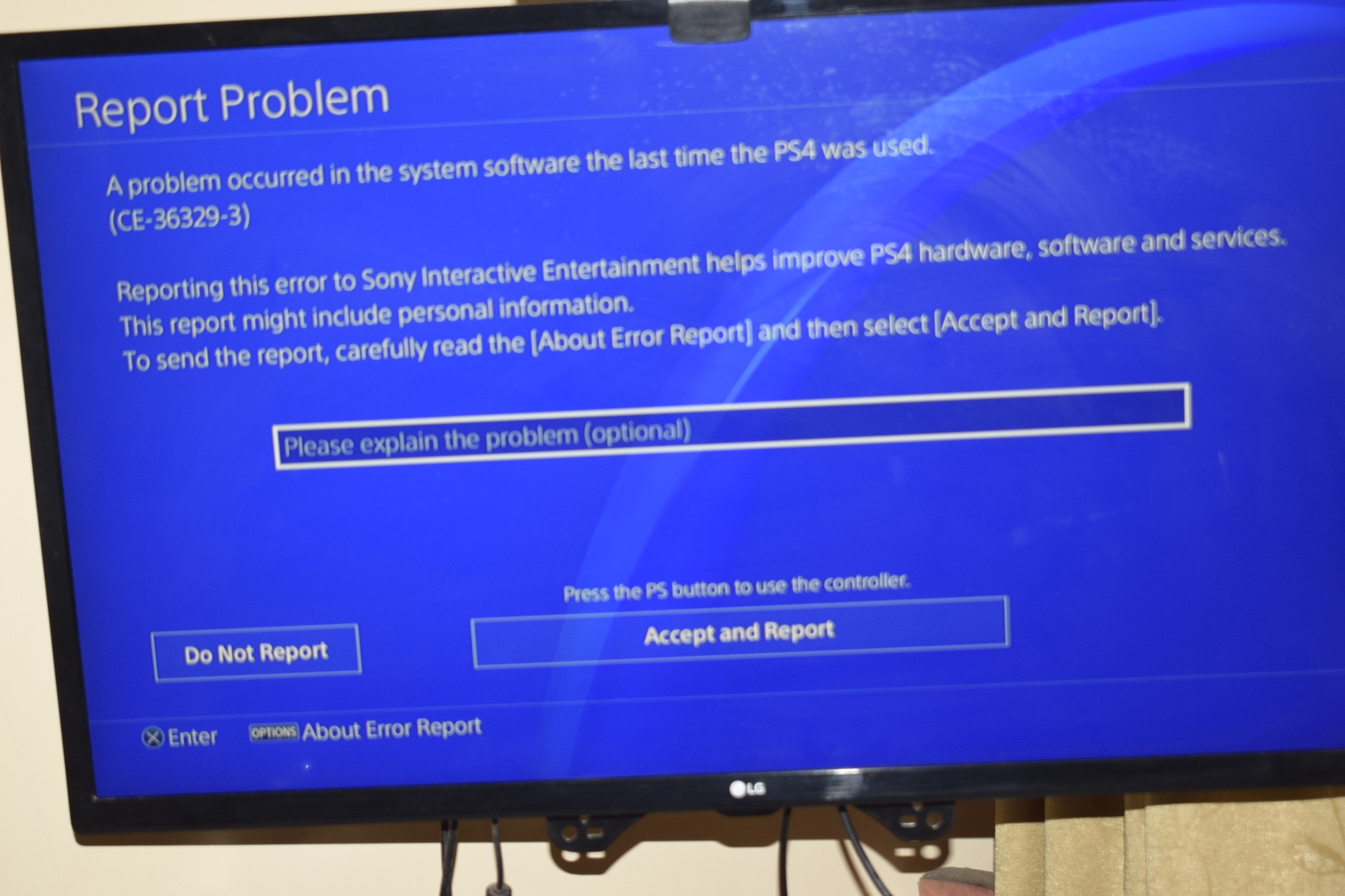

hello there everyone....
so here is what i did now.
started my ps4 system which i had shutdown as per my previous post.
system clock showing 1-1-1970/05:30
reset the time manually as it asks to update the system and connect to psn to do it via internet when set to automatic and set now.
then went to my exploit page of v10. tried to load exploit + hen. the system crashed.
rebooted my ps4.on starting it rebuilt its database automatically as it always does when the system crashes.
on complete booting it had given me a message saying an error had occurred the last time error code ce-36329-3. do you want to report. i chose do not report and continued to my home page.
checked the date and time. it was again back to 1-1-1970/ 05:30 am.
reset the time again.
went to v10 in browser and loaded exploit + hen 2.1.3
this time no crash. tried to start the game and it gave me error ce-30391-6 and logged me out.
logged in again and loaded the ToDex. and tried to start my jailbroken game again.
kicked me back to homepage giving the error ce-32875-5.
i am also posting the picture of the first error here.
you can also see the video of the process after the second reboot here
ce-36329-3 (Software error... Sony always recommends you update to try fix it.... don’t unless you can downgrade)
ce-30391-6 (Date and time error again)
As Centrino said it’s possible you need to sort time and date... have you tried change the CMOS battery.. Last resort but yeh...?

Let's recap
- exploit + hen, crash, rebuild database, ce-36329-3 (Error with an application or system software)
- system time is 1-1-1970
- manually set time to now
- exploit + hen, NO crash
- start game, crash ce-30391-6 (System Error), log out
- (what's the system time?)
- log in, todex, start game, crash ce-32875-5 (devkit expired)
As @KiiWii and me (https://gbatemp.net/threads/aio-ps4-exploit-guide.497858/page-433#post-9274841) mentioned, first you should try to change the CMOS battery.
@KiiWii well the 30391-6 was fixed by running the ToDex payload.
i hope so it is only the cmos battery now cause almost for about 11 months my ps4 was not in use as i was stuck onboard during the pandemic. so yeah.....maybe the battery is the issue or atleast i hope it is and nothing else. i havent tried replacing the battery yet as i am not confident with my skills in handling electronics but i guess i have to do it.
if the problem still persists then i guess i have to leave my ps4 on the shelf for now and do good with my ps3 and nintendo switch.....and wait for the exploit on 7.02 or higher. but will be checking the thread for some fix regularly as in 11 months i have missed a lots of games to play.
@Ballbag i had reset the time to now every time after the crash.

is that the rtc time? I know you can change it with godmode on the 3ds, but I know of no way to change the ps4's.
I don't know if just resetting the clock in the home menu will work. on the 3ds, you reset the clock in godmode. that's for rtc. if you make a nand backup or something, it uses the rtc time to create the file from what I remember. altering the home menu time does nothing to the rtc.
Reactions: vivekanand
@godreborn That's what i'm wondering about too. I guess @Ballbag knows the exact technical details. Another thing which is conspicuous, is that the system time is still 1-1-1970 since yesterday. Thus every time the ps4 restarts (short cutoff of electrical current to the cmos) its 1-1-1970? Well, to me it more and more likely the cmos battery is completely broken.
@godreborn. just for my clarification......replacing cmos battery will reset the rtc clock? i mean the whole idea of replacing it is about the rtc time which is suspected to cause the issue....right?
I dunno. that's a likely possibility. I changed the rtc of my 3ds to the real time. it's now a part of the 3ds tutorial from what I remember. I'd imagine rtc is how it determines whether a time-active game can be played on the ps4. I know rtc on the 3ds is what's used for certain time sensitive things in 3ds games like animal crossing, so you can't simply change the time in the home menu to cheat. it uses rtc, which without a cfw system, you can't change.
@vivekanand No, but a new battery will 'hold' the cmos clock. You said, you already hat to reset the system time after every reboot. Well, just let me construct something. Your system did work because there has been electric current long enough to set the OS System time. Any software running does see 'check, time is ok'. Now your battery is so broken, there isn't even enough time to set OS System time on boot up.
And the most irritating thing about this ... it's even not an issue of any kexploit. This can happen to any PS4. And if it does, you are forced to connect to some Sony Server to update the cmos clock?! Wow ...
imo, the playstation clocks are shit. I've had two ps3's that when reset in the xmb are off by like three minutes after a few days. they stay that way. the wii u doesn't have this problem.
btw, there's a syscall for rtc with the ps3 from what I remember, so there's probably one with the ps4, which may be why it keeps resetting from a software standpoint.
I hope so. Because if just replacing the CMOS battery doesn't work, because also the system time has to set afterwards every kexploited PS4 is 'doomed' in some future day.
