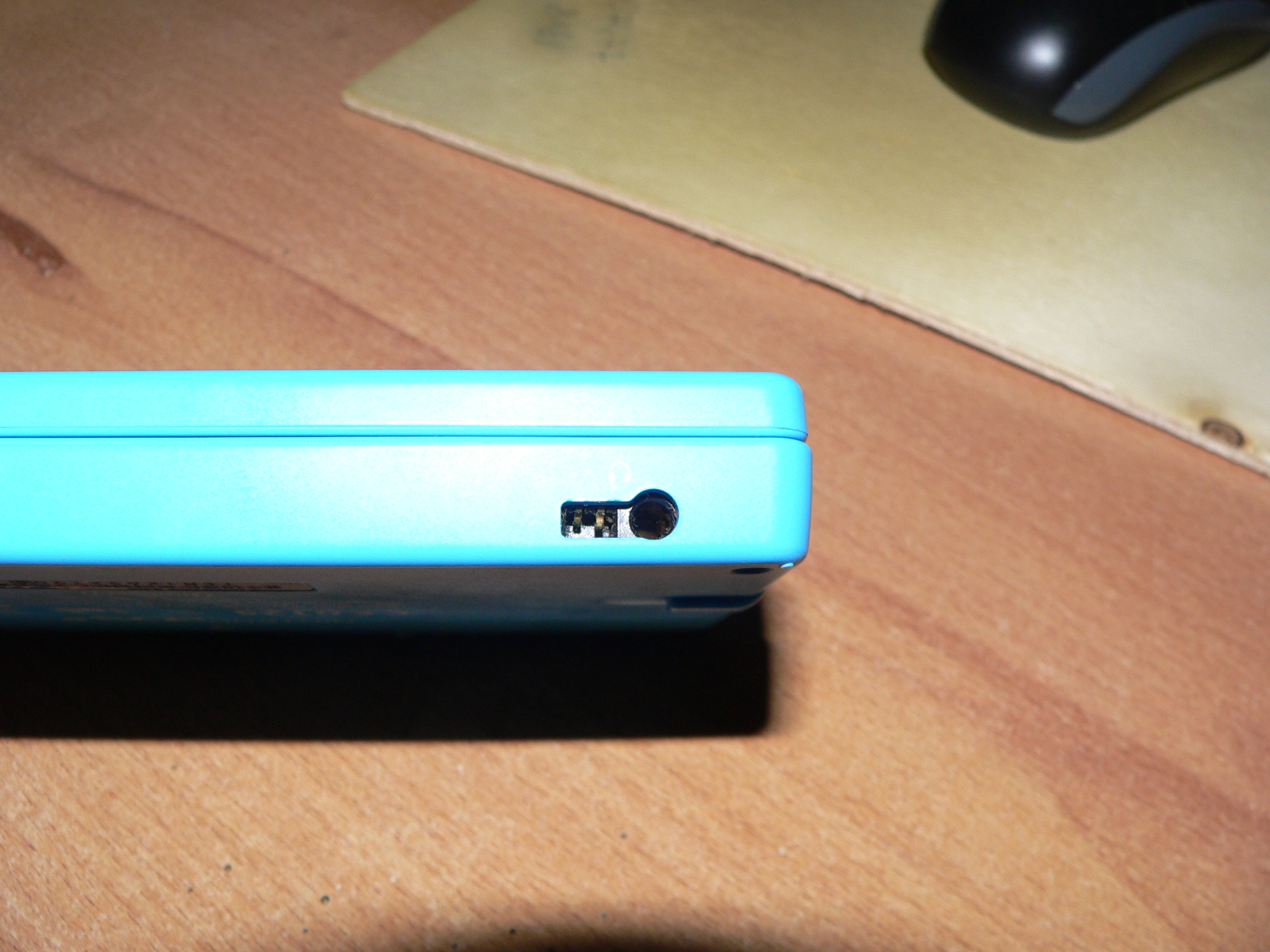

Hello! I have a Nintendo DSi XL, but playing a game I realized that the microphone does not work. He tried the trick of moving the rods from the earpiece, when I touch it with a pin it makes contact but nothing else. Any solution?

Are you using headphones? headphones have been known to make the mic stop working with twighlightmenu for some bizarre reason
Hello.
Did you maybe checked the DSi´s Contacts/Pins too ?

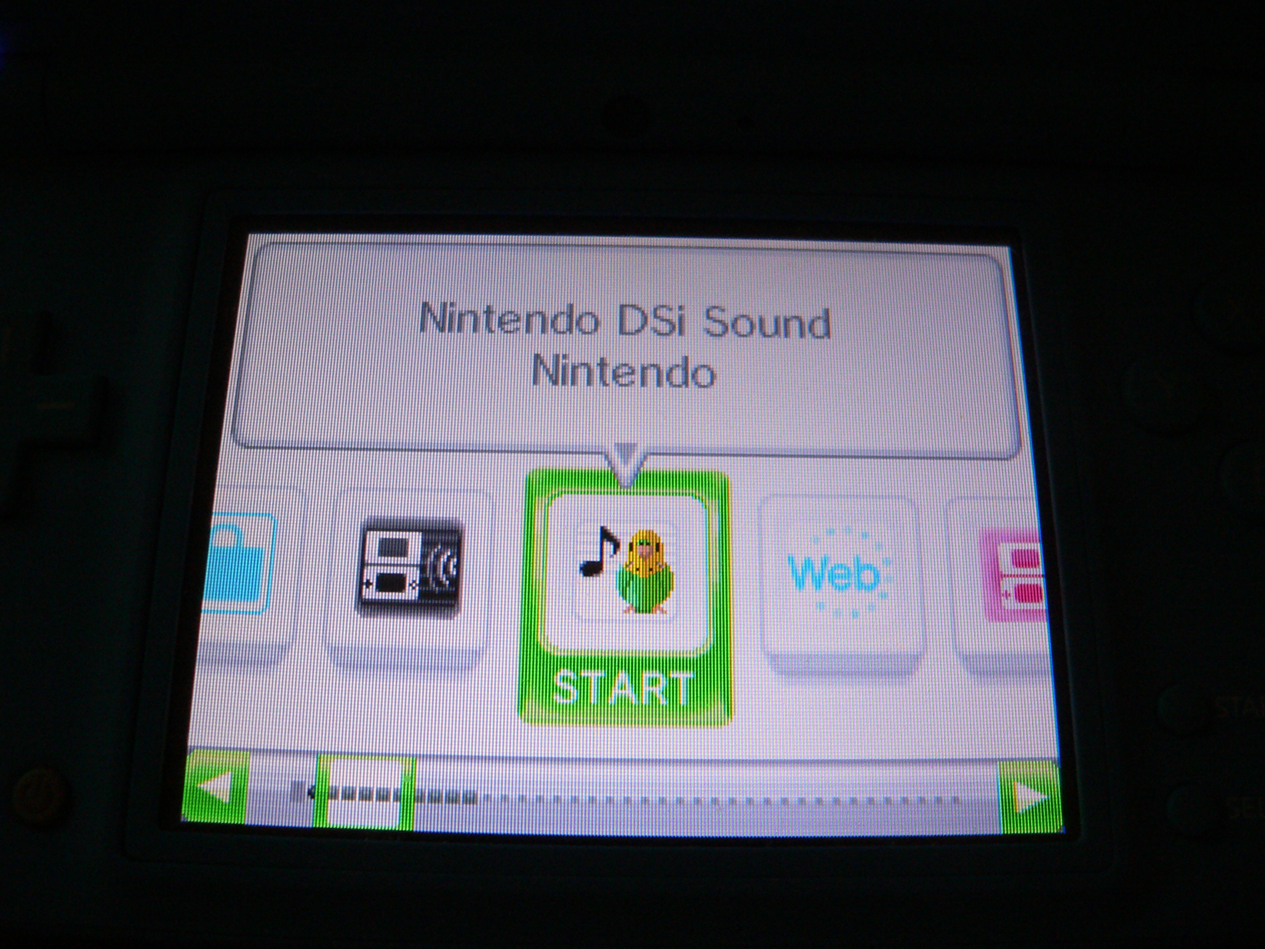

For me the best Method was to open the DSi Sound Tool and try it,slowly and calm.It is what I do little by little but I cannot put into operation ... could you make a video of how you move the connectors?
If you have nothing on the Records (no crackles/sounds) then maybe it is unfortunately really broken.![]()

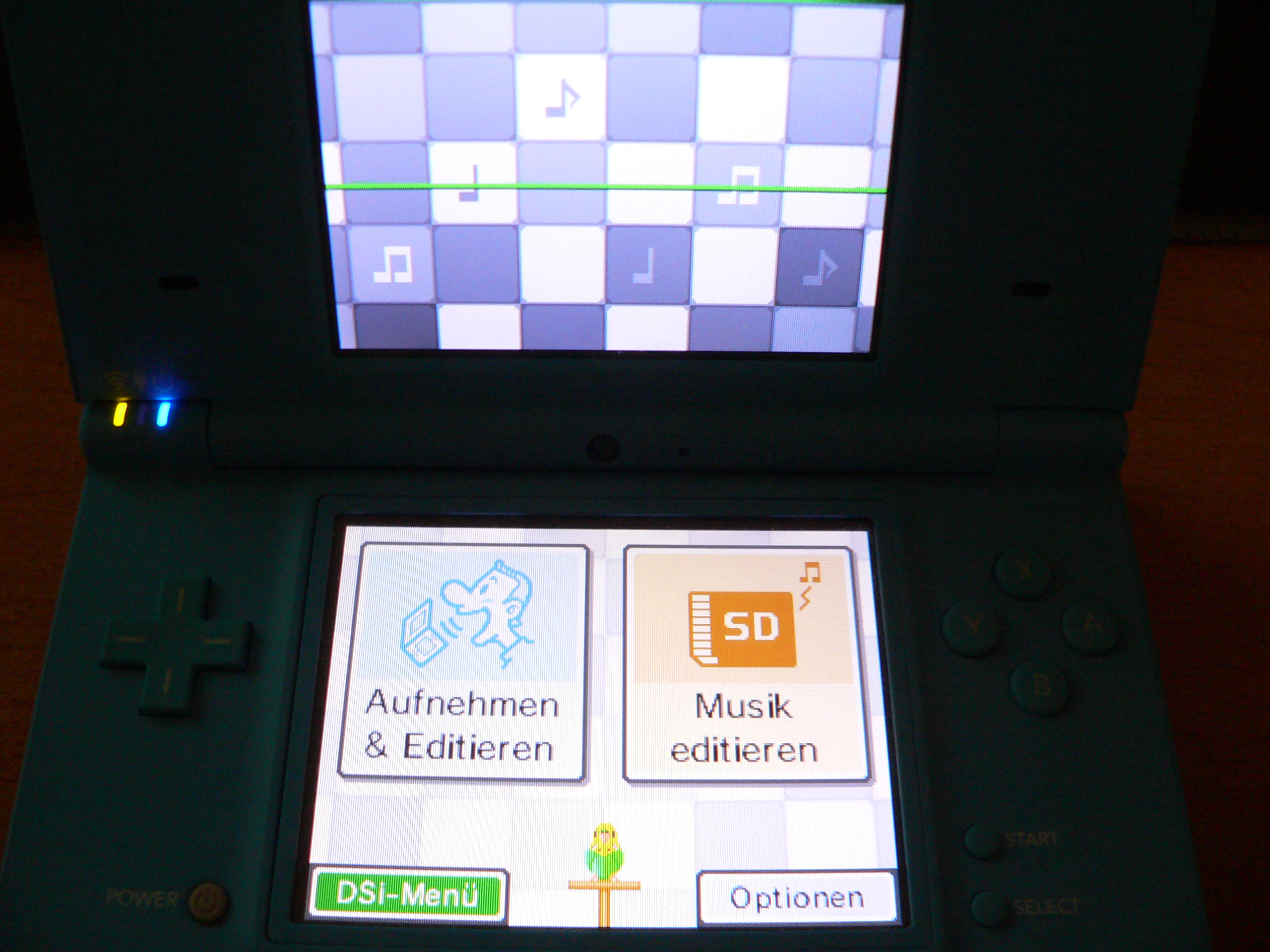

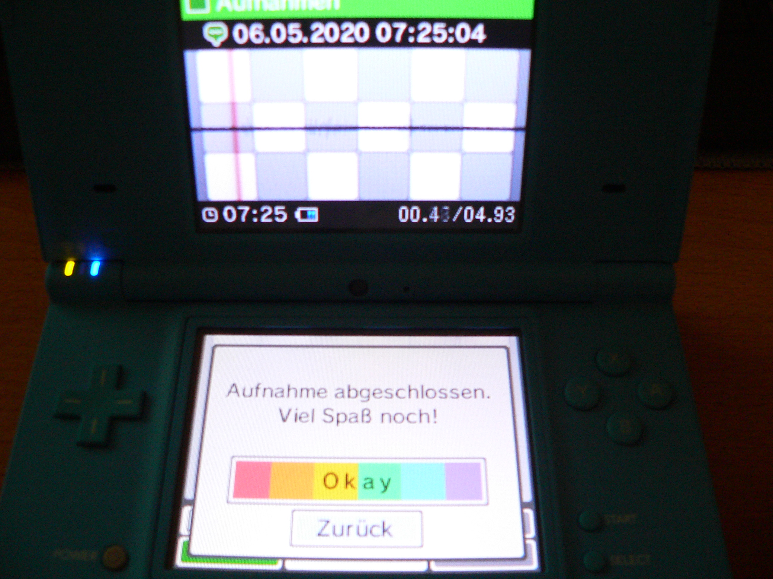

The Nintendo DSi Sound Tool on the DSi Menu ? Dangerous ? That is really new to me.

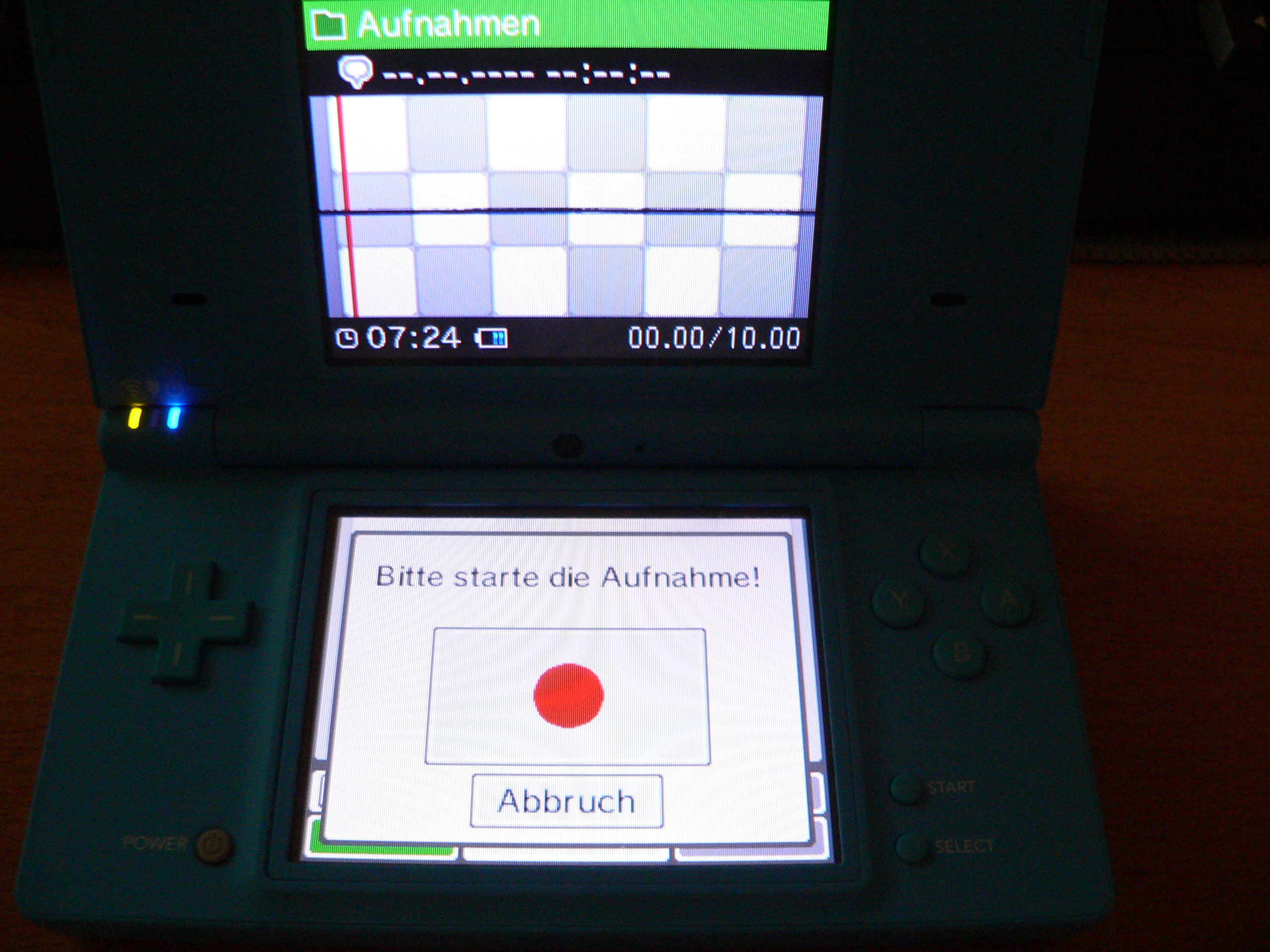

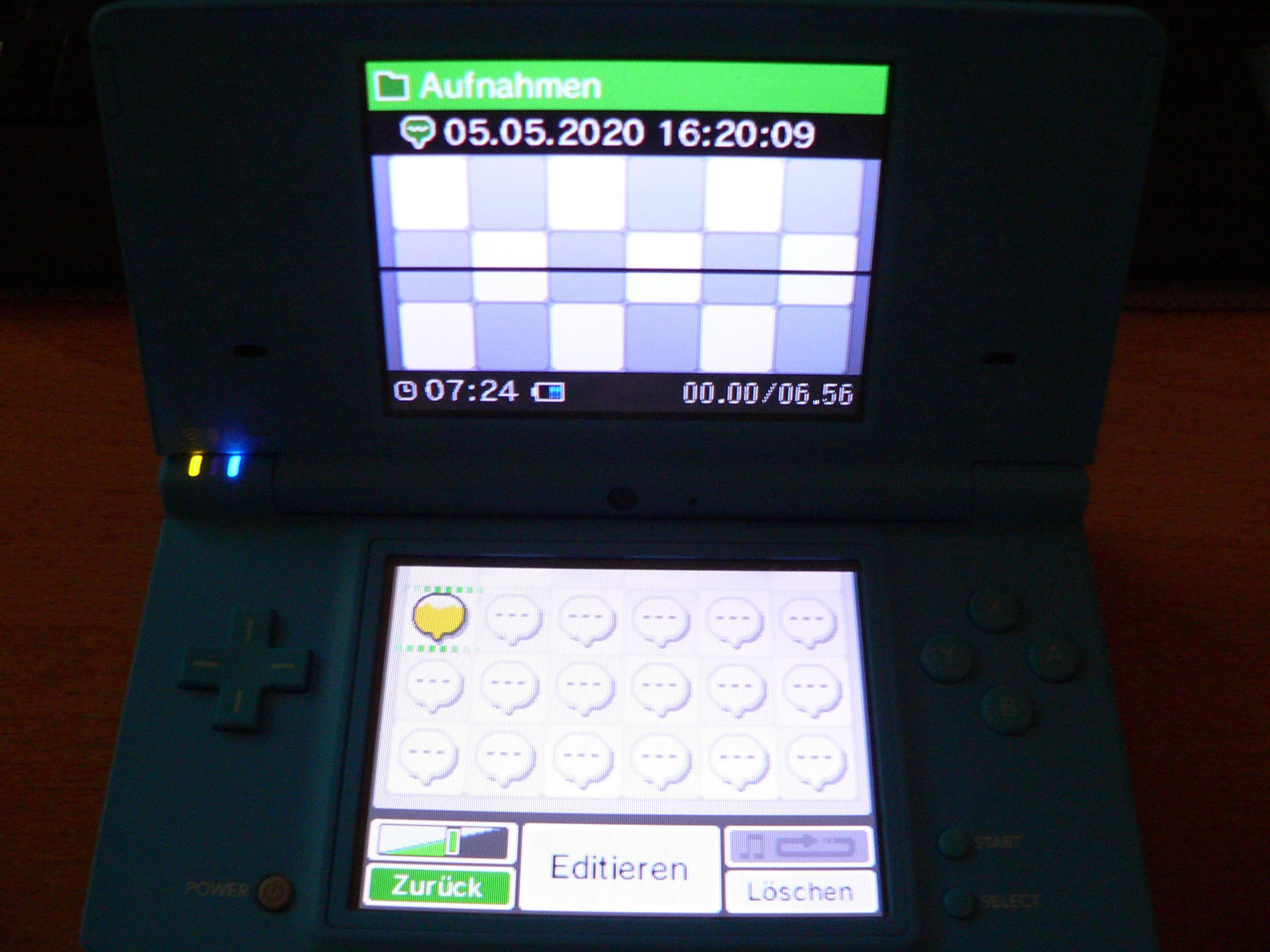

View attachment 207844 View attachment 207845 View attachment 207846
Excuse me,if I was a little unclear for you.Here you can record Sounds with the DSi Micropone.
What I want to say is:
- Open this Tool please
- Record and at he same Time try to "correct" the Pins please .
- You will see an the "Amplitude" on the Upper Screen
View attachment 207847 View attachment 207848
during Record if something goes "IN".
Good luck and
Thank you.![]()
