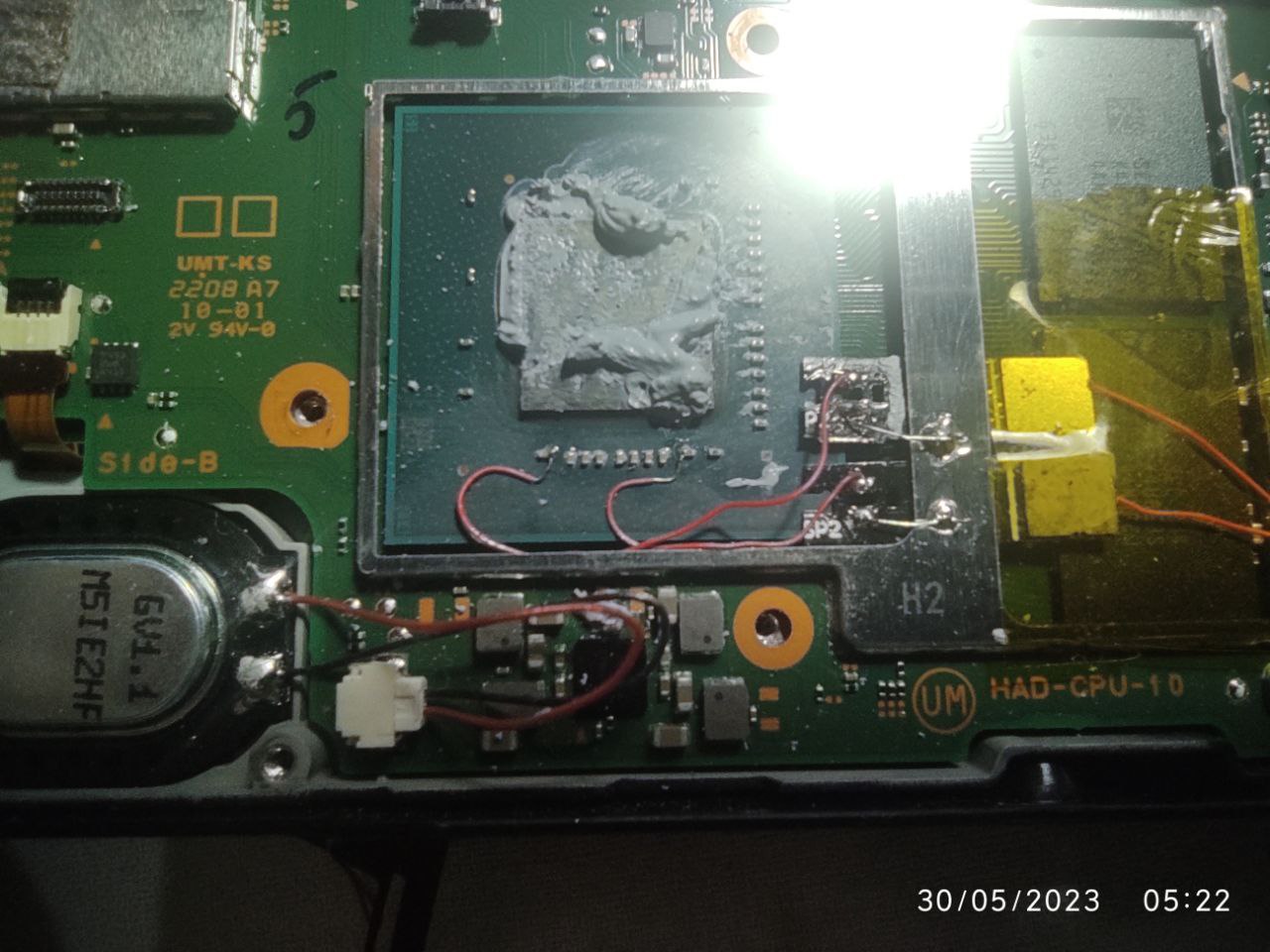

With the wires shortened as humanly possible (the Pico positioned on the top of the EMMC) and two caps with single MOSFET it still behaves the same way. Time to try the SDA/SCL option. Those are only data connections, so 0.1mm enamel wire should be fine, right? Does it matter how the wires are routed, on the back of the MB or through the front; it seems to be the same to me, but then again I'll be doing it for a first time so no idea if it makes a difference?
Finally success! It wasn't smooth sailing though. After SDA/SCL not only was I still getting ==* but it also stopped booting into OFW with black screen and not even backlight. Disconnected the SDA/SCL wires and still nothing. While removing them I knocked off the Data0 wire from the resistor on the Pico and was a pain to resolder as it just wouldn't tin anymore. Finally got it on, but still==*.
At this point I was just going to backtrack, remove everything and start from scratch with better wire, but decided to give SDA/SCL another try and what do you know, it glitched just fine this time. Tucked everything in, put the shield on and again black screen, ==*.
Took the shield off, checked if anything was loose, nothing obvious, checked the glitch and it was OK. Put the shield back on, still OK; back cover on, still OK.
So, definitely something is not exactly right, but I wont know unless I redo everything. For now I'll see how long it holds like that and once I find some wire that works well redo it. The insulation on the 30awg Kynar I got from Amazon is too thick for reasonable cable management and doesn't self strip. In fact it seems to be silicone and doesn't melt at any temperature.

I had some Flex V1 left. A single mosfet always error. 2 flex v1 ok. Perfect start.

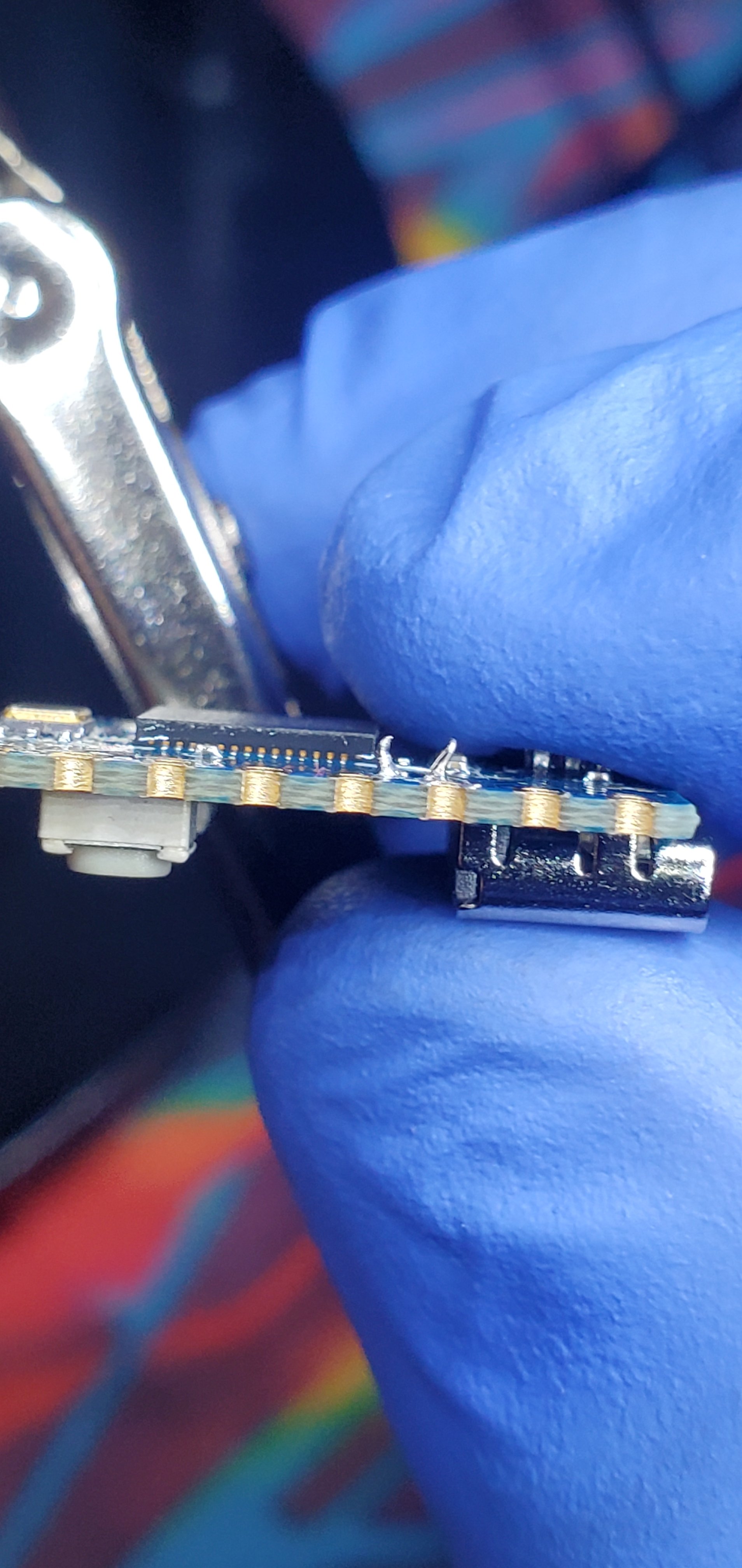

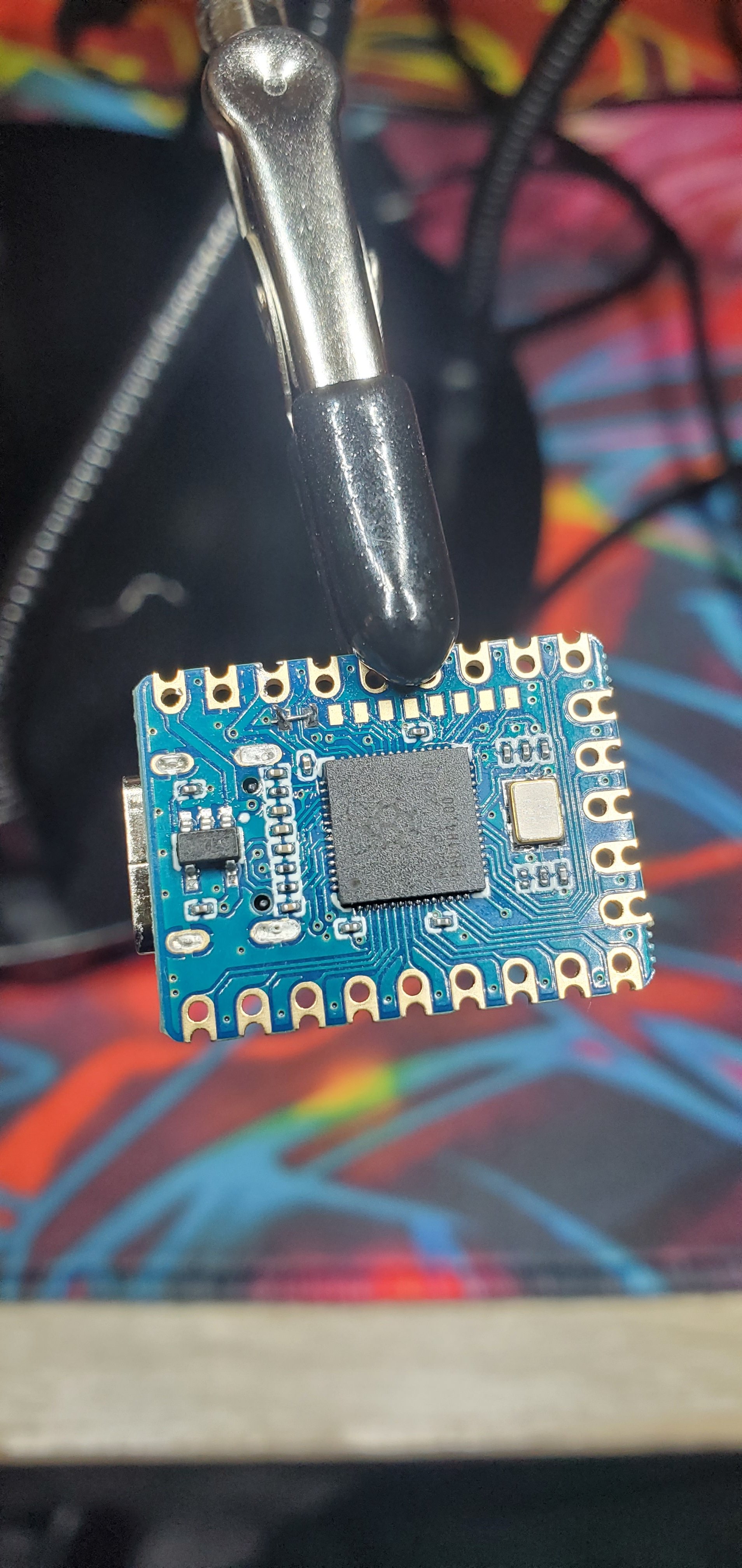

I bridge the rgb jumper on the rp 2040 but when I flash it still green I've reset the wire like 10 times using 30awg tinned copper wire

Set the rgb jumper but it still reading green after the flash using 30 awg tinned copper but idk what im missin?
It's supposed to be green from 2.7 onward or better to say The colors don't matter anymore
Why not read the Guide before attempting this bro..
Was following the og one didn't know the pdf but I got it to flash red any thanks can't ask simple question to get a simple answer thansk again
You are welcome. It was easier for me to write "that light is OK" but if I've given a simple answer you wouldn't know about the latest PDF and maybe somewhere along the run you might make a mistake that bricks your switch and no one here wants to see people mess up otherwise we wouldn't be here.
Stick around long enough and you'll see what i'm talking about.
