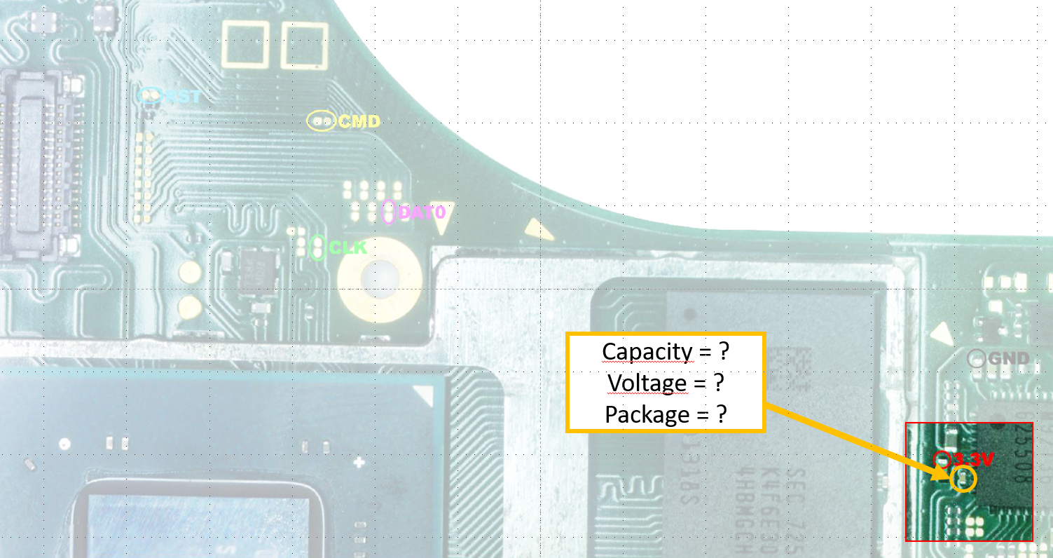

Hi, i destroyed the exact same cap when tried to solder 3.3v wire and the only problem is that without that cap the switch do not charge in fast mode when is plugged in the dock, and if you plug in the dock when the switch is completely turned off the dock enters in an error mode (green light blinking).
Thank you very much. So the Switch is not garbage yet :D Great news!
Unfortunatly I just noticed under a better microscope, that the capacitor next to it is also partially damaged. Have to replace this, I guess.

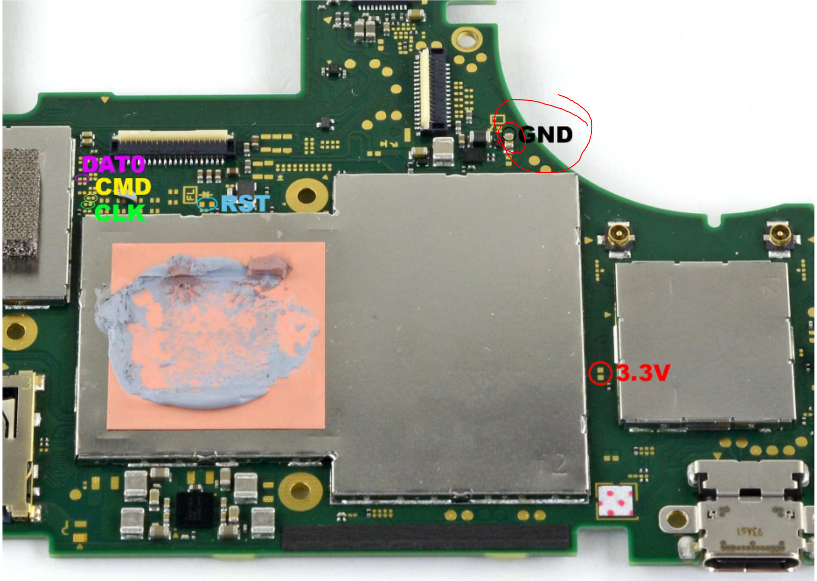

I definitely screwed up the capacitor circled in thin red near the GND label. Anyone know the part # so I can hopefully get a new one?
