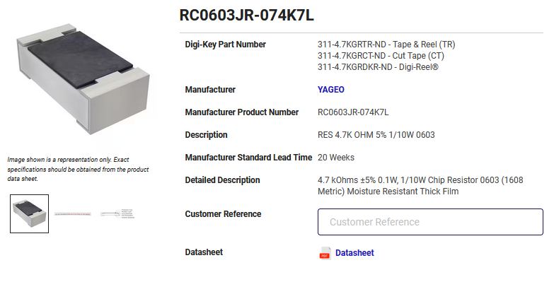

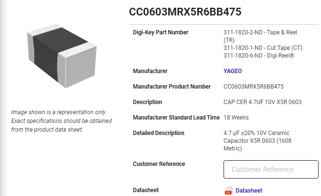

I guess is a 0603 package
Sorry for the questions I'm pretty new to this, based on what you said is this:
The correct resistor I'm looking for?
Thanks!

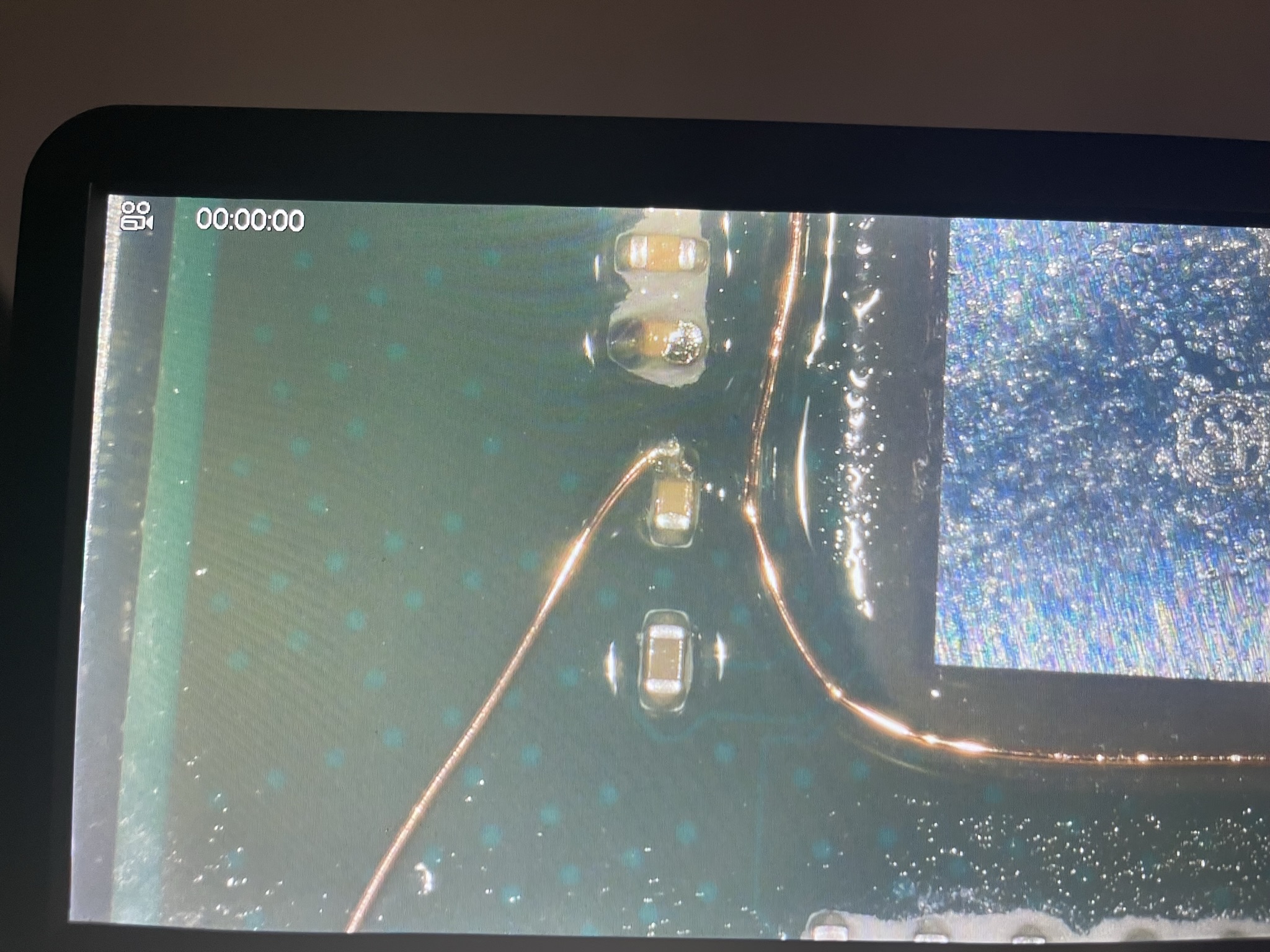

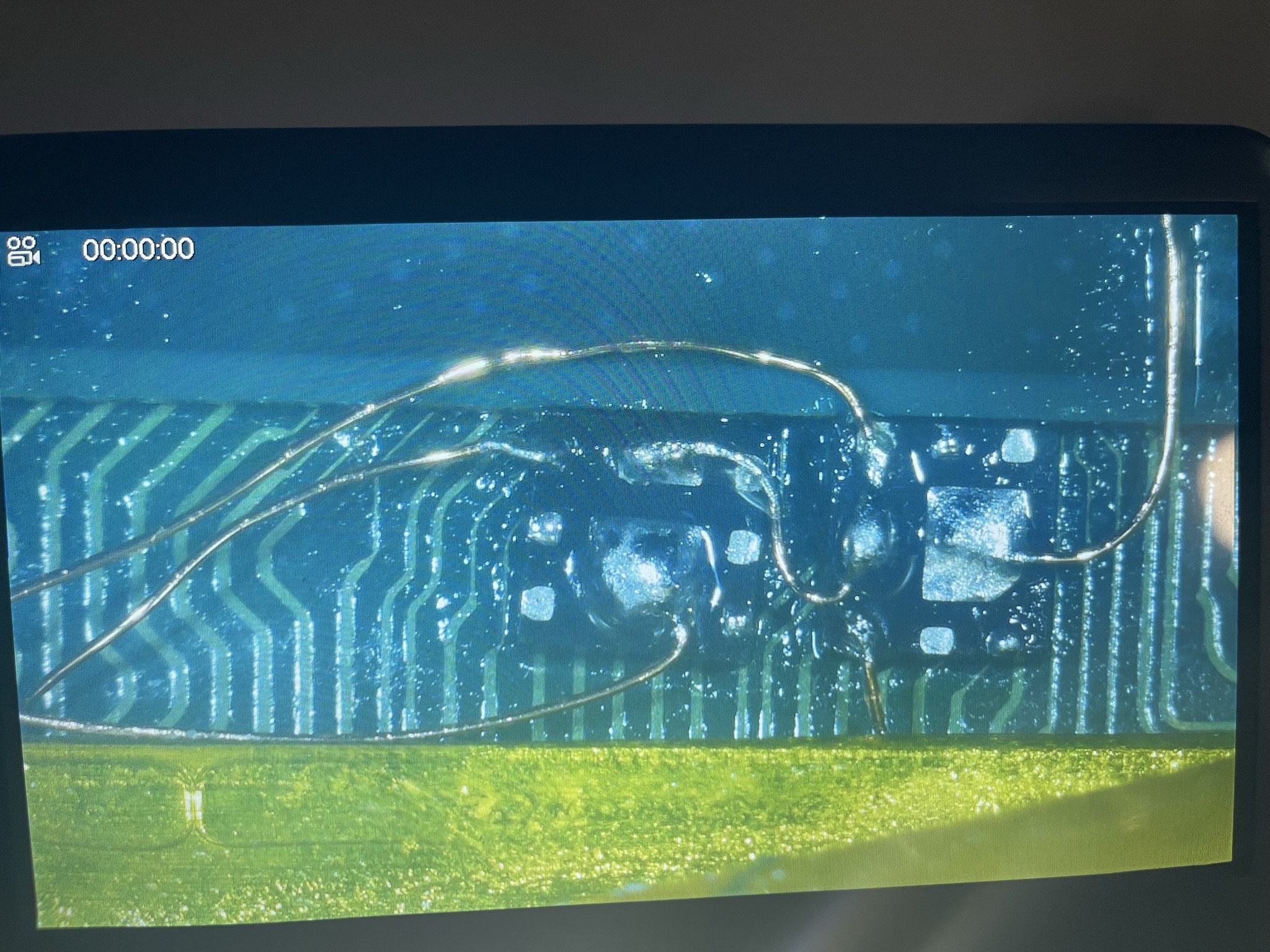

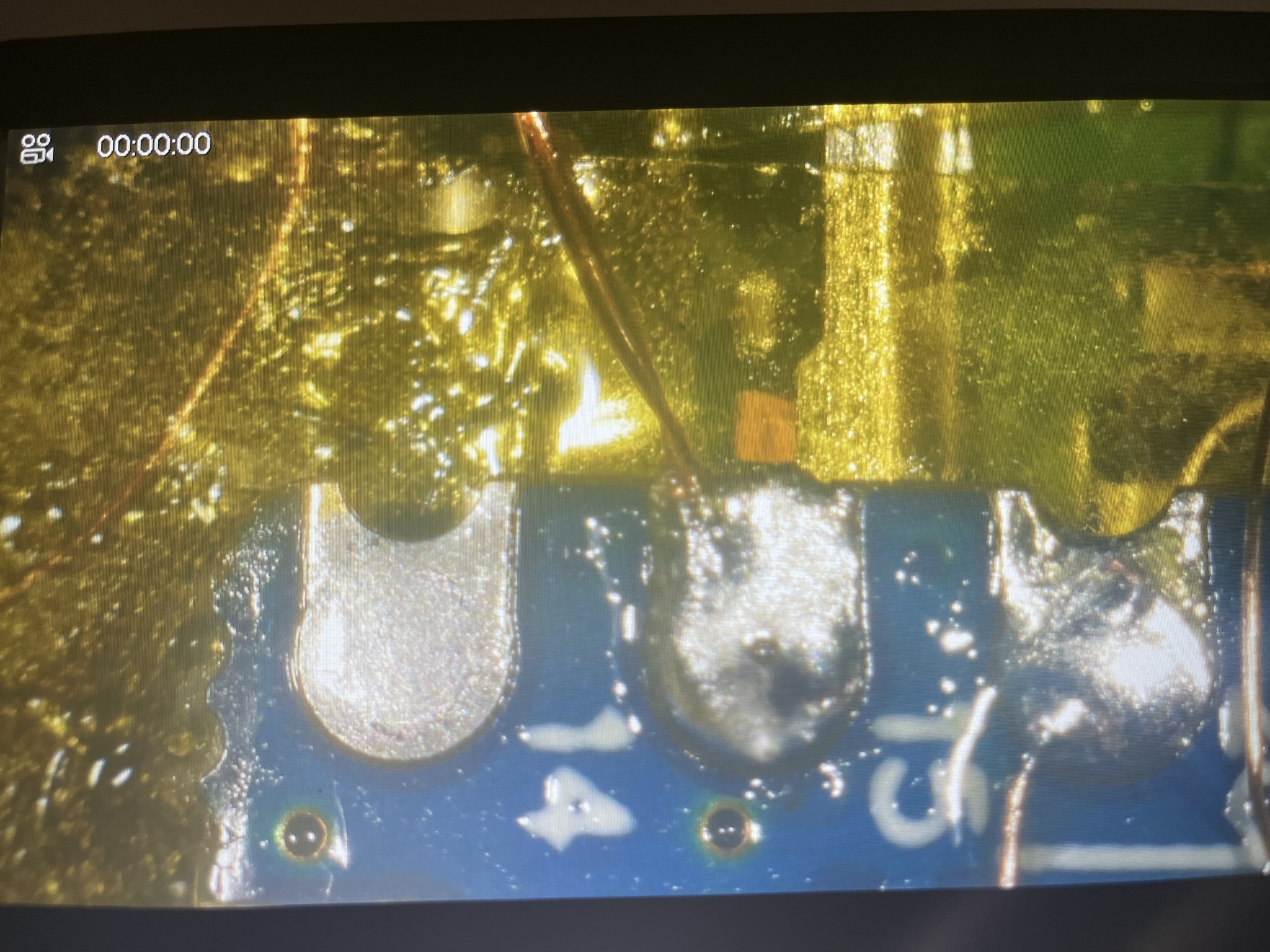

New problem though (this is adifferent switch btw) modchip saying mosfet issue, these are brand new mosfets. i think i did the install properly. But i just dont get why its not working? anything you guys see that i mightve done wrong? thanks!
Can you take another picture here, looks like a lifted pad (although it should work without that cap but you never know).
Also you should bridge the Source terminal because it is all going through single mosfet the way it is.
And, I would suggest a bit thicker wire for this installation.
What size are your wires and I can't see your pull down resistor on the mosfet install!?
That Cap looks toast and is probably why your getting mosfet error, there barely anything for the mosfet wire to adhere too.
There seems to be only one gate wire on your pico board at point 15!? Where is the second one?
The source is bridge, its just at a glaring angle that looks bad haha. Ill fix the other thing though.
0.10m, i dont have a resistor in this install, didnt know one was needed, ive done several instals without one so im curious on what its used for? And the second wire is there, i swear lol look closely and you can see a little bit of it. Ill fix the caps, 1 sec.

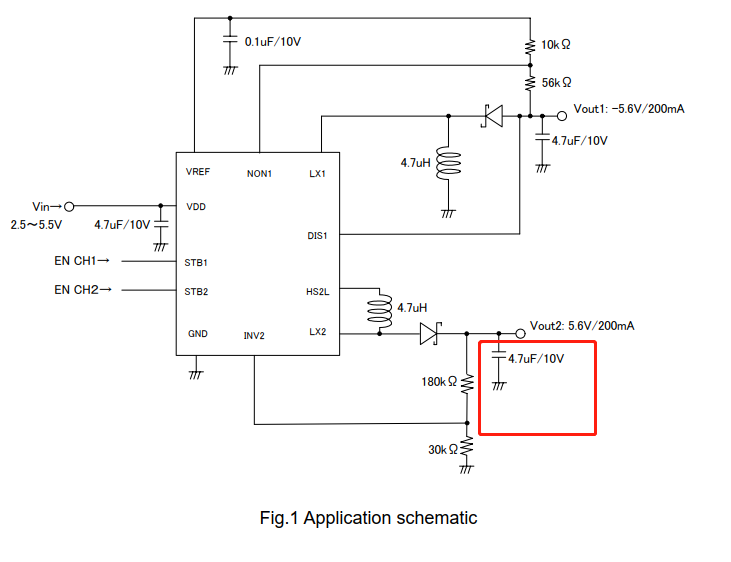

If
Yes, thats the one. Some people used to remove it so it fits a little better but to be honest I don't remember it being recomended to remove it from the functional perspective
I removed the regulator of the rp but the shortcut between gnd and 3.3v persisted so i removed all the rp2040 and now the switch at least works fine in ofw mode, the battery was completely drained and took some time to charge, maybe the shortcut of the rp2040 drained it, i tried to turn on the rp2040 outside the switch but no lights blinked so i think is damaged. I will replace the rp2040 for a new one and change the 3.3v point to the emmc board instead of the cap, and maybe i will use a rp 2040 tiny instead of the zero.
will update if works or not.
