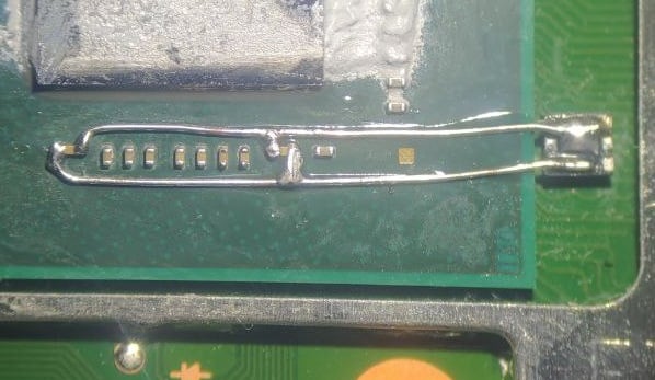

I'm sorry, I was directed to this thread to confirm the pin assignment of a MOSFET, but due to my own ignorance, I am unsure of where to connect the pins. I am feeling frustrated and would appreciate some guidance. I thought it might be easier to connect wires rather than remove the chip capacitor, so I would like to try it in this way. Could someone please explain to me in clear English?

Hi, do you have any tip for soldering the mosfet? I'm finding very difficult to solder with my iron, because those pins are too small. Do I need a heat gun?
Thank you.
Thank you.
I’d suggest either getting a flex from AliE or giving it to someone else with a scope, do not use a heat gun!

Okay, thanks for the info. I'm not thinking about how it will fit, mainly availability.
I'm planning to use 26awg, would I need to go smaller?
I would want to attach wires to the capacitor, then connect the other end to the mosfet. You're saying the wires need to be very short?
I have a switch lite btw
yes smaller, 32/34/36 awg are the most common I believe.
