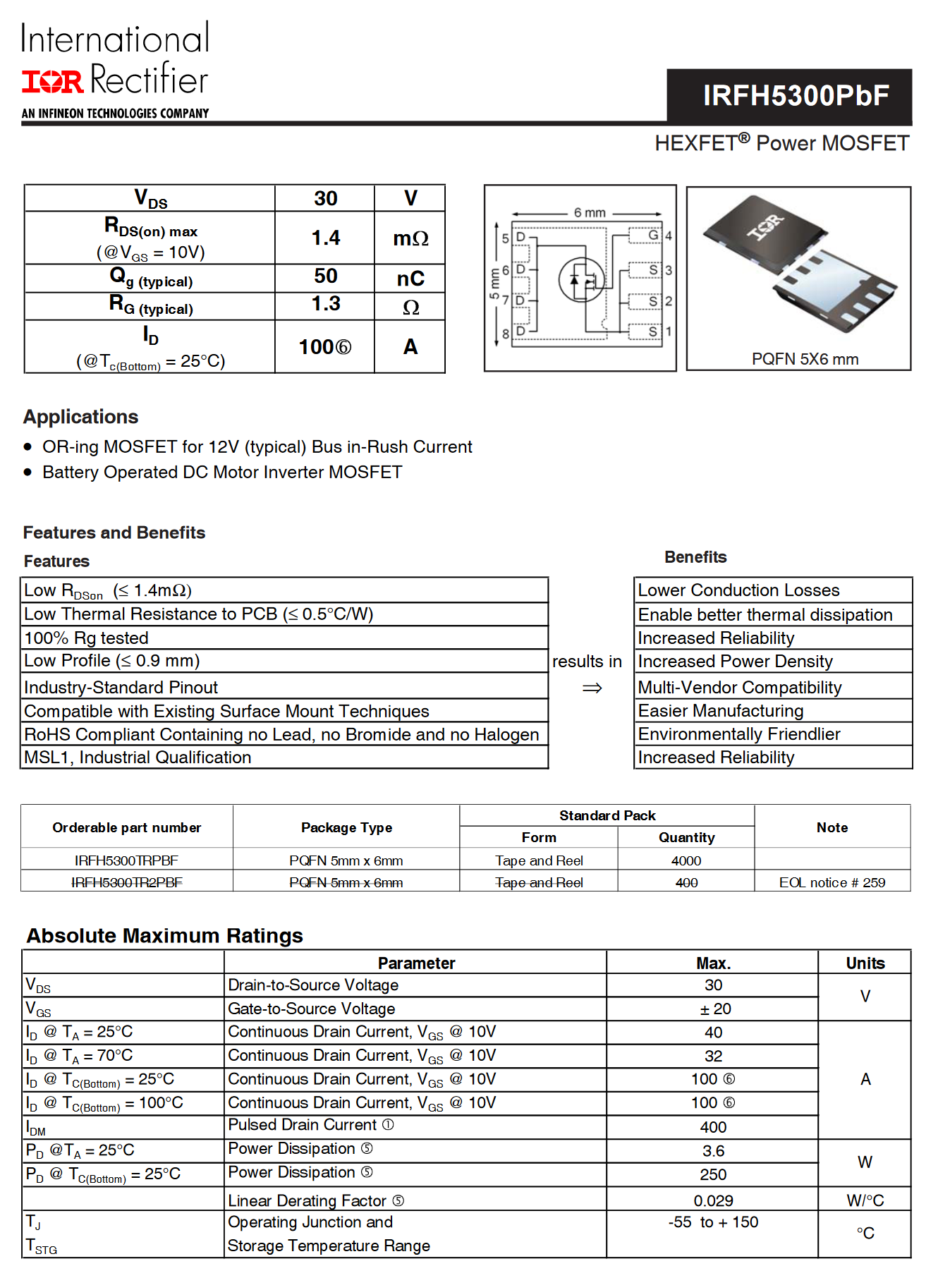

I cant find the exact mosfet in my country.
Will IRFH5300PbF do the trick?
tnx
