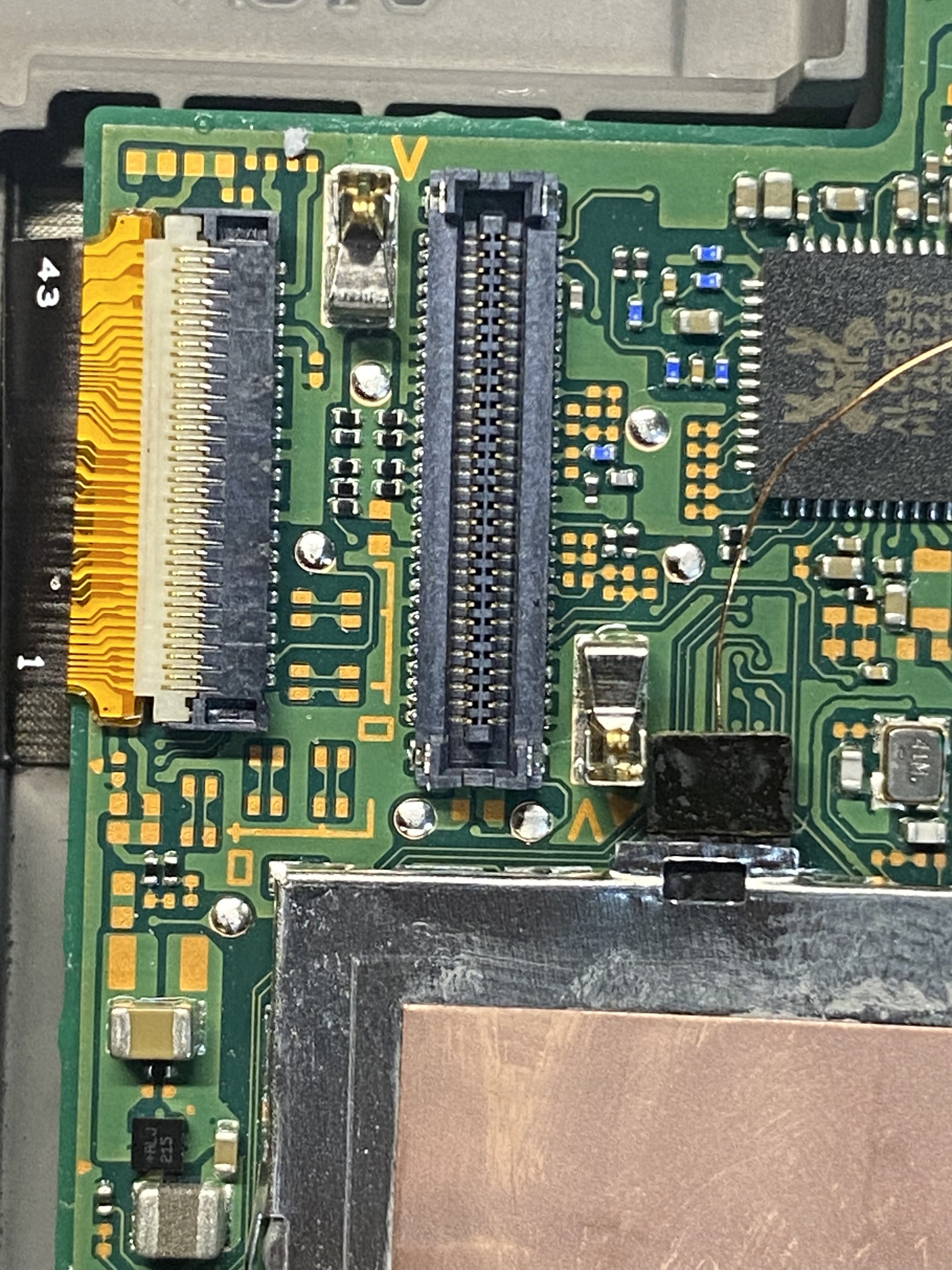

Hi,
I have rather interesting problem with Picofly. I installed it, NO SD screen is pretty fast but it is booting hekate really slow 30-40 seconds and it couldn't init SD Card. I can boot to OFW and it couldn't see SD Card either. I changed SD Card PCB with another no luck. There is no visible damage on SD Card connector and Mainboard connector.
BTW: OLED with SK Hynix EMMC and I tried different known good SD Card.
What can cause this? I can't partition the SD because it can't init.
Regards,
try adding another 47ohm on to Dat0 then if still add it to Cmd also.
Is it for slow EMMC issues?
Not only that, as it for all issue affected by signal interference (bsod, wake from sleep crash, etc..)
It can be also from cable/wire quality or placement or on how you choose 3.3v and ground point.

Also please try to remove dat0 adapter if you use one, and see whether on OFW you can see sdcard now.
I removed DAT0 adapter and everything no sd on OFW. Here is picture of sd card connector.
If it can not access sd card how the hell it can boot hekate. I am loosing it…

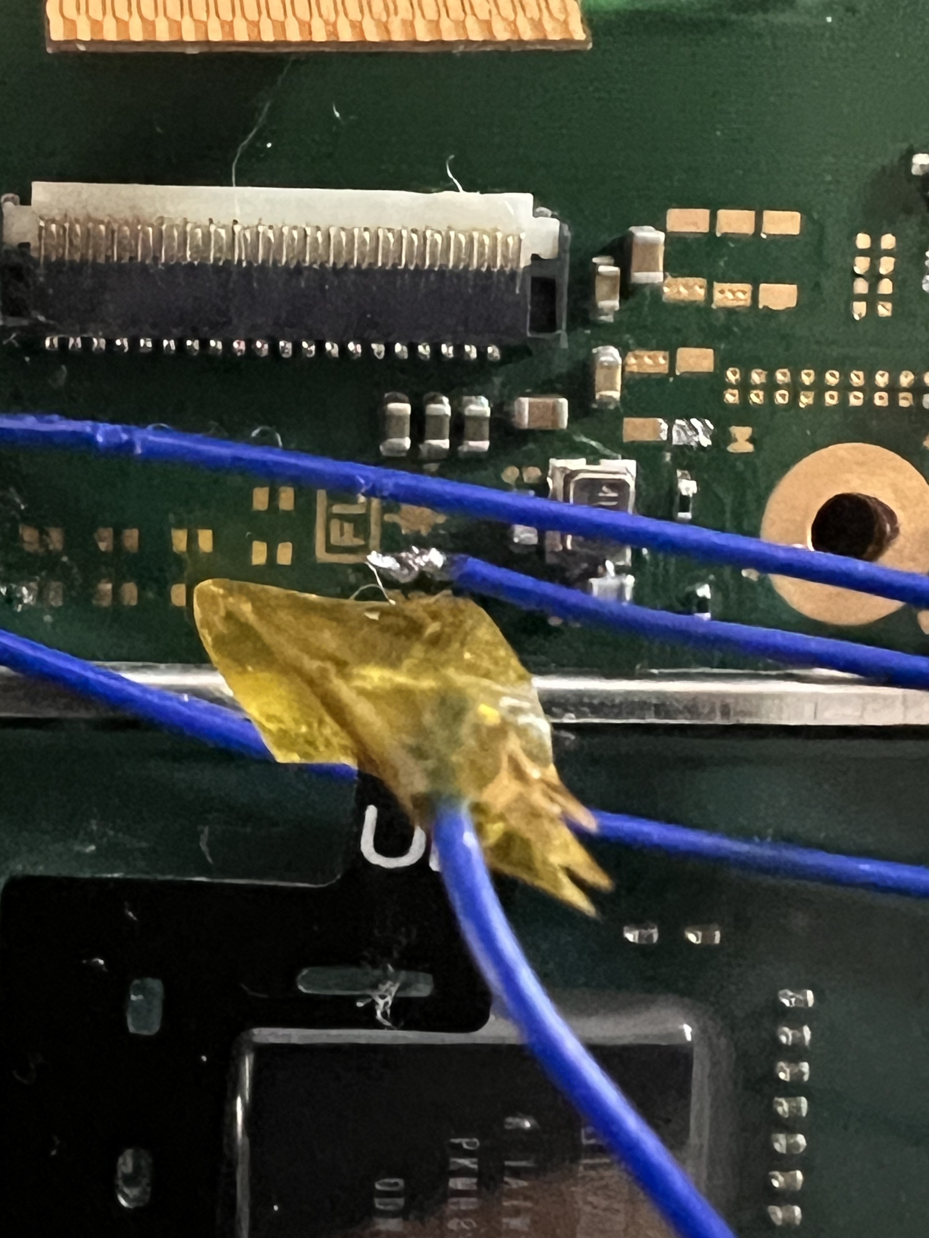

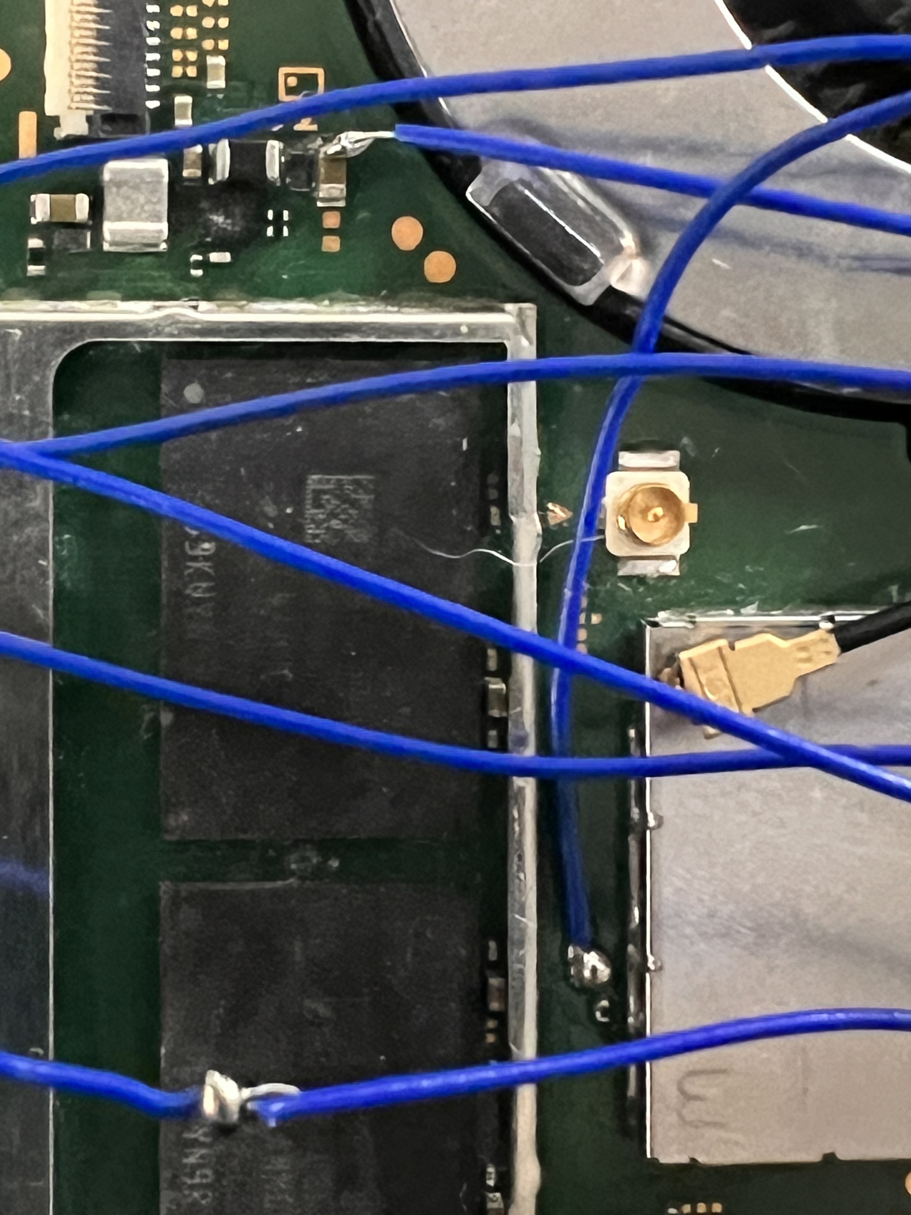

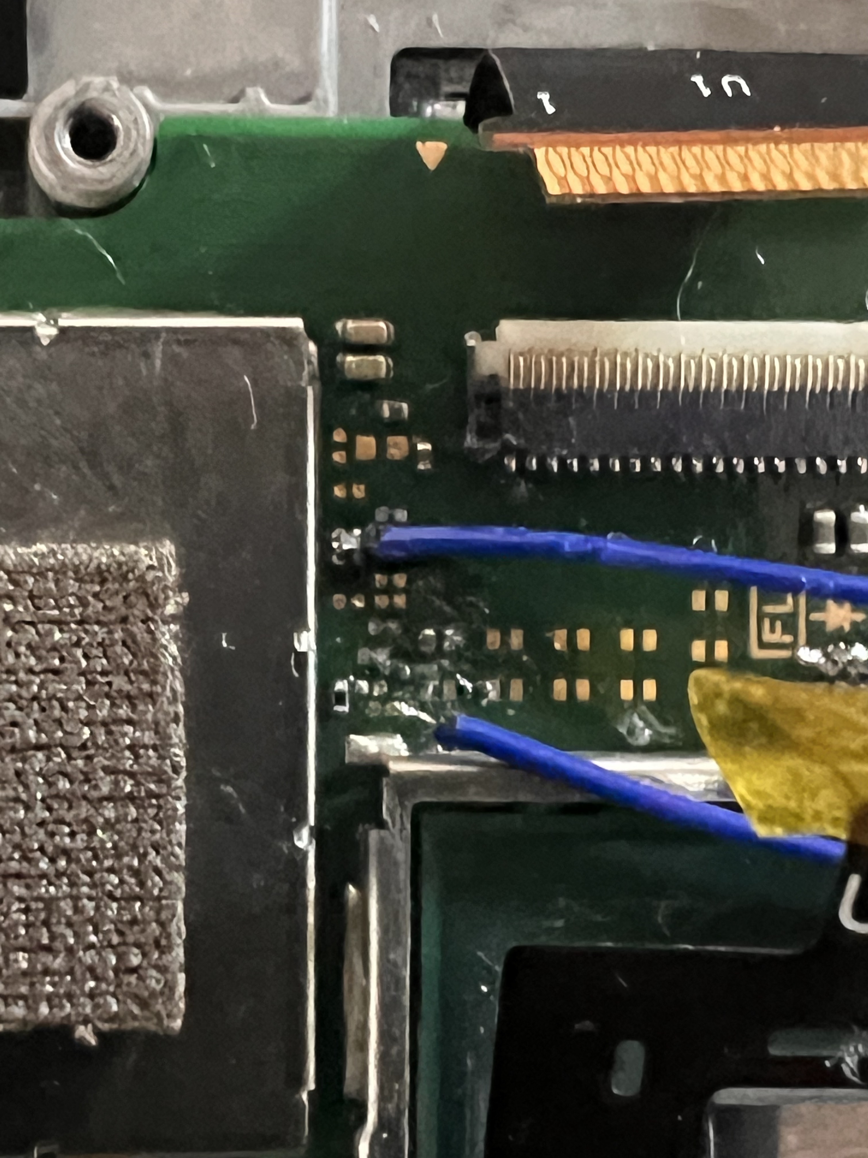

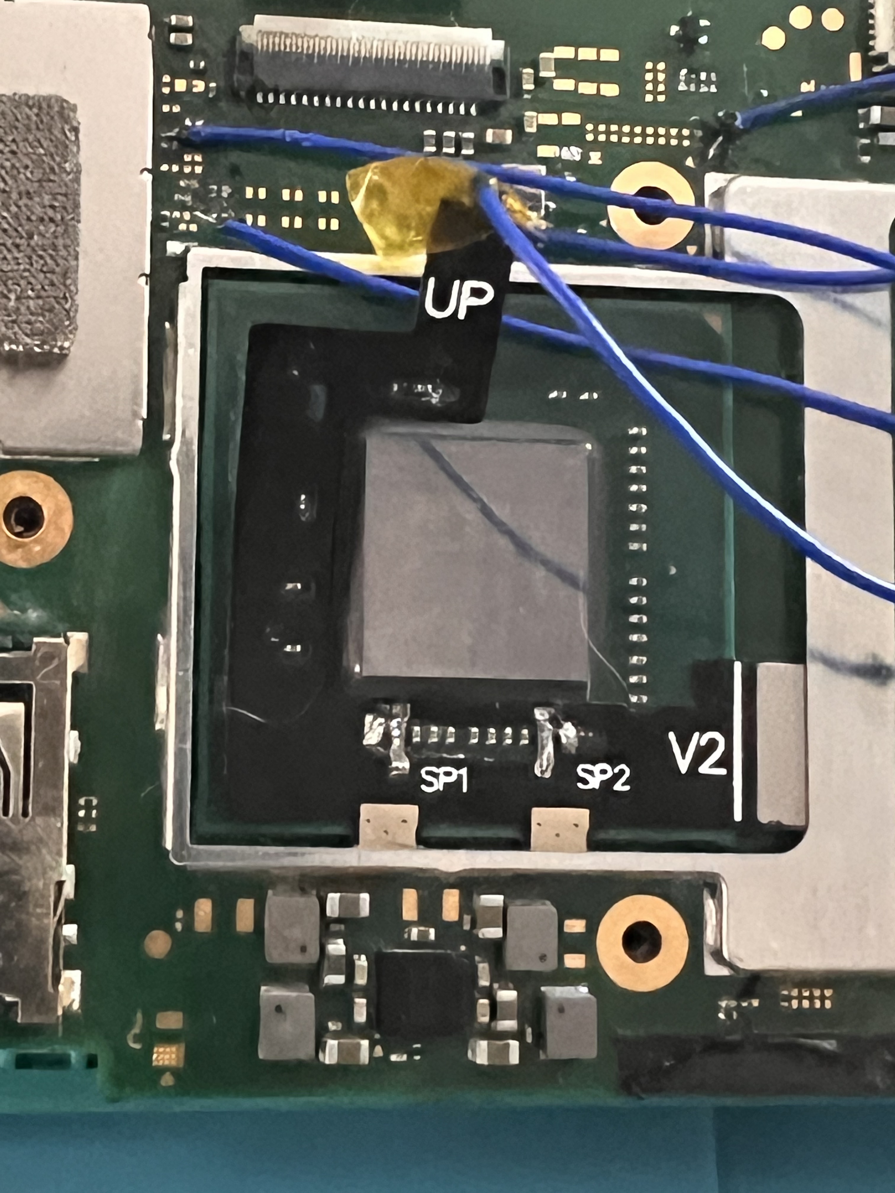

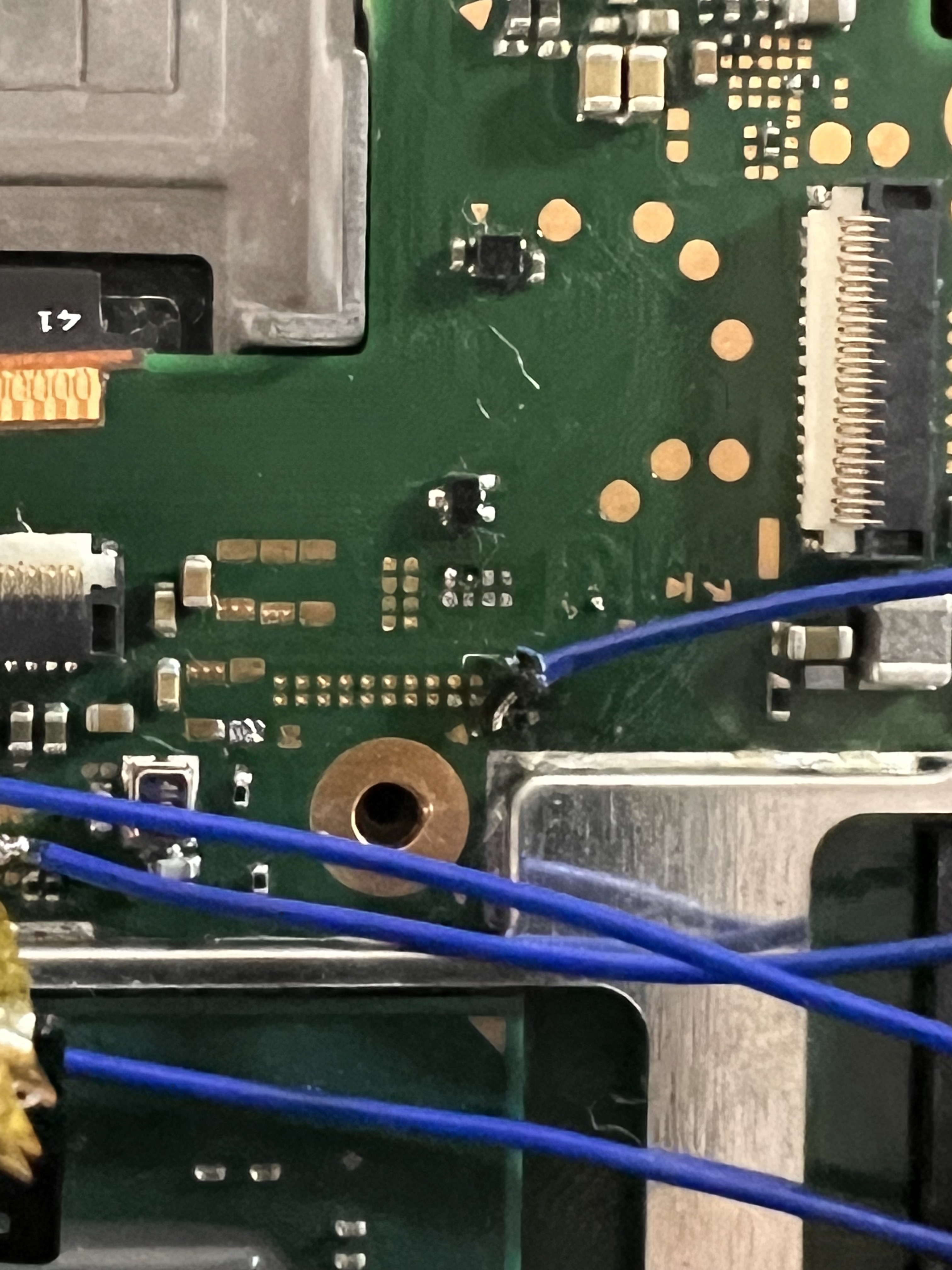

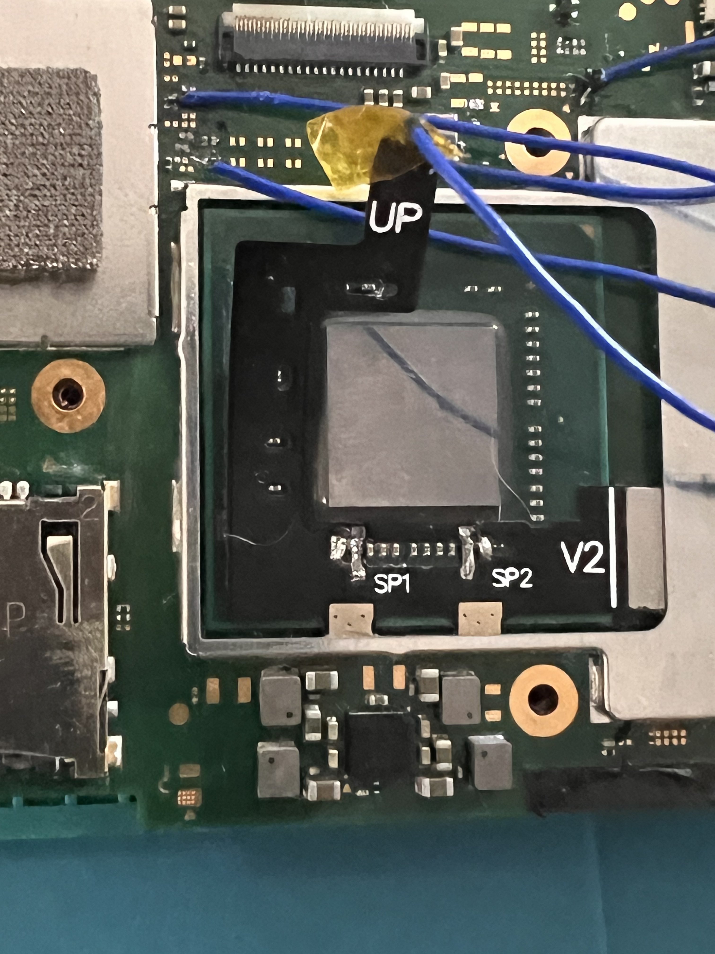

hi all:
theres some updates on my lite with purple screen case:
1. i decided to restart all the picofly installation. i spend A LOT of time doing it, because the very little space between pins (CMD, CLK is a hell to solder), and i used an alterative pin the DAT0 pin. 3.3V, GND and RST are a little bit easier (but tough still).
2. after installation, i turned on the console, and the purple screen changed to the nintendo logo (great news, the cpu/ram are alive), but then black screen.
3. checking the picofly itself, i have 3 yellow leds: 1 short and 2 long, that means:
*== No eMMC CMD1 request (poor wiring, or dead CPU)
4. after that, i unsoldered GND and 3.3V. then test again and purple screen again :(
maybe i should try to redo the installation with shorted wires? or thinner ones? i bought very thin copper wire, but it'll be more diificult to manipulate (i think); apart of that i picofly'ed an erista v1 with the SAME wires that i used on the lite and no problems
please see the attached pictures. the installation is a mess because i'm focused on fix the purple screen issue first. any information or experiences with purple screens can be very helpful!
thanks!
  • IMG_2422.mp4
    4.4 MB
hi all:
thanks!
im sure if you detach the wire on cmd resistor on mainboard it will be still purple screen. those point is dangerous. just by soldering it you can make those resistor not connected to mainboard resulting purple screen.
Please use cmd point near the emmc as ussual.
Only alternate D0 is safe to work on.
For black after nintendo logo please check D0 short with nearby. If not then try to add another resistor on D0 and see what happens.
