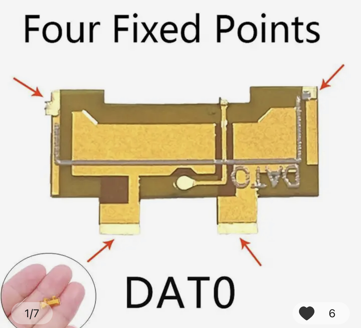

Guys, about to mod my first OLED. Any hints or tips? I’m nervous about the dat0 adapter… also one mosfet works?
Using this one
Using this one
I did a my first OLED today and I felt the same, however it isnt that bad. Have a multimeter in diode mode put positive lead on ground (apu shield or usbc con) and use negative lead to test DAT0 point. should be .5 - .9

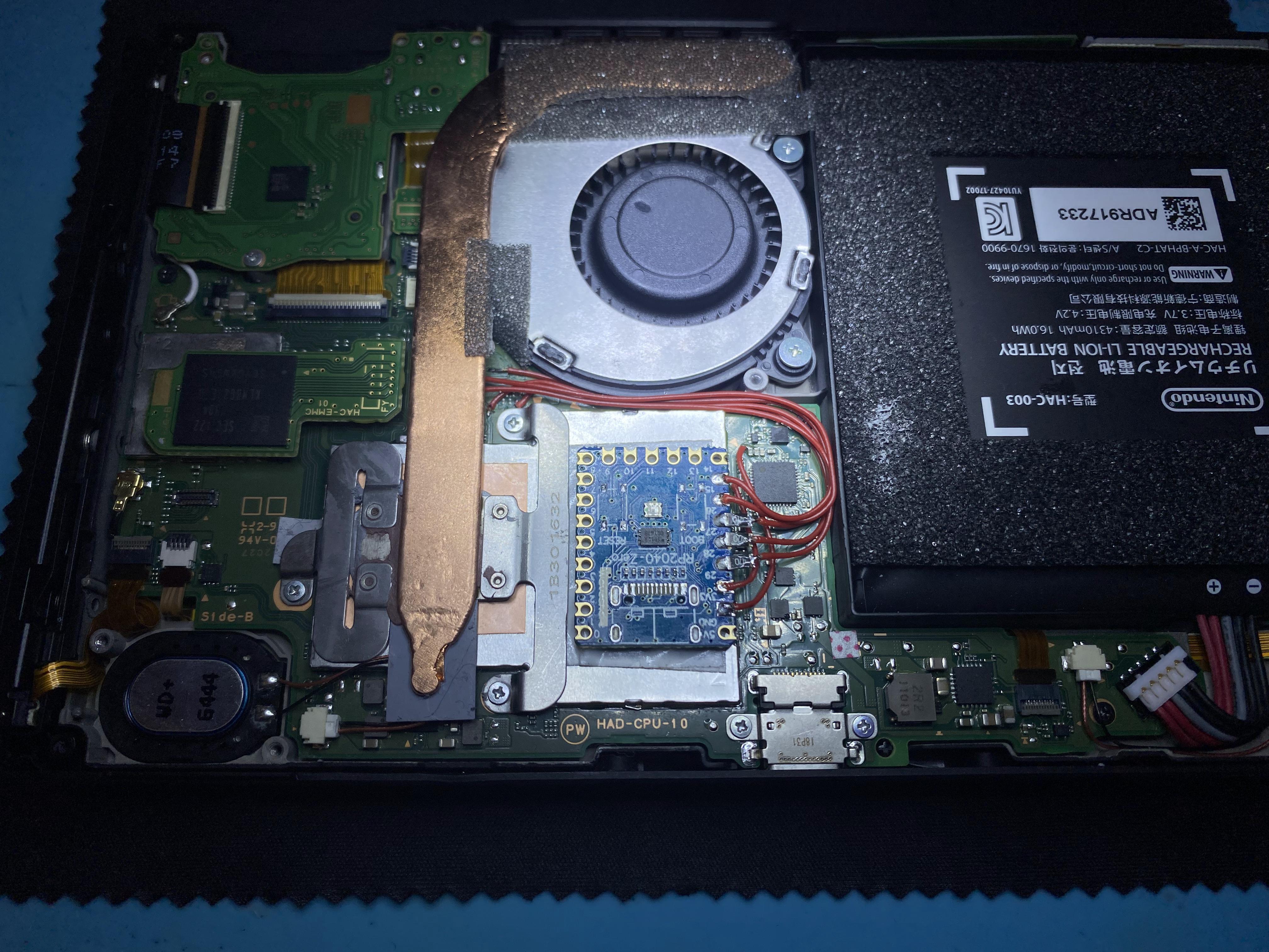

Hi guys!
So ... I tried to install the picofly into a switch lite, and the first time i plugged the battery, i noticed that the CPU is turning really hot. so i unplug it quickly :(
scared of the possibility of having a dead-fried switch, i unsolder 3.3v and gnd (i guess that this disabled the chip), and after that i got PURPLE SCREEN.
as far i've read the thread, it seems that a purple screen is fixable, but do i need the picofly working, right? (to boot hekate and read the eMMC and stuff)

Hi guys!
i installed picofly on a erista v1 and all went fine. maybe the lite is having issues with picofly?
Pictures?

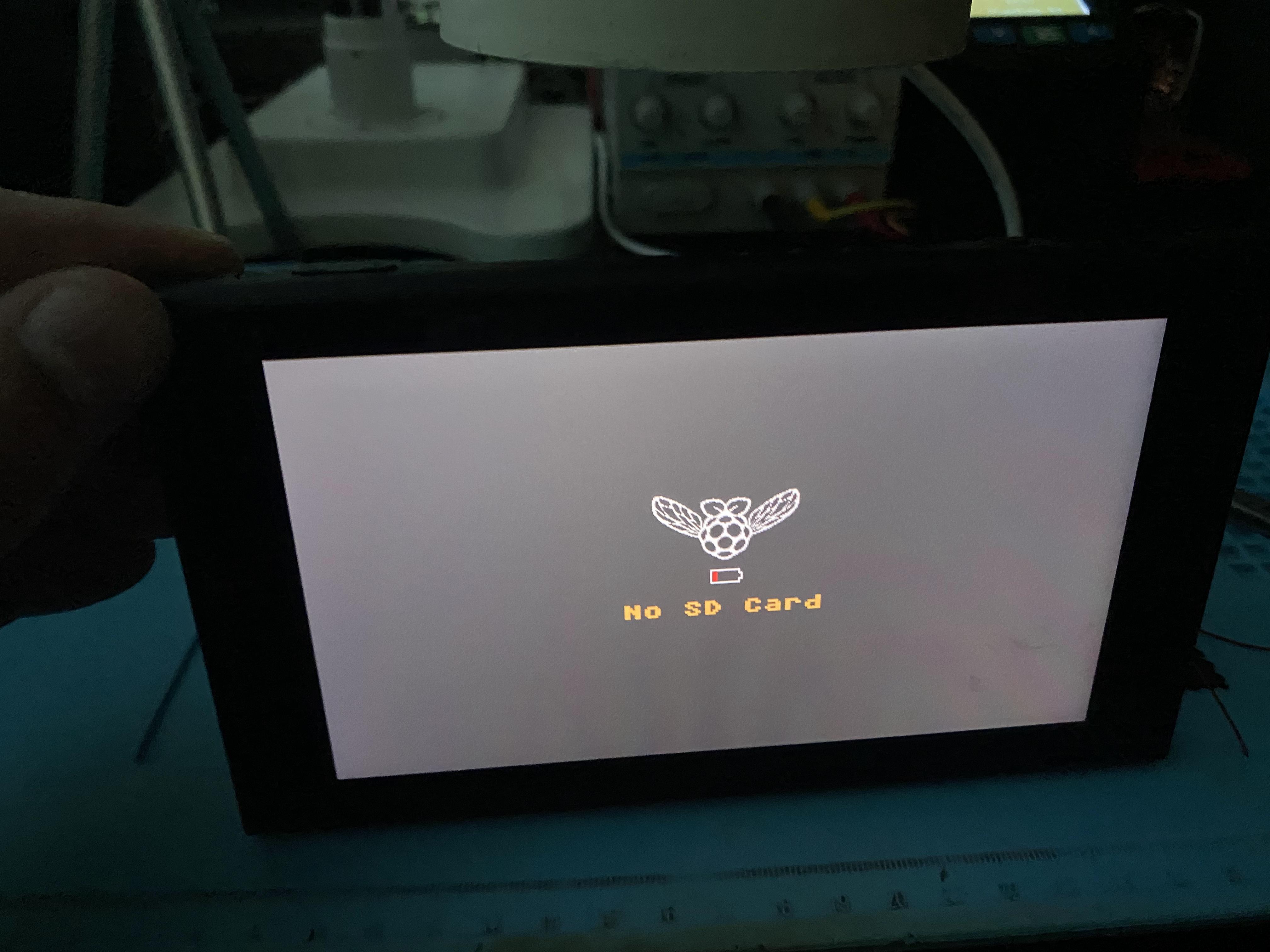

Hi,
I have rather interesting problem with Picofly. I installed it, NO SD screen is pretty fast but it is booting hekate really slow 30-40 seconds and it couldn't init SD Card. I can boot to OFW and it couldn't see SD Card either. I changed SD Card PCB with another no luck. There is no visible damage on SD Card connector and Mainboard connector.
BTW: OLED with SK Hynix EMMC and I tried different known good SD Card.
What can cause this? I can't partition the SD because it can't init.
