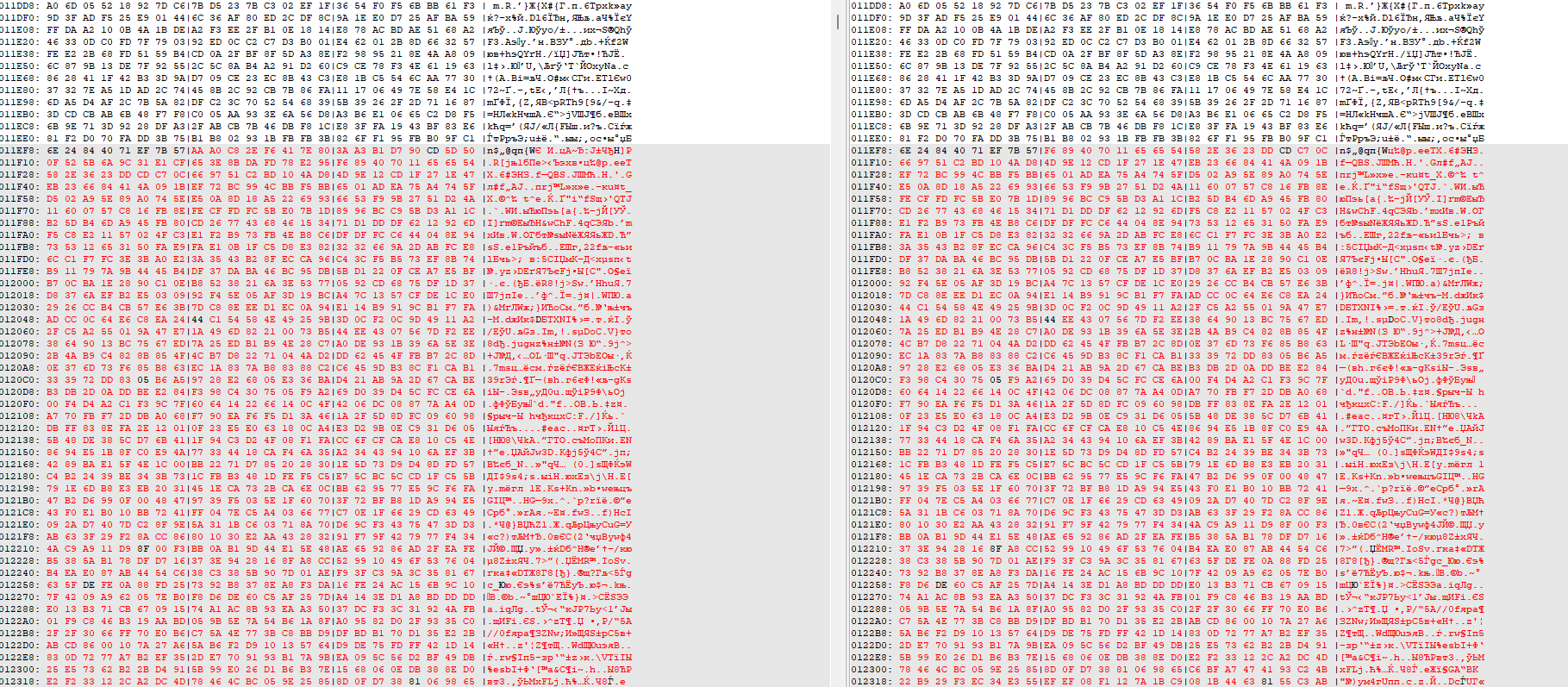

RP2040 have a Winbond W25Q16 series
SPI ID EF4015 (EF40150000000000:9F:SFDP)
SPI Registers reading...OK
SPI Info Winbond W25Q16JV, size 2 MiB, 3.30V, clocks 25/50/50/50 MHz (SFDP)
Manufacturer Winbond
Model name W25Q16JV
Voltage 3.30V
CMD clocks 25/50/50/50 MHz (Slow/Fast/Dual/Quad)
SPI Status Register #1 0x00
SPI Status Register #2 0x02 (QE)
SPI Status Register #3 0x60 (DRV0 DRV1)
SPI UID E6611CB71F7B8129
SPI Security Registers 768 Bytes
Page size 0x100 (256)
Sector size 0x1000 (4 KiB)
Chip size 0x200000 (2 MiB)
im write ubuntu firmware and dump windbond...
first 11EE0 compared by 1 in 1.
And next code have differents...
left - dump, right - bin file
Hmmm.... maybe work)
I write picofly firmware and only included rp2040 and have signs of a glitch
Model name W25Q16JV
Voltage 3.30V
Im write dump from picofly and turn rp2040 only and have indications for glitch
