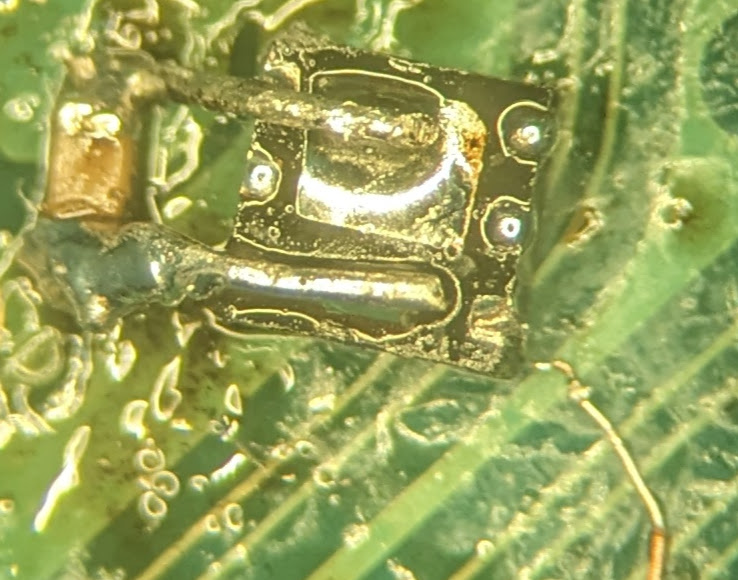

I tried the polarity switch thing with the current mosfet and it didn't respond, so I'm going to swap them out. Three down, seven to go!
EDIT: Replaced the mosfet -- no change. Replaced the source wire -- no change. If I've somehow damaged or shorted the capacitor, would that give the same result, or would that prevent booting entirely? Do I need to just drown the links between the mosfet and the cap with solder, or would this 30awg suffice?
Thanks again.
Edit 2: Would running lines from SDA and SDL potentially help?

If you change the mosfet, but still same, then the problem might lay on other thing. That gate cable try to change it with plastic insulated cable, just for concept only. Maybe when picofly send the 3.3v to switch the mosfet, it is not delivered correctly.
And make sure its connected to the right pin in the picofly board. Sometimes we make a silly mistakes. Human could get tired.

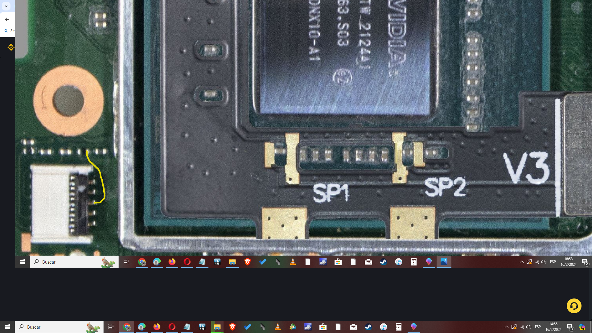

Answered my own question. Was able to just use sp1 with a single mosfet. 😁

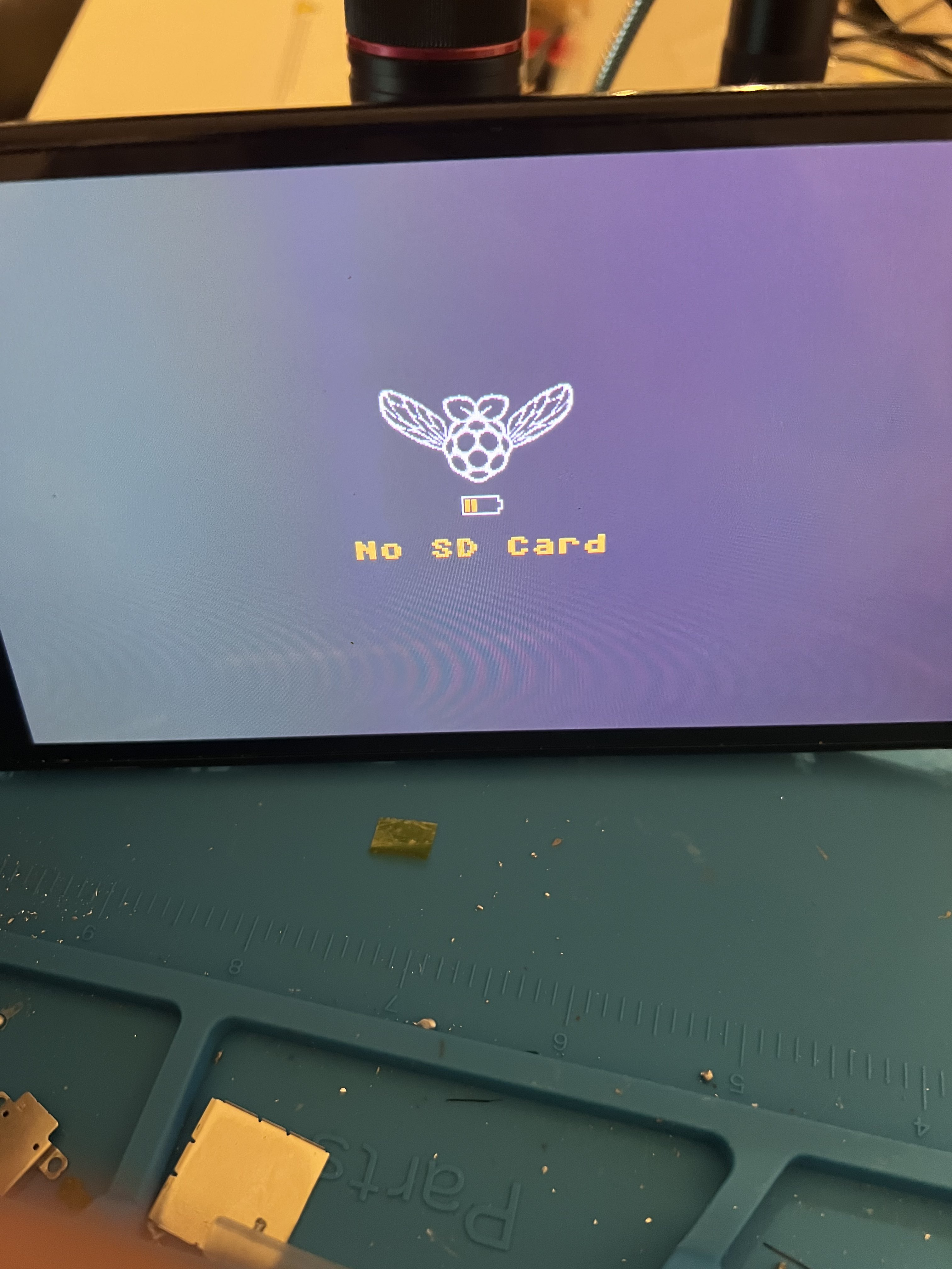

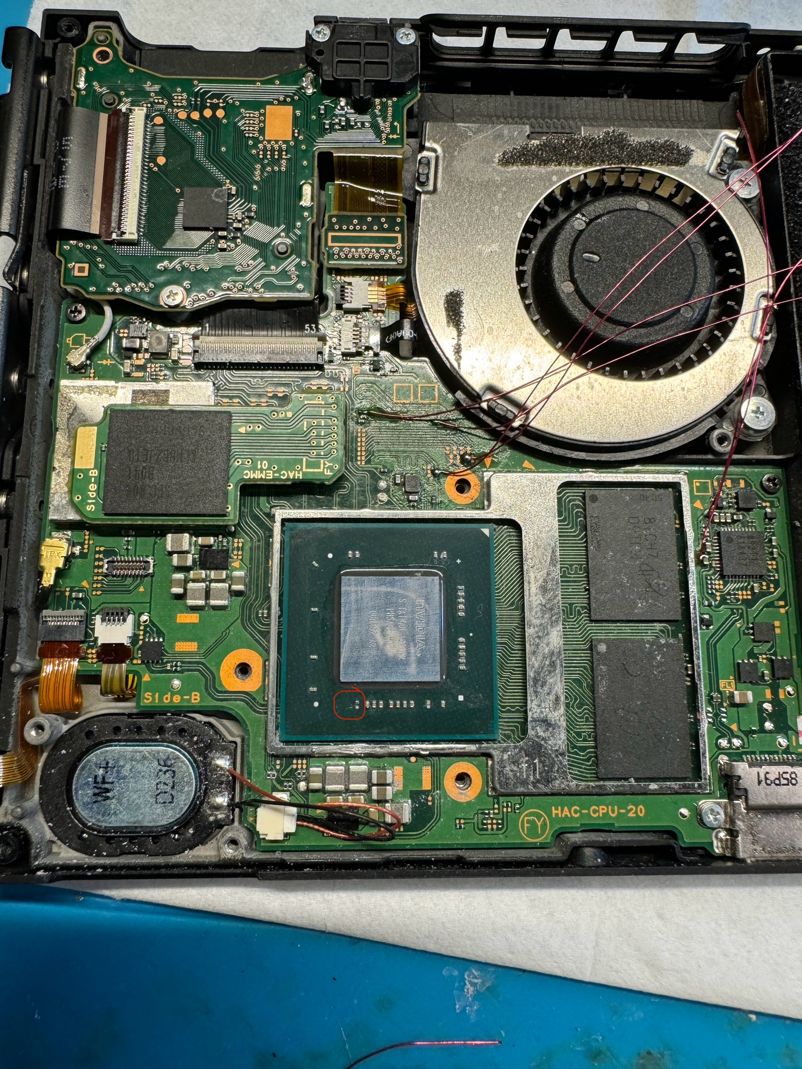

Anyone experienced this before? Whenever i boot to OFW/CFW/turn off console while in hekate i get this line for 0.01 seconds. What is the cause? I dont get this in OFW/CFW while screen is black (turned on,like loading game). Pins in the display connector looks great,and the cable also?

Thanks for the ideas. Would a bad connection to the mosfet also trigger ==* ==* ==*? Is it a general "check the mosfet connection", or something else? Is there an order that the boot code goes in, so I can rule out other connection errors?
Swapping the gate wire with a thicker enameled wire didn't change the result, so I'm running out of obvious things to troubleshoot.
Would adding the SDA and SDL wires help bypass this?
I'll get a picture later, but I'm using the 40awg magnet wire for the other connections between the pico and the motherboard. I'm using the SEEED board with the detection pins bridged with solder, following the 6.4 PDF guide from here.

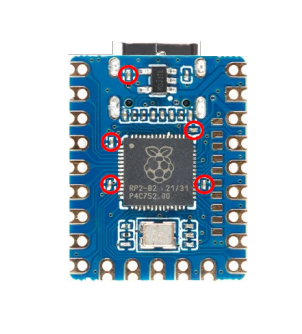

Picofly firmware send the signal through the gate to the mosfet, and the mosfet bridge the DS, then the firmware will read the byte stream on the CMD line. With that error means the bytes read from the CMD line is normal as if no mosfet in there 'stealing' the power goes to the cpu.
So from here, the probability of the causal, as far as i could list:
1. The mosfet broken.
2. The gate line is problematic.
3. The D or S line which connected to the CPU power (via the capacitor) is problematic.
4. Somehow the CMD line is unstable. Theres check on CMD line voltage, in the beginning. And its passed (OK). Theres also reading CMD line bytes when first upload the loader to the emmc through Dat0 (white led), it also passed. So the probability that this is the cause of the error is low.
5. The picofly (rp2040) problematic cant send the gate signal.
6. The connection from the cap to the cpu are problematic. This also low probability, except you drill something around that place which cut something off. If its really is, then you need to use the cpu caps.
7. Somehow that cpu's batch has different glitch behaviour than others.
The sda and scl as long as i know is unstable. And i don't know whether the last firmware are well tested using sda and scl. I remember in previous time, we could simply click the reset button on the rp2040 when the black screen before (or after) the nintendo logo, and it glitched. That leads to the sda scl method, the glitch are done on low voltage.

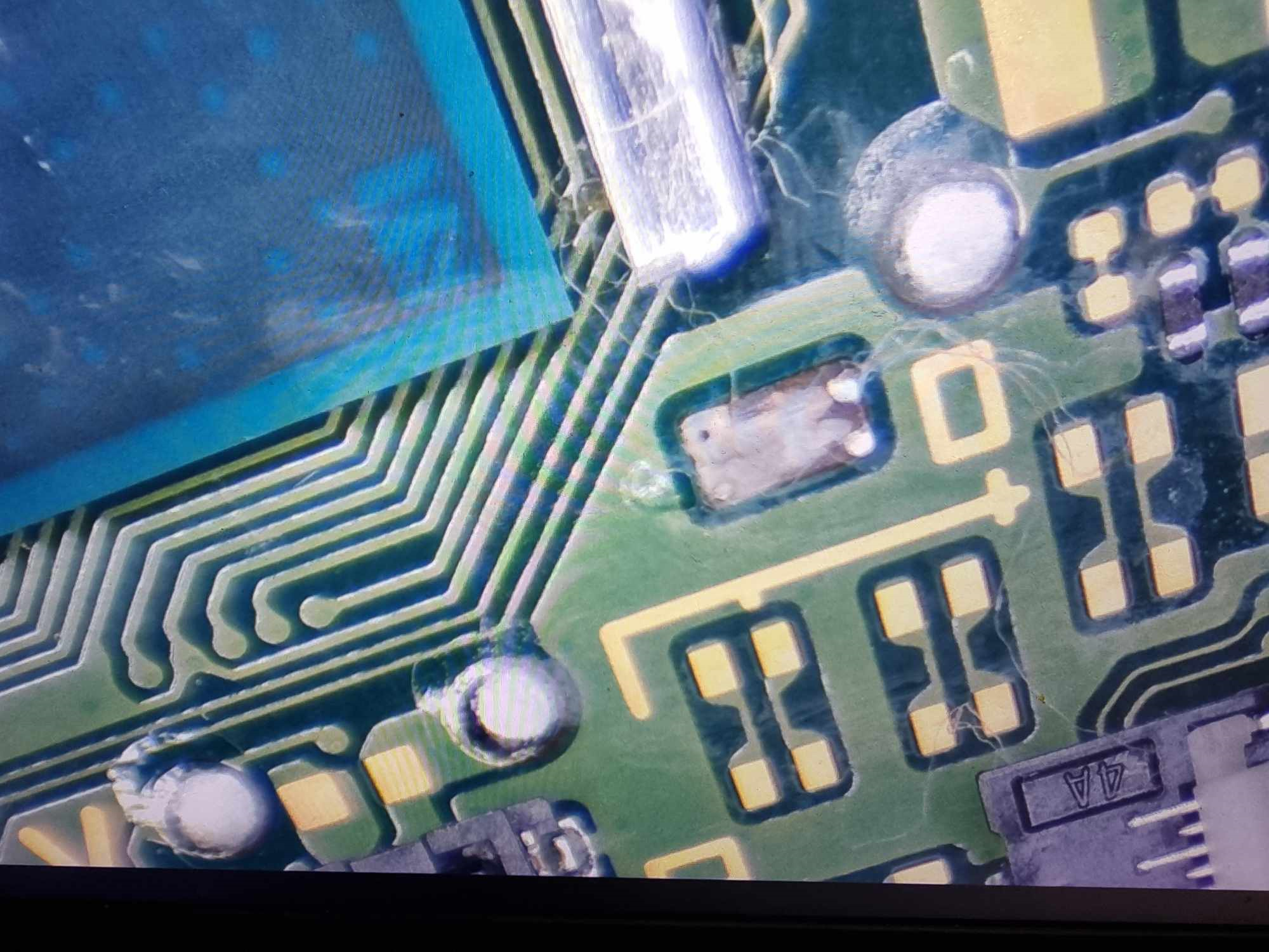

From your list, I believe I might have messed something up with the capacitor. When I was trying to get more solder on to fix the first cold joint, I accidentally covered the cap in solder + flux. I used my wick to clean it up, but perhaps there's some still solder stuck underneath that is bridging the cap.
Are these caps easy to take off?
If not, I'll switch to the front side and move on.

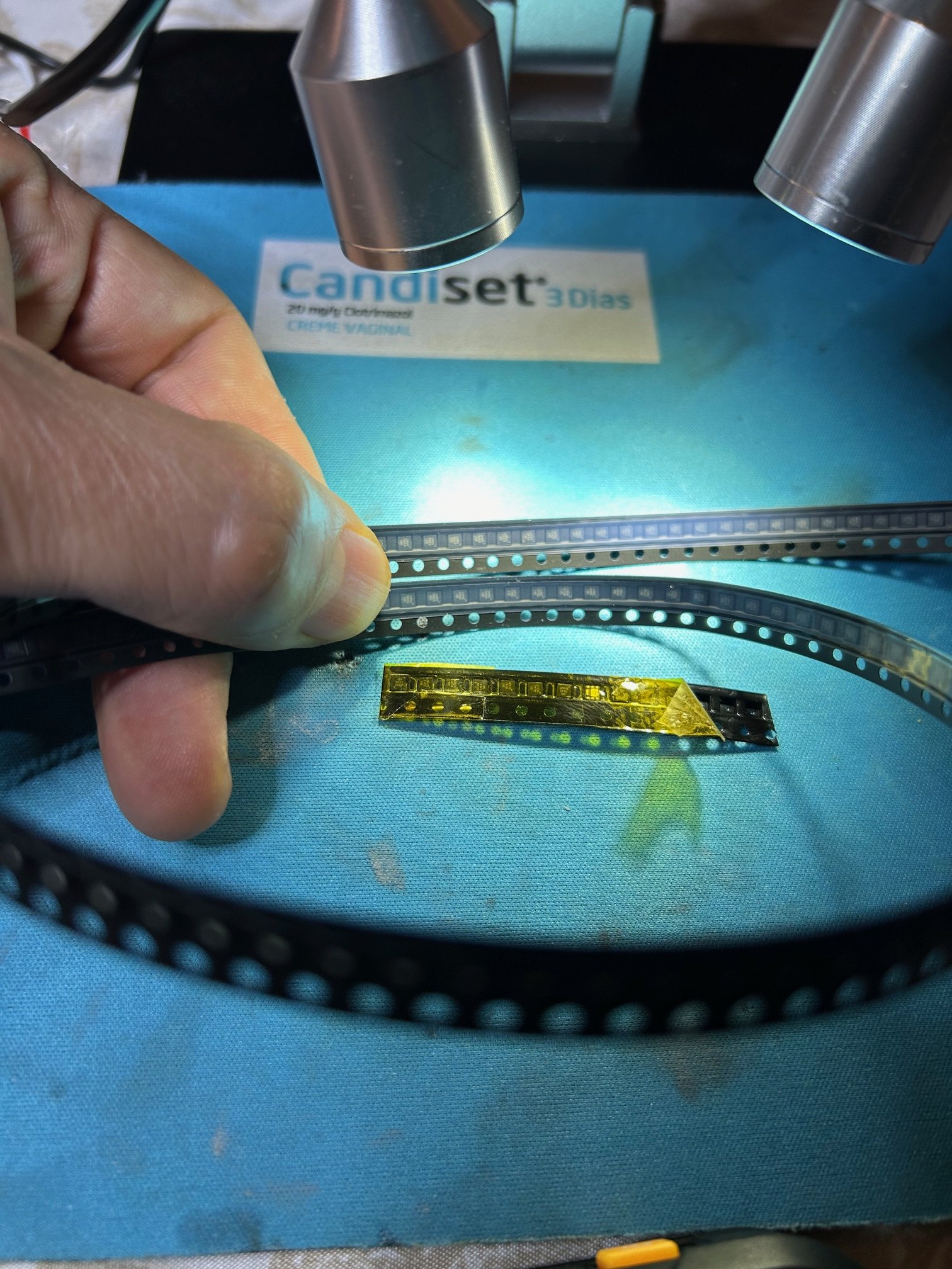

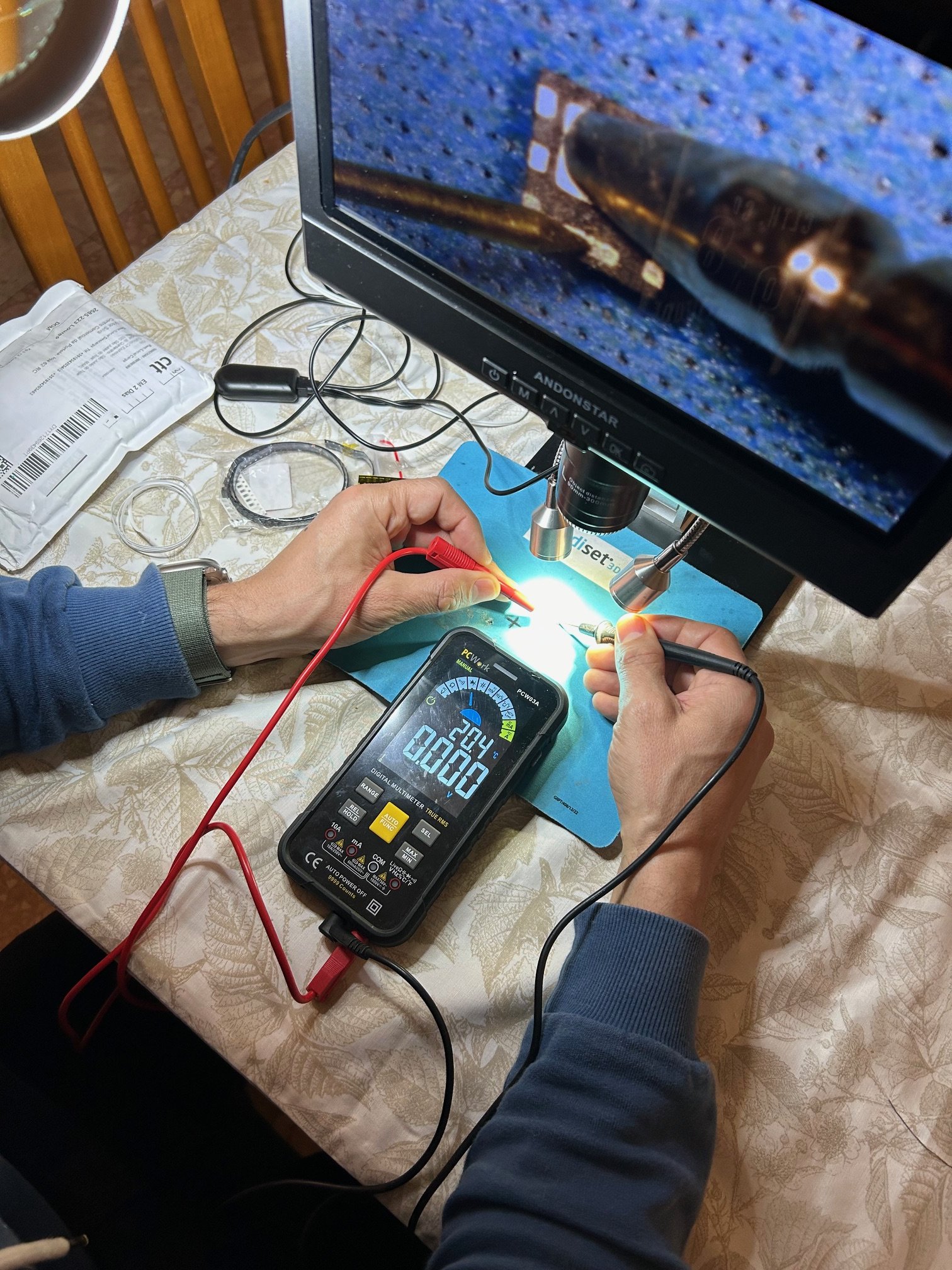

Well, I decided to take a new MOSFET out of the packaging and leave it in open mode so you can understand what I'm saying. Notice how in this image the Source is open to the Drain:
If I install the mosfet in this state, it won't work. The internal diode is open and allows the passage of electrical current between the Source and Gate point. If you do, Picofly will give the error long long short yellow light (==*)
But it is possible to close the internal diode again, passing residual energy (just use the multimeter in diode mode) by placing the red (positive) tip on Gate and the black tip on the Drain. And the result is:
:toot: :D:hrth: Now Mosfet is ready to be installed again .

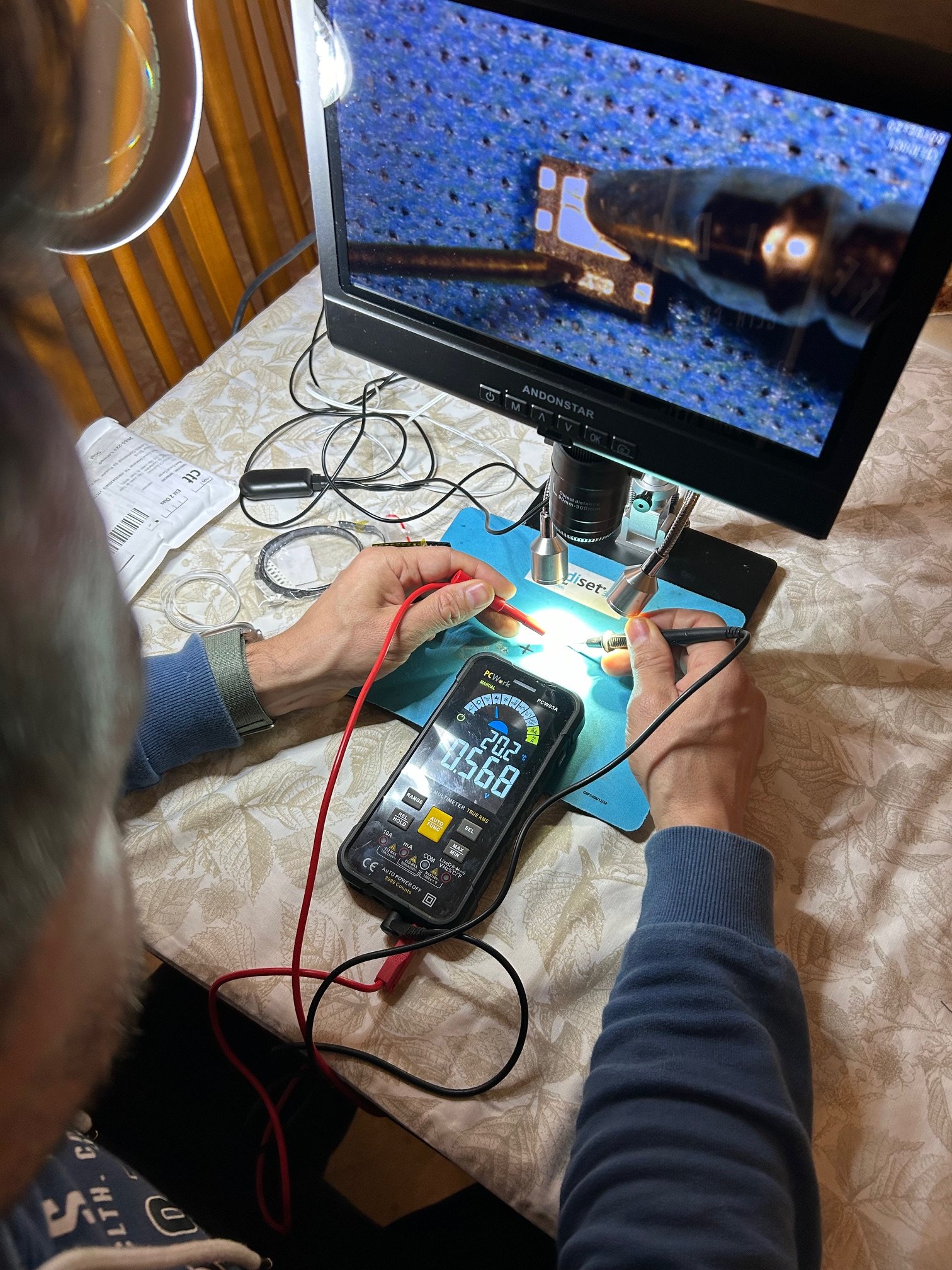

I made a short video on how to close the Mosfet again. Maybe it will be easier to understand if you watch the video. These MOSFETs have proven to be very resilient. In all my installations I only damaged a diode once and it was my fault because I insulated it poorly and it touched the metal protection of the CPU (it even smoked).
Measure the continuity on your mosfet and tell me if you have the Source open for the Drain. If so, you discovered your problem.

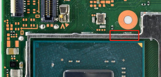

There are many situations where people have damaged the cpu capacitors (SP1 & SP2) and the installation still worked. However, work worthy of a professional requires replacing the damaged capacitor. You can find an identical capacitor on the bottom of the RP2040 Zero:
Difficult to answer.
Generally its not easy.
That is the whole reason why i said the back mosfet is safe compare to the front cap. Because its not easy to take it off (or broke the pad), since its big. If its small cap, just put lot of solder until it cover the whole body, it will easily take off (and the caps pad are easily broken).
