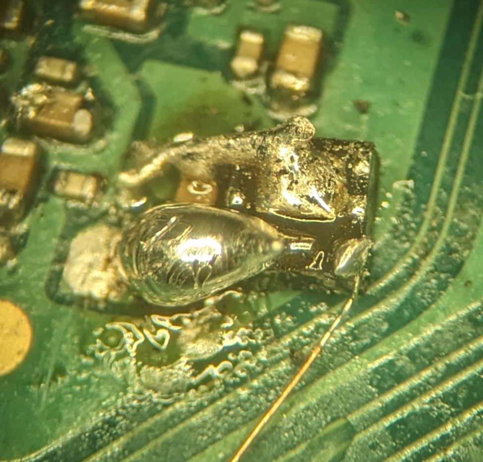

Thanks again for the advice. I tinned up some 30 awg wire and used that as a wick for the solder to follow. Got big ol globs of solder now, and still getting ==*.
One thing I noticed was the little component (capacitor?) sometimes reads as having resistance and continuity. Could I potentially have shorted this cap? If so, would the switch still boot?
Thanks again!
Edit: FWIW the "continuity" shows a ~20 ohm resistance that slowly starts to drop, so afaik that may just be the capacitor doing capacitor things. Just touching probe tips is ~0.1 ohm.

Man, that connection is very ugly. But i guess it´s not working because some times Source and Gate on mosfet are open to ground. It happened to me with some mosfets too. You need to check continuity in source and gate to groud (Drain) with your multimeter. If it is, you need to close it (red probe in source, black probe in drain). After that, Mosfet will work without problem. Why dont you installed the Mosfet directly on CPU without the need to go to under layer of the motherboard?
It certainly is very ugly! I will own that!
Thanks again!
The picture already okay. I suspect the mosfet is bad. Try to change with other mosfet.

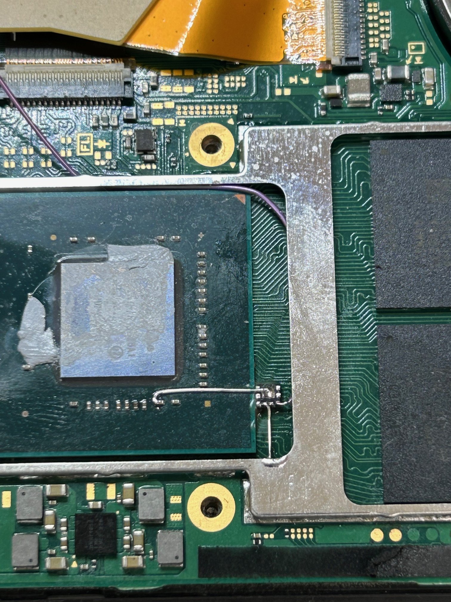

Never doing this method again. First time it happens and i alsmout shit myself. In the future ill just stop beeing lazzy and put low solder on it and heat it with the iron till it comes loose.
How bad is it? I can see second layer . I ve looked at scans and there doesnt seem to be anything there except ground layer
Nothing there unless you ripped through 3rd layer.
