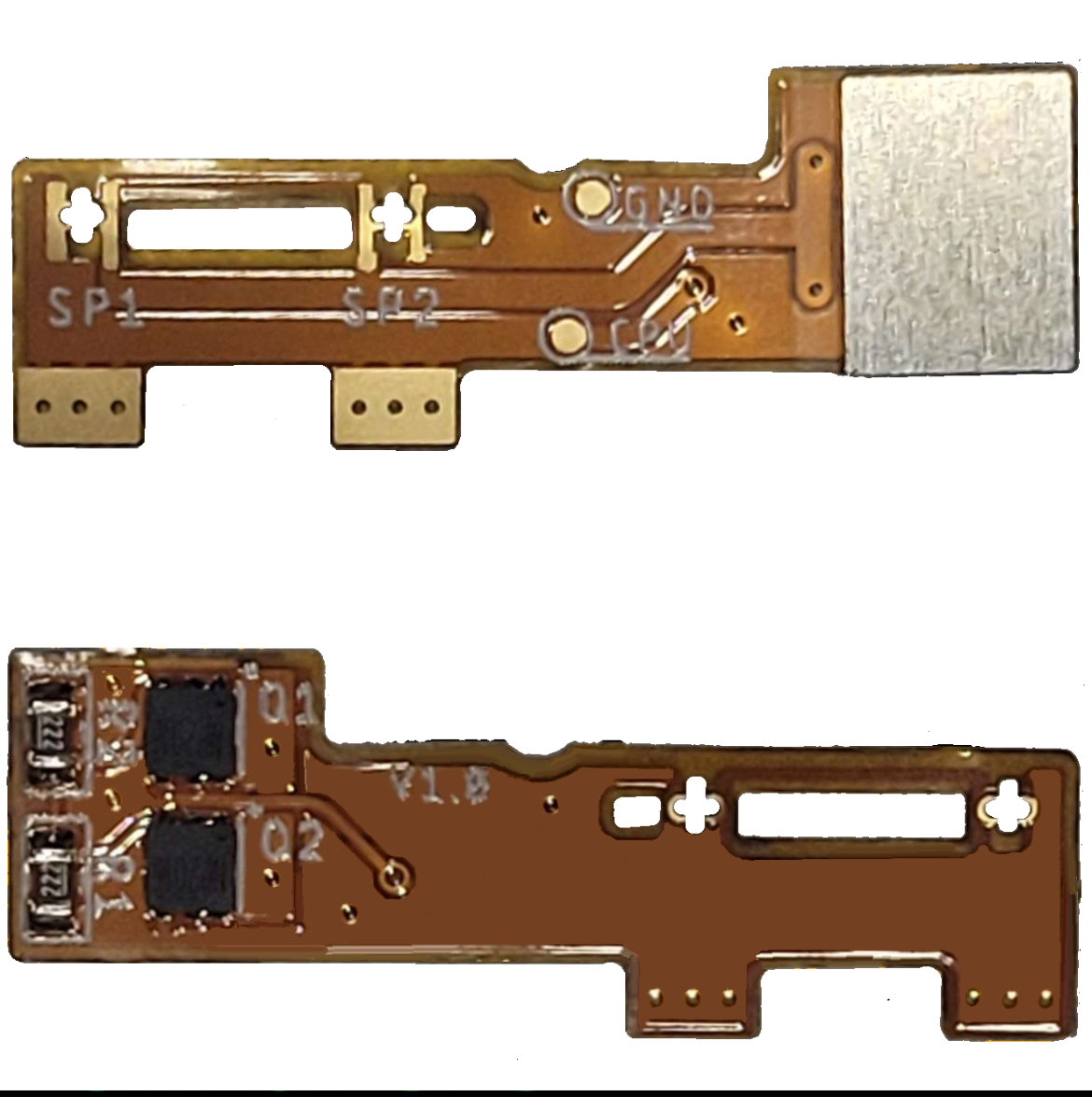

Does anyone know where I can purchase this? I can’t seem to find a good seller.
This will likely cost you more cause these people self print these so they are not economically friendly.
If you want to self print you can use this though it will cost you more than the traditional one but you get the benefit of having additional lines easily connected. Designed to be used with RP tiny and zero.
Better just buy the v2 available in the market, they are A LOT cheaper.
Reactions: dehydrated_lemur
This will likely cost you more cause these people self print these, so they are not economically friendly.
Thanks I found this on github wanted am easy option like just buying one from ally but I guess I just have to make a run at pcbway

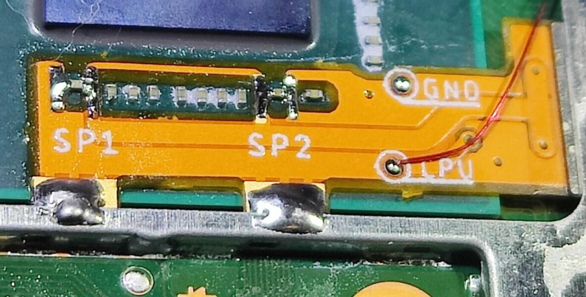

there are even cpu takes 3.3v in it so pretty hard to tell what makes your 3.3v line wrong.
I spent a whole morning to find this culprit (a cap near 3.3v regulator). I don't know why when i injected voltage from psu it not getting hot. But by taking it blindly the 3.3v rail normal again.
Chipped it. It is alive now. Now is the time to revisit the other one which can not connect to pc.
