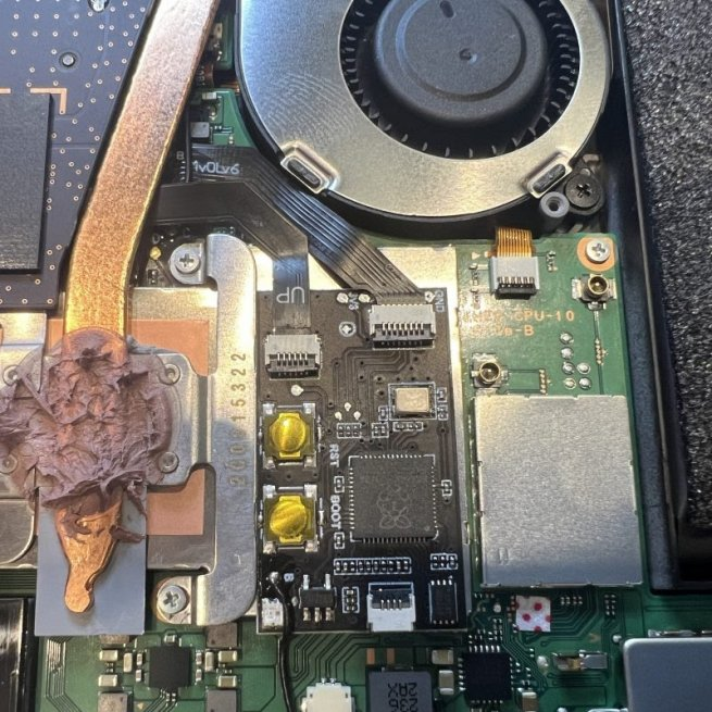

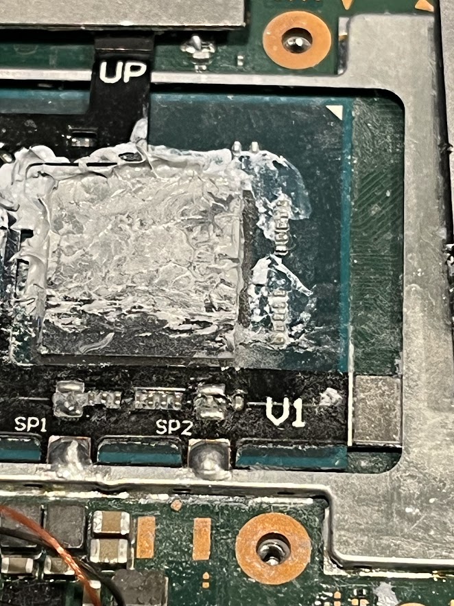

Hey yall smarter than me! Quick question (hopefully.)
Not my first rodeo installing one of these hwfly chips, everything was going fine but heres the synopsis now.
SP2 sparks, smokes, then gets red hot. The console still boots to hekate, everything works, but obviously this is not ideal. Is this a matter of my soldering? In the photo I was wicking SP1 so thats why that looks so jank, but my SP2 I think looks fine? I just don't want to pose a switch killing risk or worse a fire risk. Any suggestions on what I could do to fix this?
--SOLVED--
Some solder leaked below the pad, then was shorting the connection. solved via continuity test

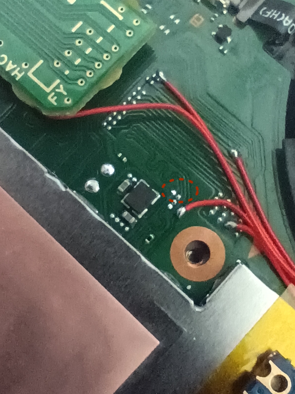

Hello , is there any way to flash rp2040 tiny without the attachment board?
Thx in advamce
WIRING accordingly, short R3 to ground or R9 to ground simulating pressing REST(R3) or BOOST(R9) button

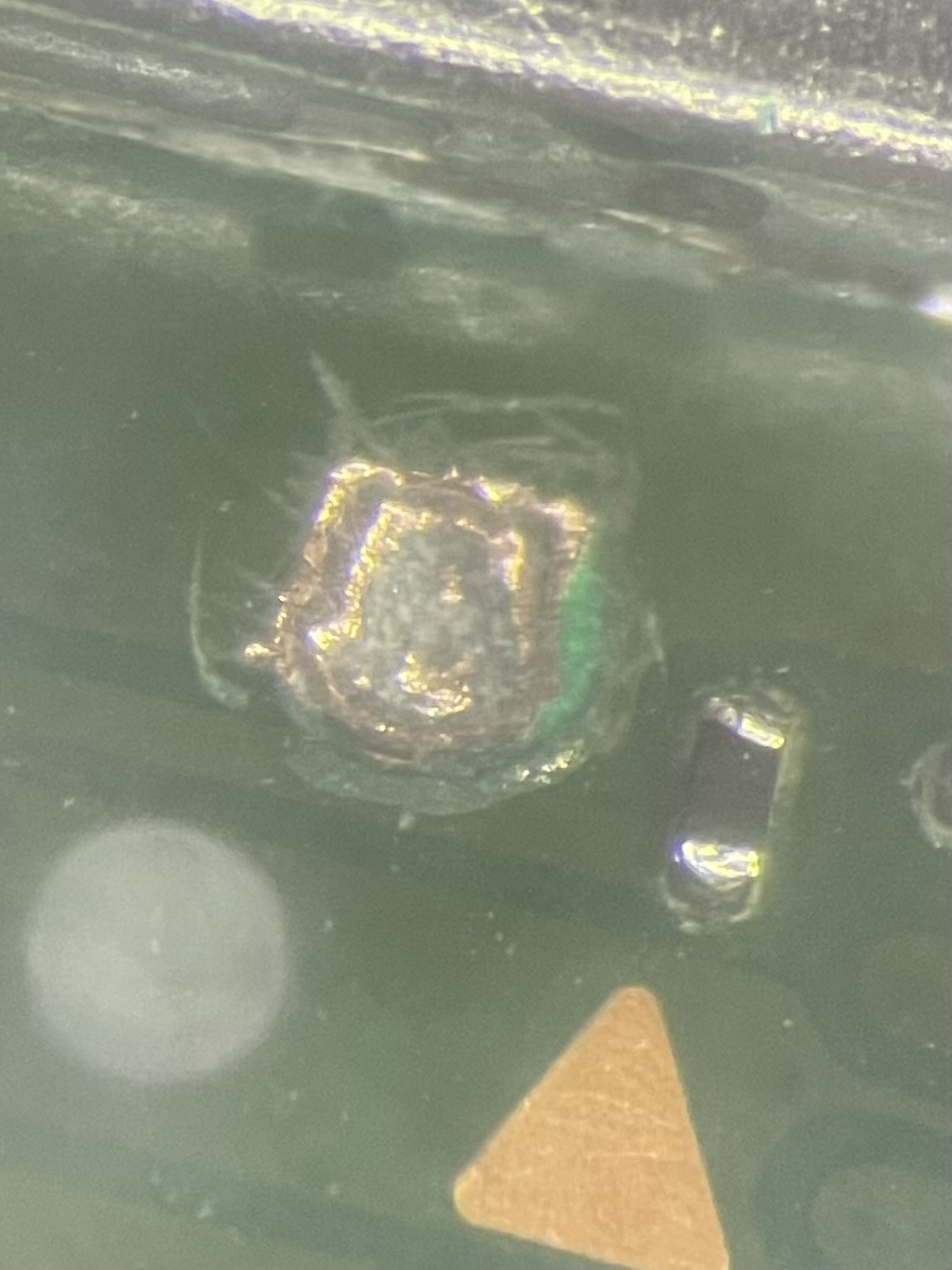

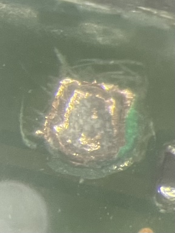

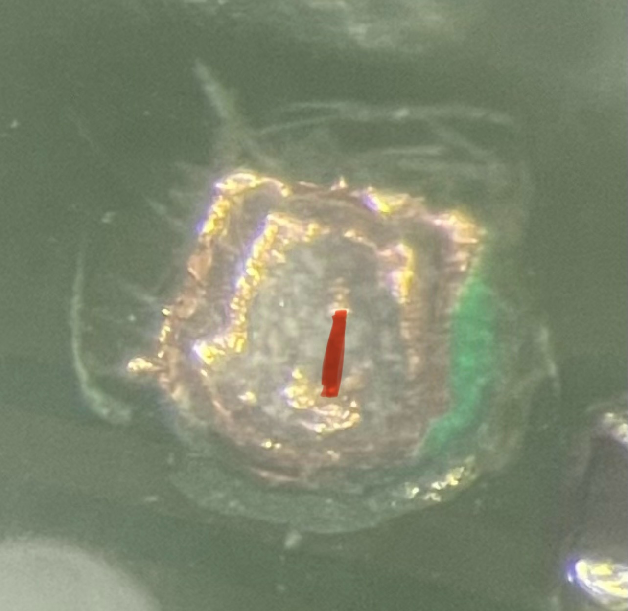

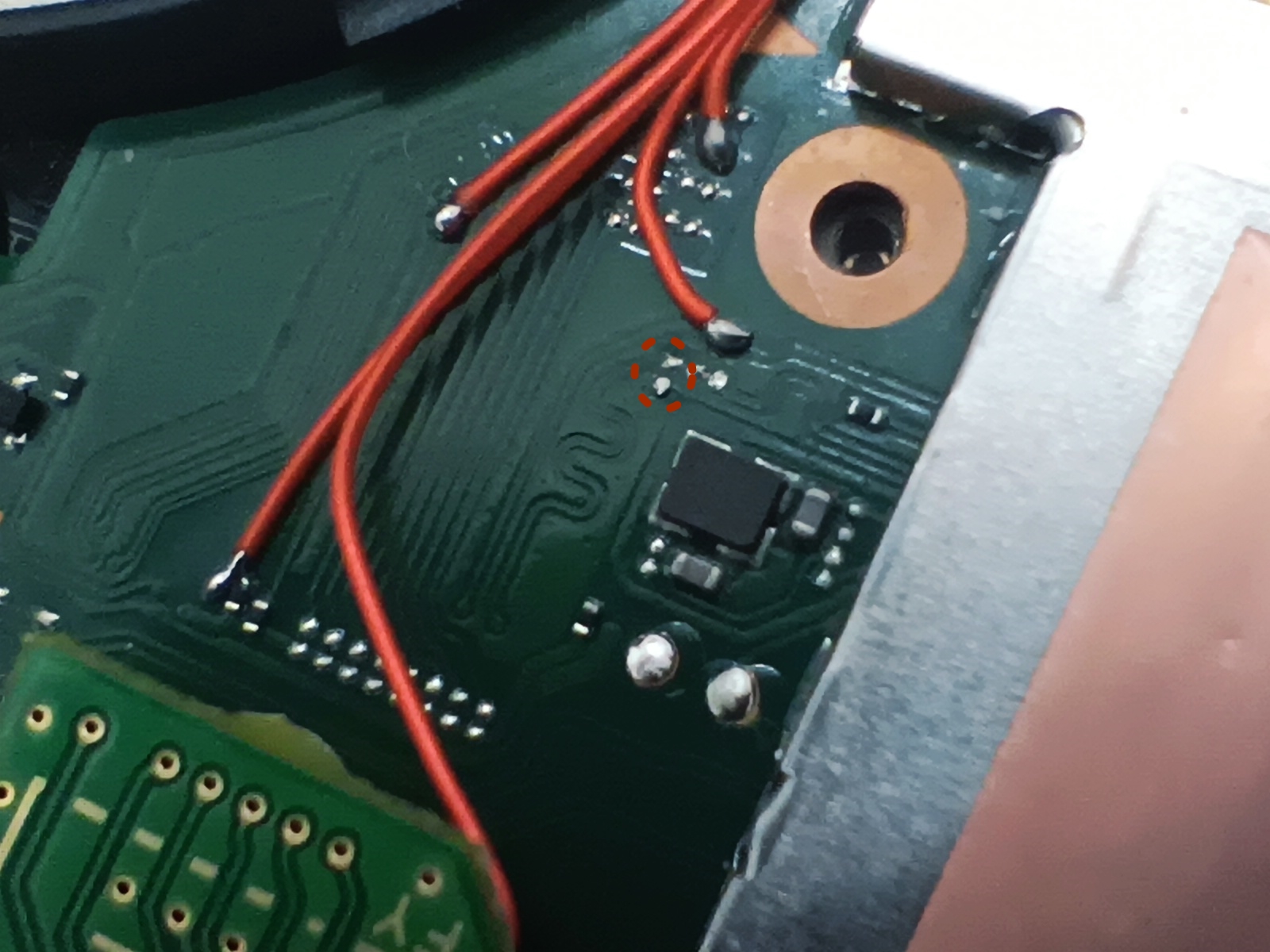

I tried to kamikaze my oled
And i mess up
Now my oled cannot turn on
Do i need make a jumper wire form that point
Reactions: susi91
Yep try to attach it with a jumper. Good thing you didn't break the via. Before bridging, just make sure to isolate the ground with solder mask
But when i measure that 2 point
It have a value
I think it should one of the point is OL because i break the connection
