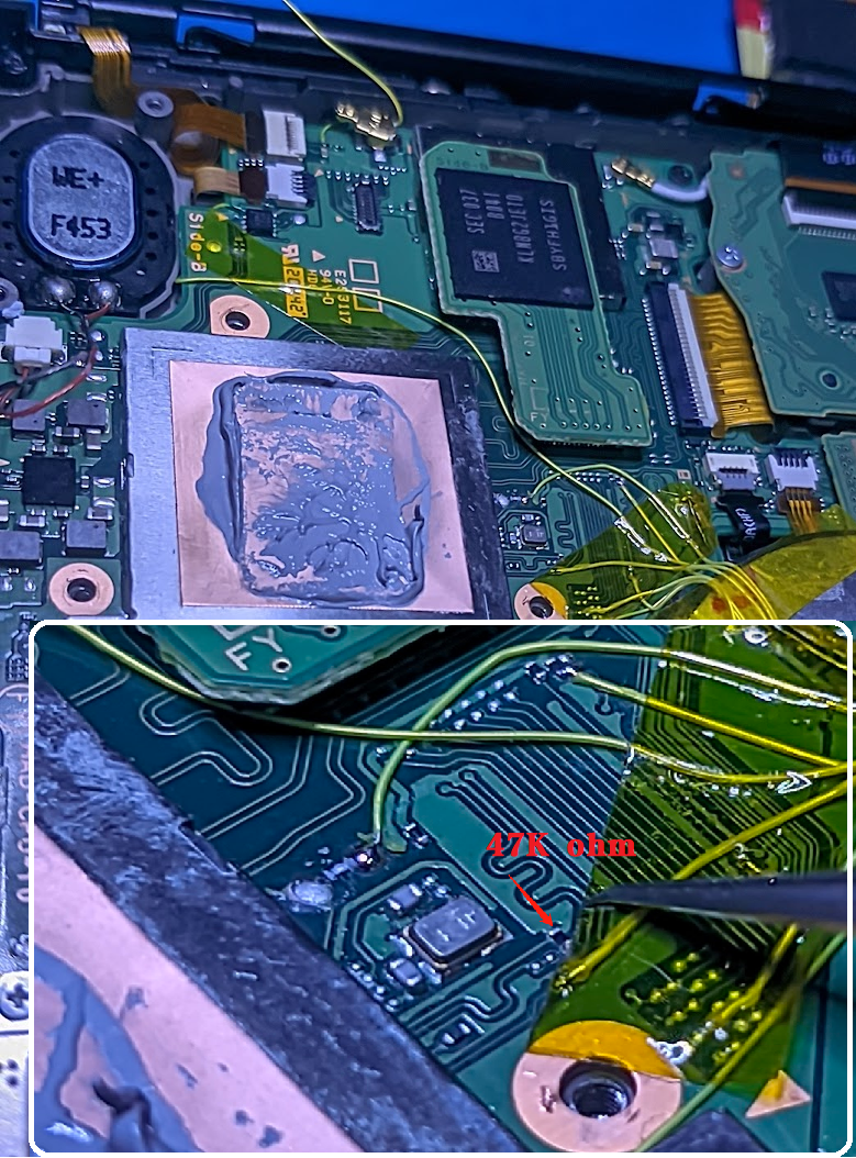

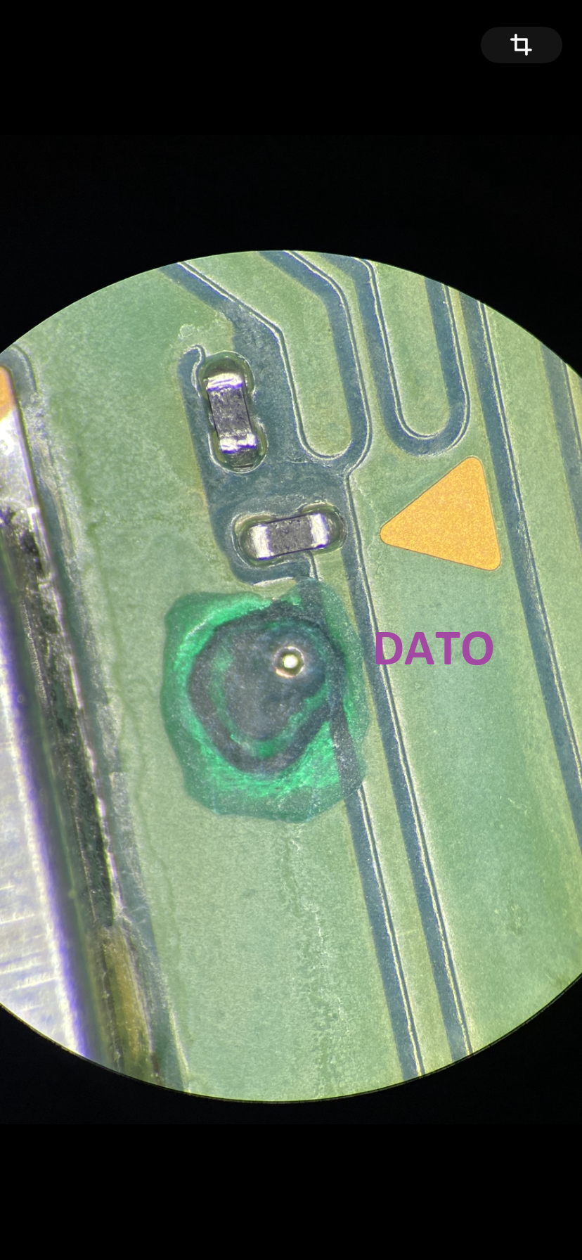

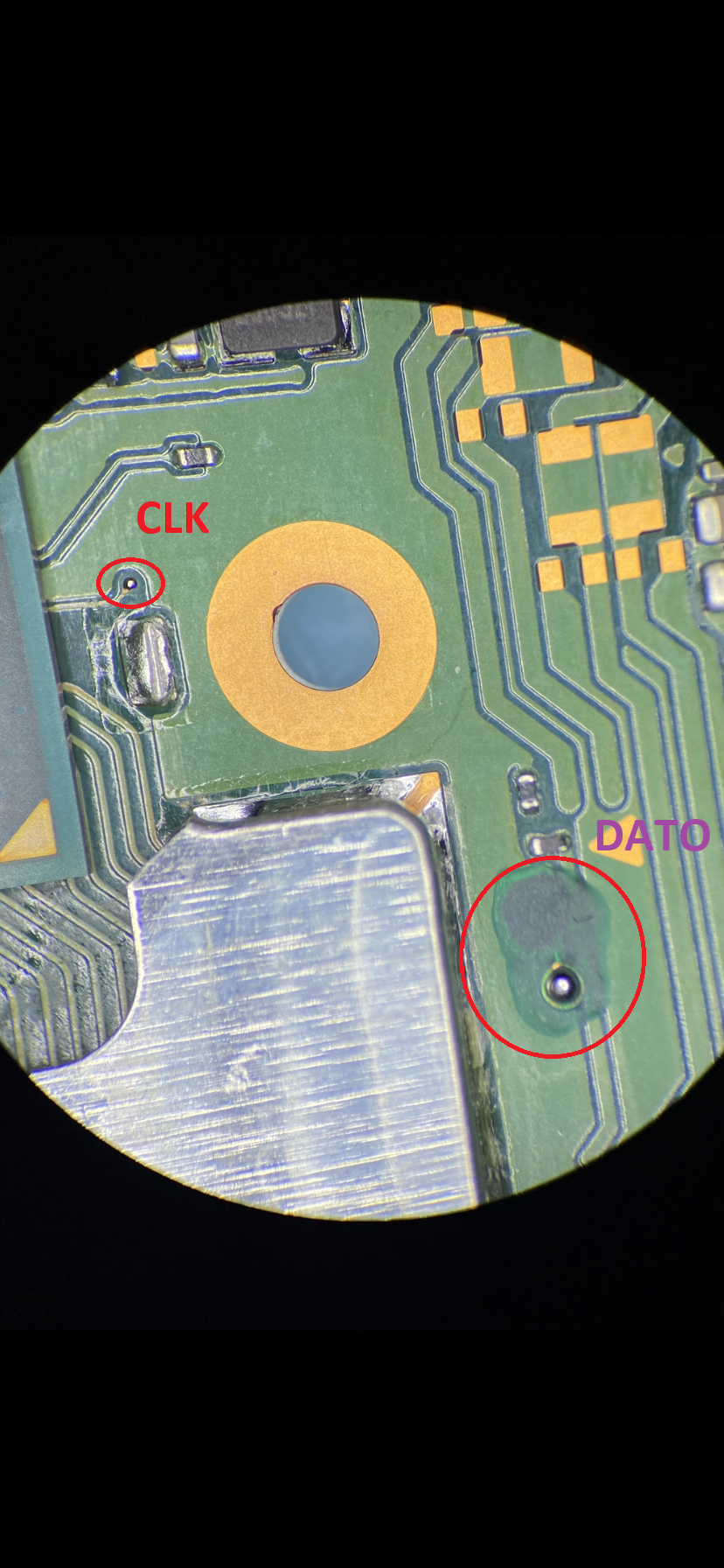

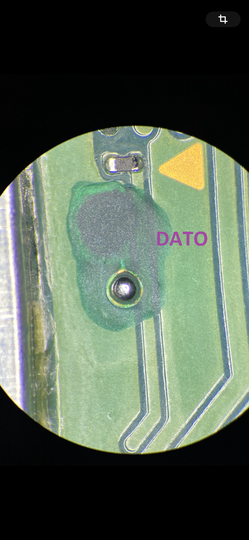

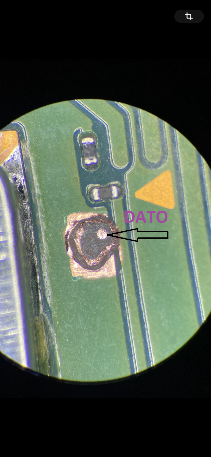

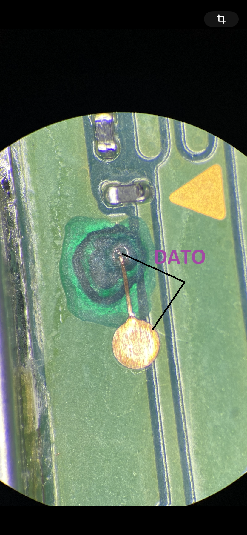

Info, mosfet behind the PCB, success first 5 boots, stable and fast, after error =** infinite, boot only OFW, I'm going to redo it from scratch, sadness, it happened once, but I don't remember what the reason was, clean installation.
any suggestion ?

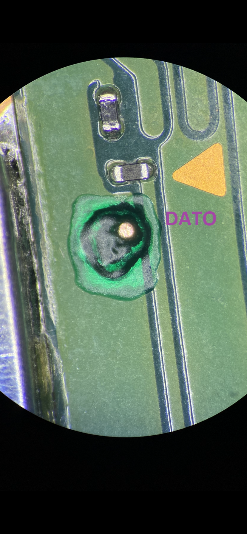

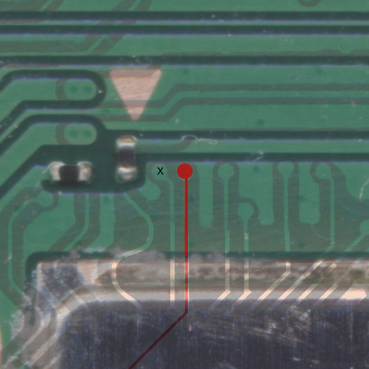

What is the value of dat0 point using kamikaze mode? I'm getting 0.848. I'm getting error *=*
No eMMC block 0 read (eMMC init failure?)

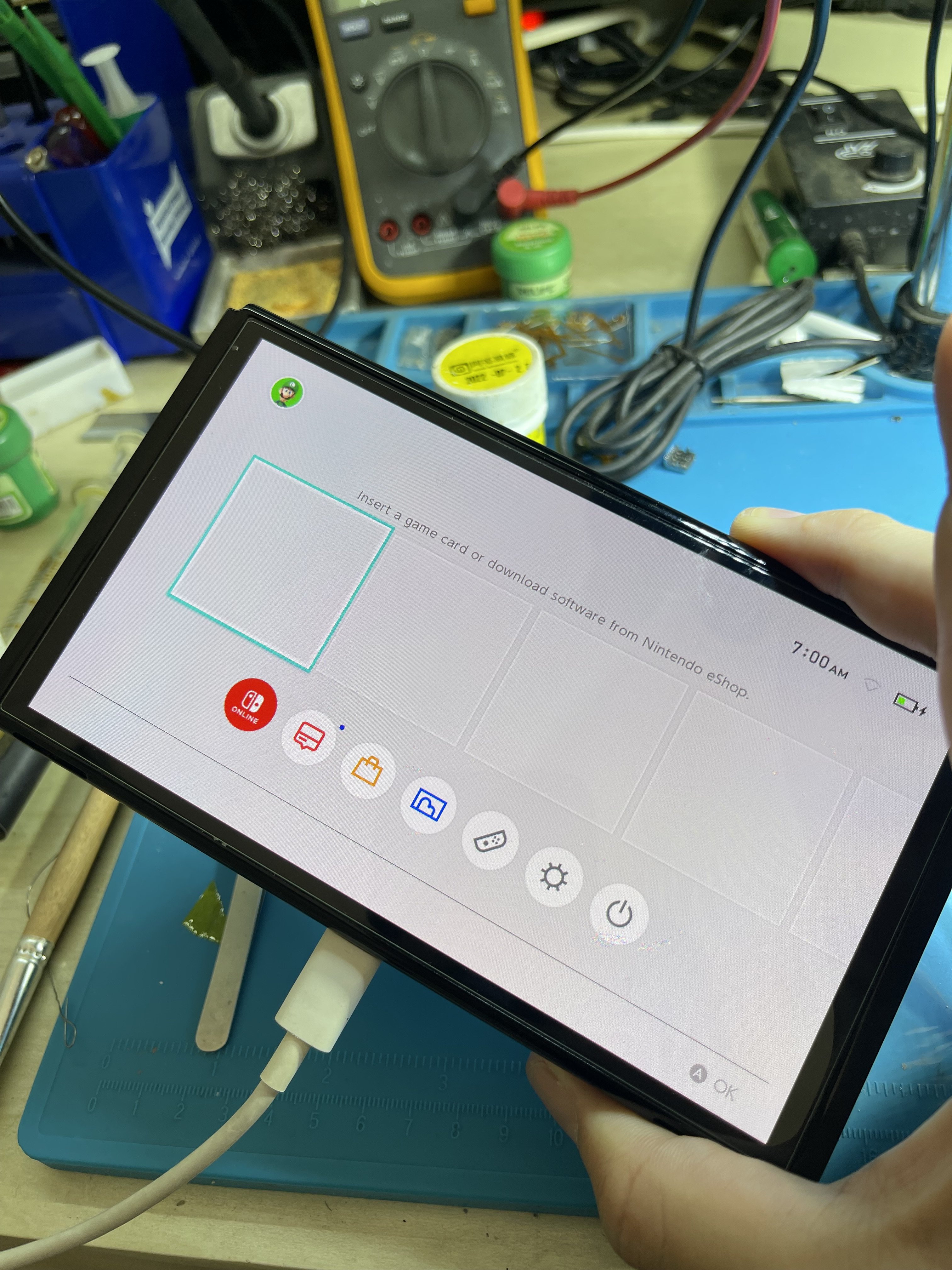

the console can be docked and charged at full speed. at this point i don't know what is going on @@

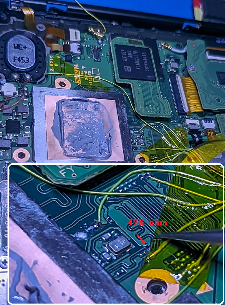

any suggestion ?

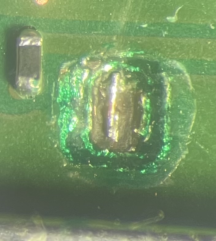

Have you tried with sda/scl?? The problem could be caused by long wire or also the glue from kapton tape
