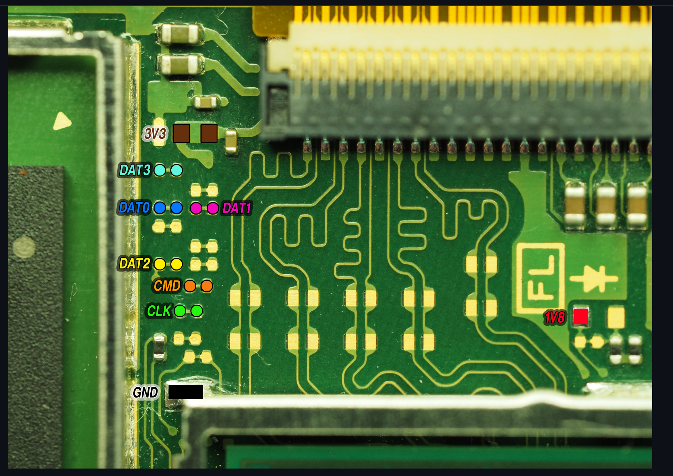

Well, I’ve already made that on my first try to install rp2040. I had lite with Sx lite. Wired the rp2040 to the solder points as it was on diagram, used already installed cpu flex (Sx orig) - nothing. -> several diode mode readings, resoldering, getting rid of Sx smal upper flex (for emmc and rst points) - nothing. -> just soldered back Sx lite (on wires) - boots like a charm. I thought that may be sx chip is bringing some TX shit code to boot0, and swapped chip to hwfly 4.2 with latest firmware - boots like a charm (with the same wires as it was on rp2040 install). Next I thought that may be I need a virgin console, unsoldered hwfly and updated sysnand to latest firmware (15.0.1). -> soldered rp2040 - nothing. Tested with V2 hwfly flex - nothing. Tested with bare mosfet (from hwfly flex) soldered by wires without removing vertical cap as it was on diagram - nothing. Took another rp2040 - same result… and that was the point were I decided to give up and try later :).
P.S. Again, the only thing that I believe could have affected this install is thin and relatively long 36awg wires on cpu mosfet controlling point.

It is actually quite possible that the rp2040 pico is bad at filtering out noise and interference on the SD wires since those are high speed signals. Much shorter and thicker wires will give a clue if that is a problem.
Another possibility is the SD card itself.
Perhaps the content of the SD card is wrong? Does anyone have a copy of the SD Card image @Tafty is using?
That way we can at least rule out the SD card data being bad.
It is also possible that the SD card driver is only accepting certain size cards or cards from certain manufacturers.

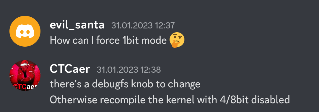

You will need a 1bit capable sd reader if your low voltage adapter is wired for 1 bit.
All publicly known usb sd readers which can access boot0 are not capable of 1 bit mode.
You only need a low voltage adapter if you would like to read/write from the emmc while it is still connected to the switch. The nand chips on their own will happily run on 3.3v

If your SD card content is good try using 30AWG wires. Keep the wires as short as possible!
Tafty's boots to a "no SD" screen without a card inserted, so it mustn't be the card. Even extremely short and quite thick wires aren't working, so we're pretty sure it isn't able to prepare the eMMC, the Ubuntu version was just too early in development.

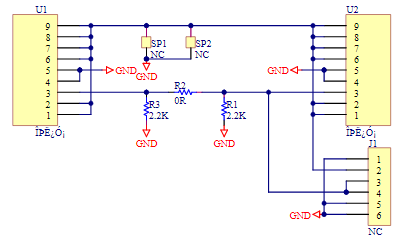

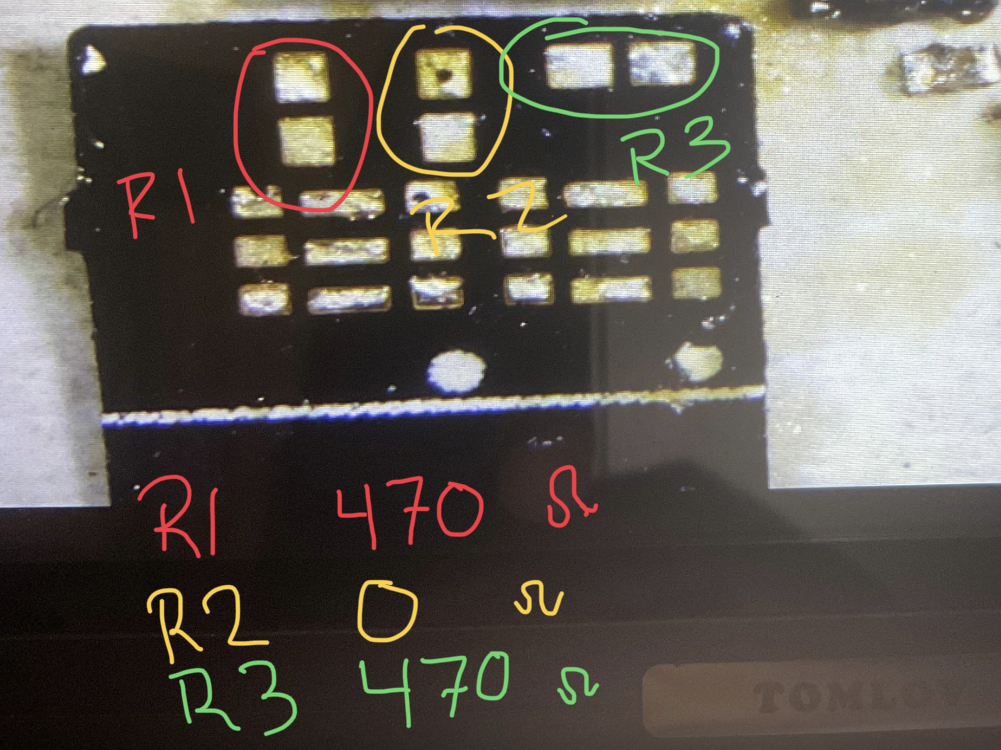

I was in the process of tinning my cables when I floated all the components off my flex cable (not paying attention to what was underneath.) I have the resistors I believe I need and I‘m about to repair the flex cable.
Can someone confirm the resistor values I’m about to replace?
sorry please take a note, i already measure the middle one is 0.0ohm the rest 2.2k
same value 470 ohm
Then I can help test too!
Where are you getting 470? I just measured on my flex, they're 1.1K resistors. Maybe different revisions used different values?
