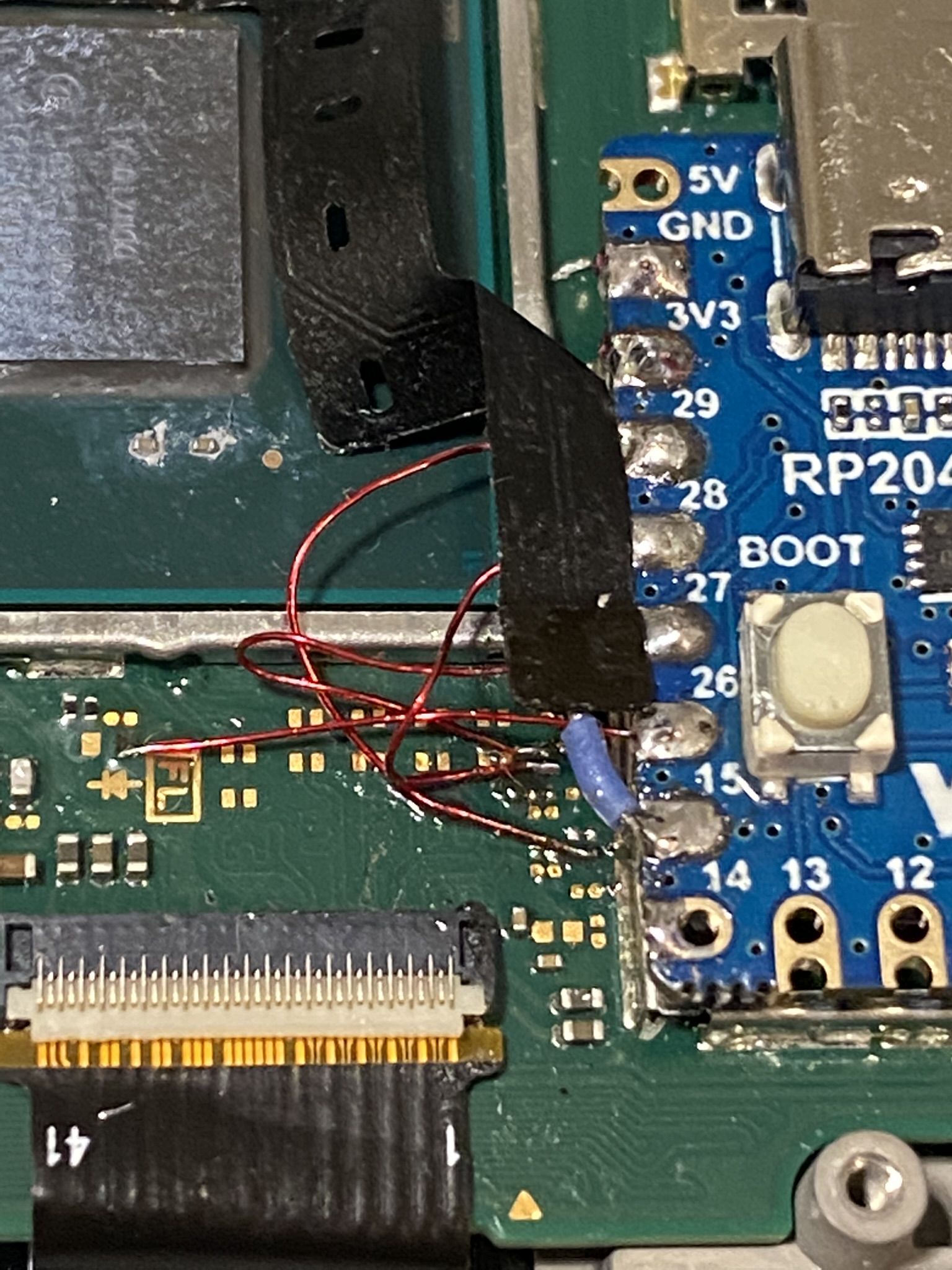

It is actually quite possible that the rp2040 pico is bad at filtering out noise and interference on the SD wires since those are high speed signals. Much shorter and thicker wires will give a clue if that is a problem.

Well, I’ve already made that on my first try to install rp2040. I had lite with Sx lite. Wired the rp2040 to the solder points as it was on diagram, used already installed cpu flex (Sx orig) - nothing. -> several diode mode readings, resoldering, getting rid of Sx smal upper flex (for emmc and rst points) - nothing. -> just soldered back Sx lite (on wires) - boots like a charm. I thought that may be sx chip is bringing some TX shit code to boot0, and swapped chip to hwfly 4.2 with latest firmware - boots like a charm (with the same wires as it was on rp2040 install). Next I thought that may be I need a virgin console, unsoldered hwfly and updated sysnand to latest firmware (15.0.1). -> soldered rp2040 - nothing. Tested with V2 hwfly flex - nothing. Tested with bare mosfet (from hwfly flex) soldered by wires without removing vertical cap as it was on diagram - nothing. Took another rp2040 - same result… and that was the point were I decided to give up and try later :).
P.S. Again, the only thing that I believe could have affected this install is thin and relatively long 36awg wires on cpu mosfet controlling point.
can i see a picture of the install.
and can you give me diode readings for all the points? including cpu
and can i confirm you used 47 ohm resistors on the RP itself?

Perhaps the firmware uses a fixed or narrow timing window and isn't able to calibrate timings for consoles that aren't close to the one the original dev was working with. That would mean CPU point's wire type and length would greatly influence success.

I recall the Xbox 360 RGH chips had a fixed timing and they were *very* sensitive to wire length, the Xecuter QSB had a handful of pads for calibrating glitch line length.
Reactions: FruithatMods
My wire length isn't as short as it could be... But it's much shorter then it was when I originally installed, I'm using kynar aswell

Welp, it's definitely not because my wires are too long :)
