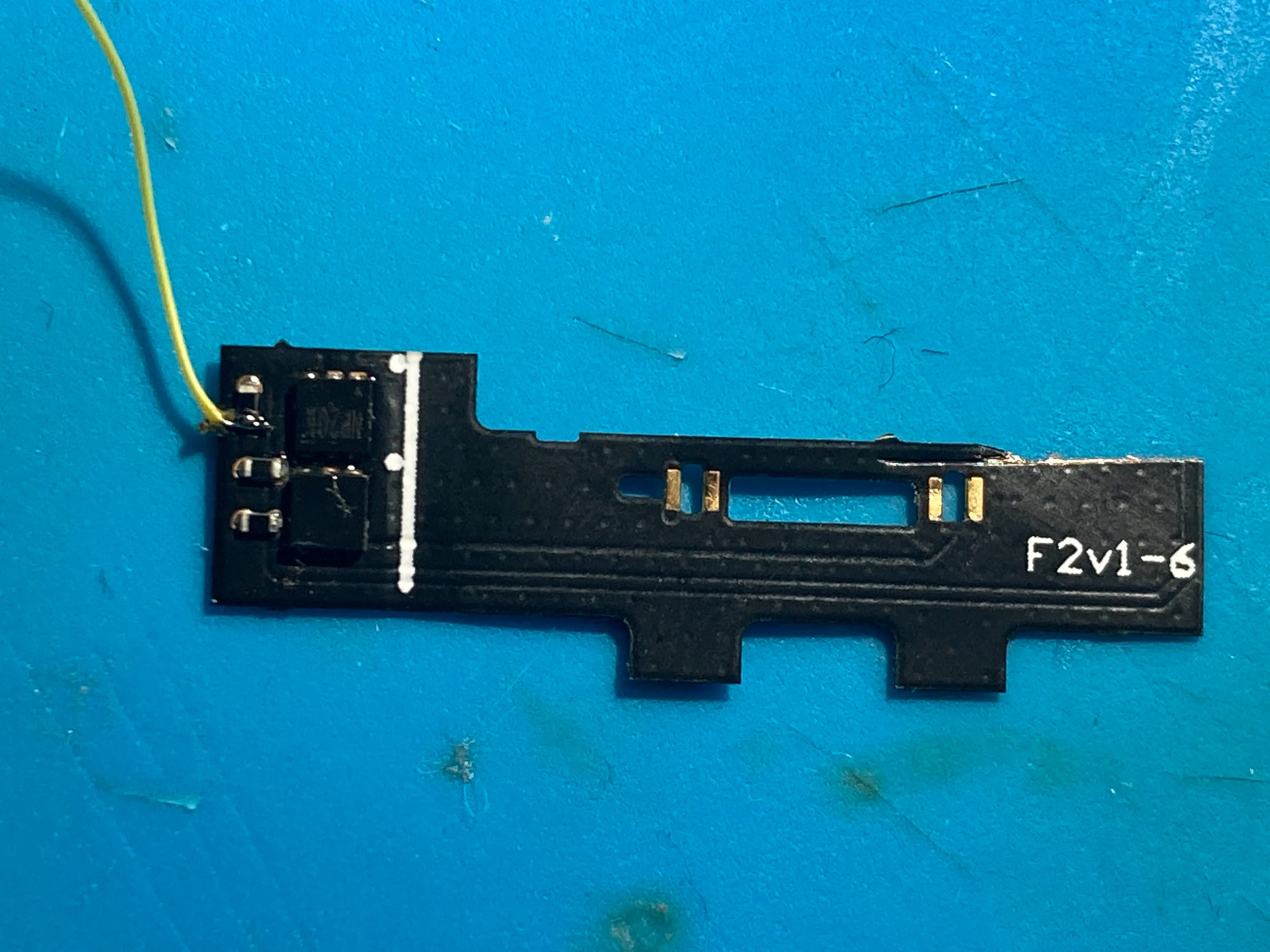

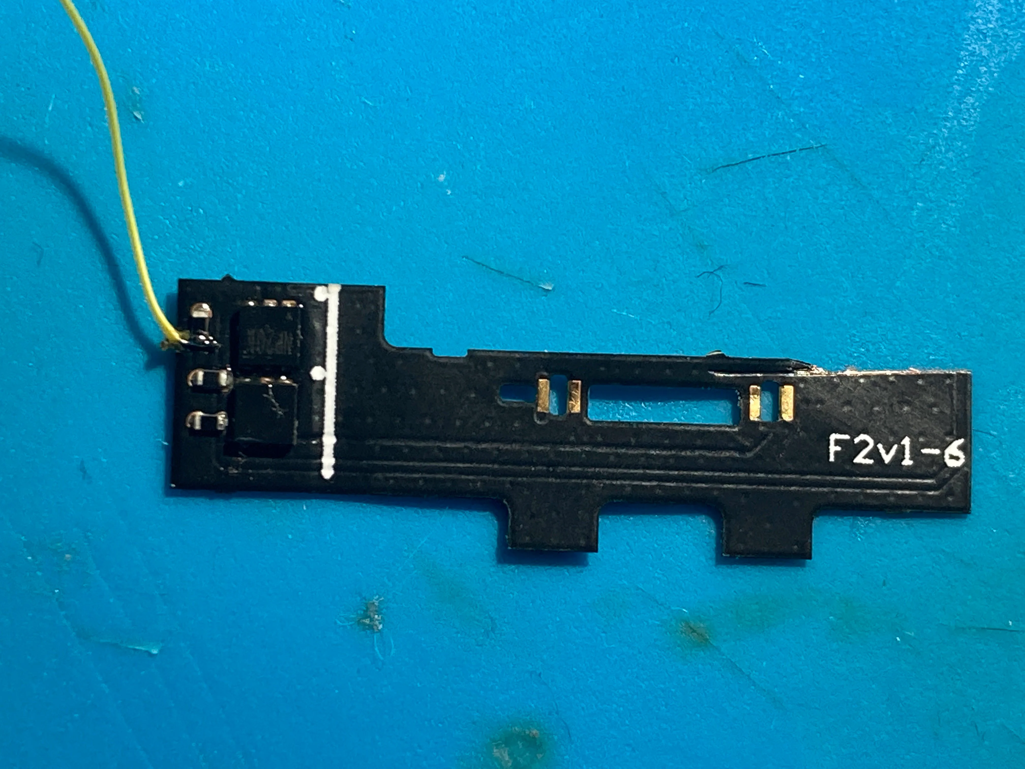

Backboard MOSFET update:
I tried it on a third OLED, and I got the glitch limit error. A couple of times it glitches after 2 minutes, but mostly it won't. I added another MOSFET, 100ohs set but still the same.
Then I noticed that my CLK wire was longer than usual so I cut it short, now I'm usually getting a glitch within 20-40 sec.
Final set on this OLED:
47 all.
two mosfets.
I tried the method on three OLEDs thus far. I invite others to try it out.
ِEDIT:
What I did differently right about the time this method came out was using another solder wire.
The one I used and had no problems with was a mechanic 63% tin 37% sn.
Then I started using a Malaysian brand 60/40

More and more the "two fets" and the "more solder" fixes are starting to make me think it's simply a resistance issue when the glitch is failing. Better soldering, different solder (low-temp leaded vs higher temp unleaded), different wire thicknesses and materials (copper/silver/aluminum), all these things have an effect when we're talking about the speeds and timings these glitches are needing to occur at.
Agrees 100%.
In summary its all about the resistance.
Usually occured because bad soldering.
47 all.
two mosfets.
ِEDIT:
