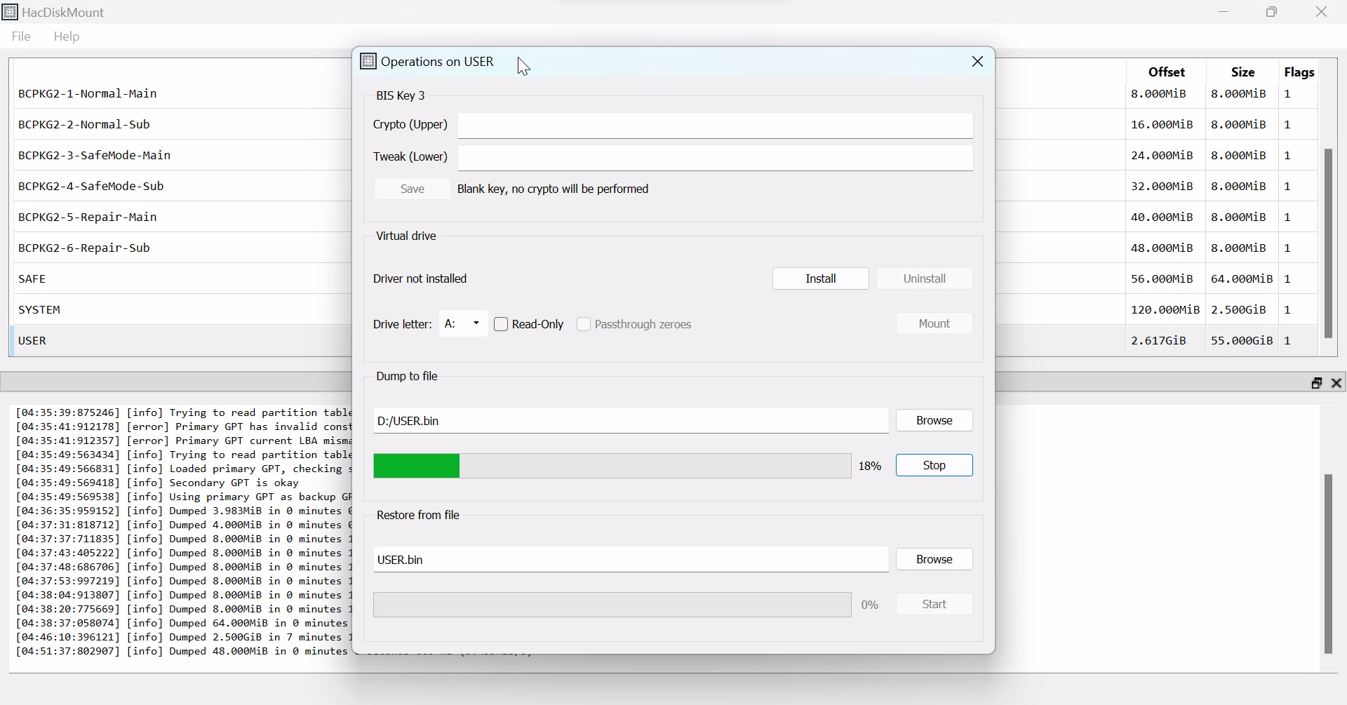

Yes, mounting GPP with ums-loader! I can post the error with boot0/1 in a bit, doing a user partition backup and it's taking a while.

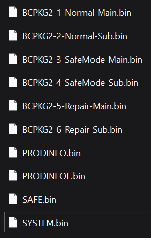

In the background it's possible to see the contents of GPP, and in the other screenshot there's all the contents of GPP (except user.bin which is still doing).

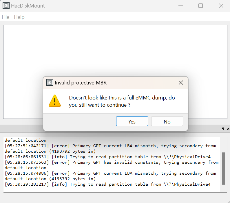

EDIT: Just tried mounting boot0/1 through HacDiskMount on my unpatched switch, same error, says it's not a full eMMC backup and confirms to open, and then throws an error. So I guess this still isn't an indication of dat0/1 short.
No, I dont think boot0/1 can be mount on those software,I confirm error is normal.

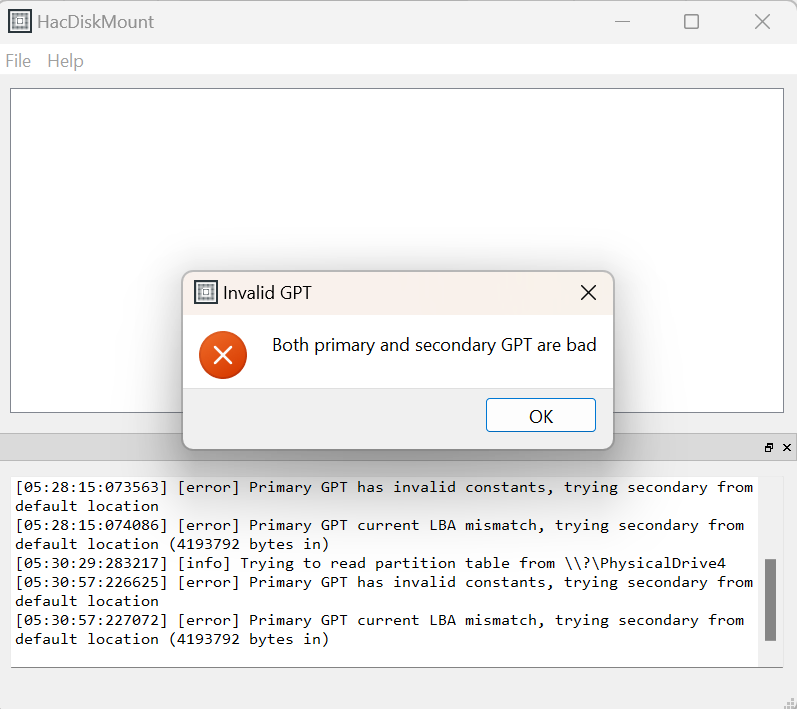

Okay, small update, the switch is back from the dead and I have display. I used HacDiskMount instead of DiskGenius, but I got GPP to mount and made a copy of all files just to be sure. Boot0/1 won't mount though. Is that an indication of Dat0/1 short?

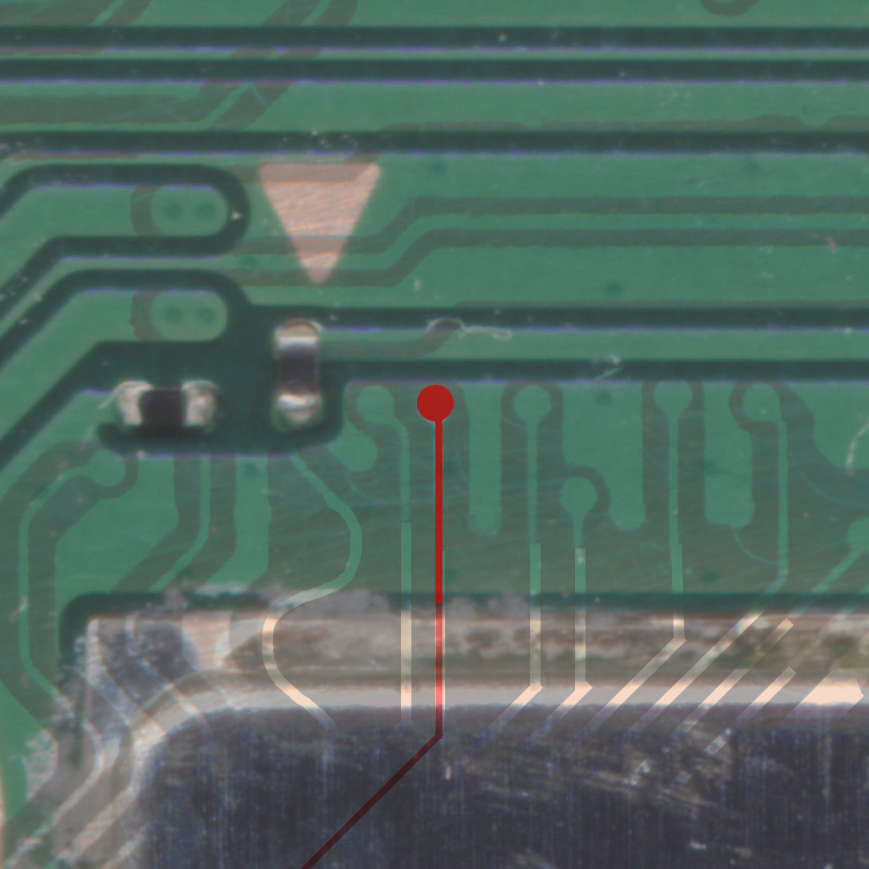

dat0 running through that alignment indicator circle is a very convenient visual marker. though, being in between other lines makes me a little wary of potential damage to the surrounding traces. I looked at the board scans and found that the dat0 line also comes out into a via pad beneath two ground layers near the cmd resistor, with fewer small traces surrounding it. would be interesting to see if this point is possible as well
