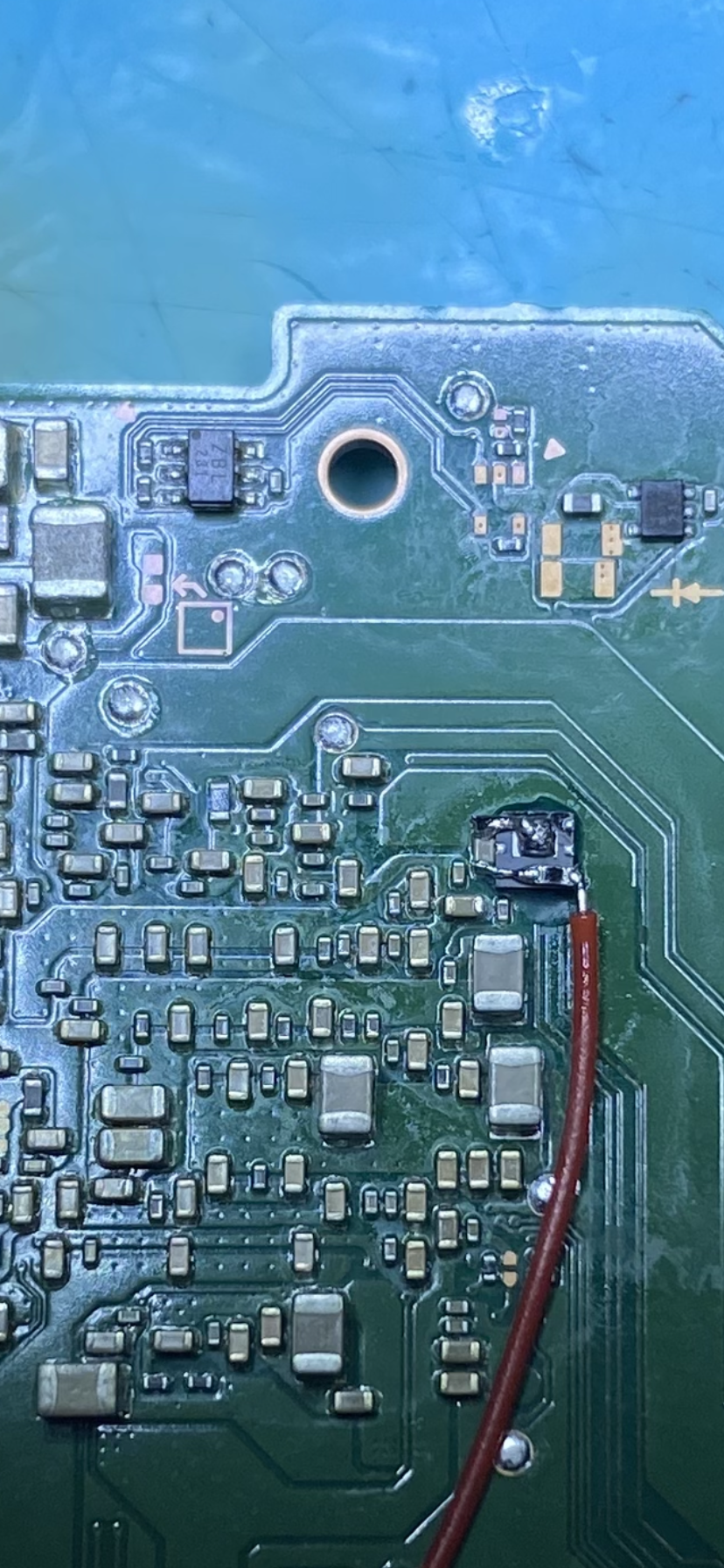

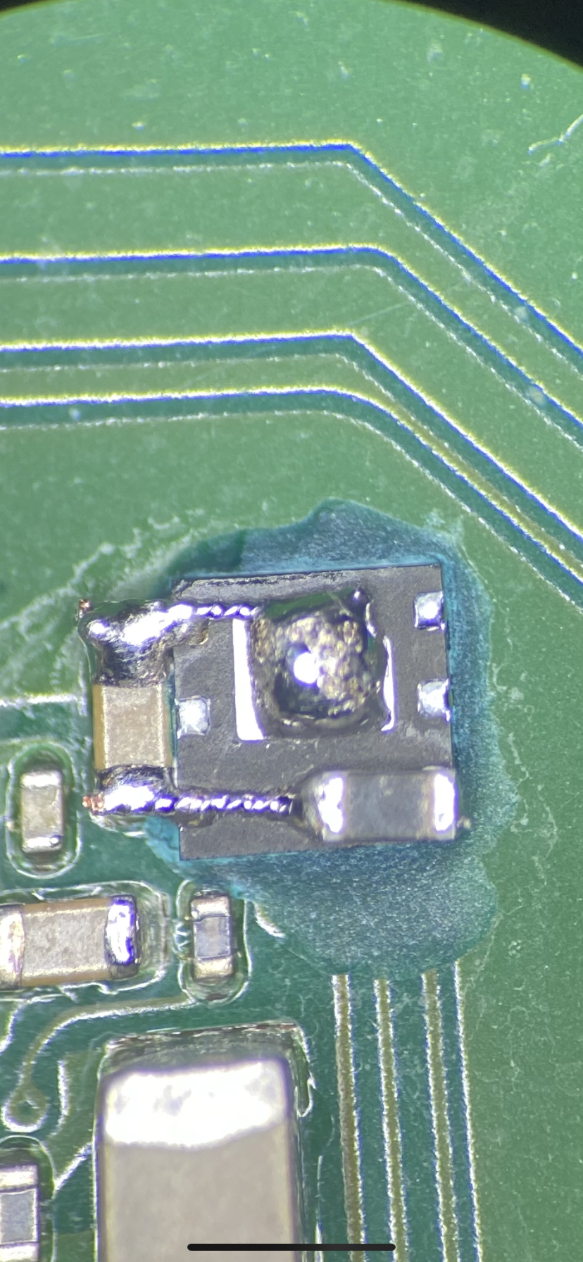

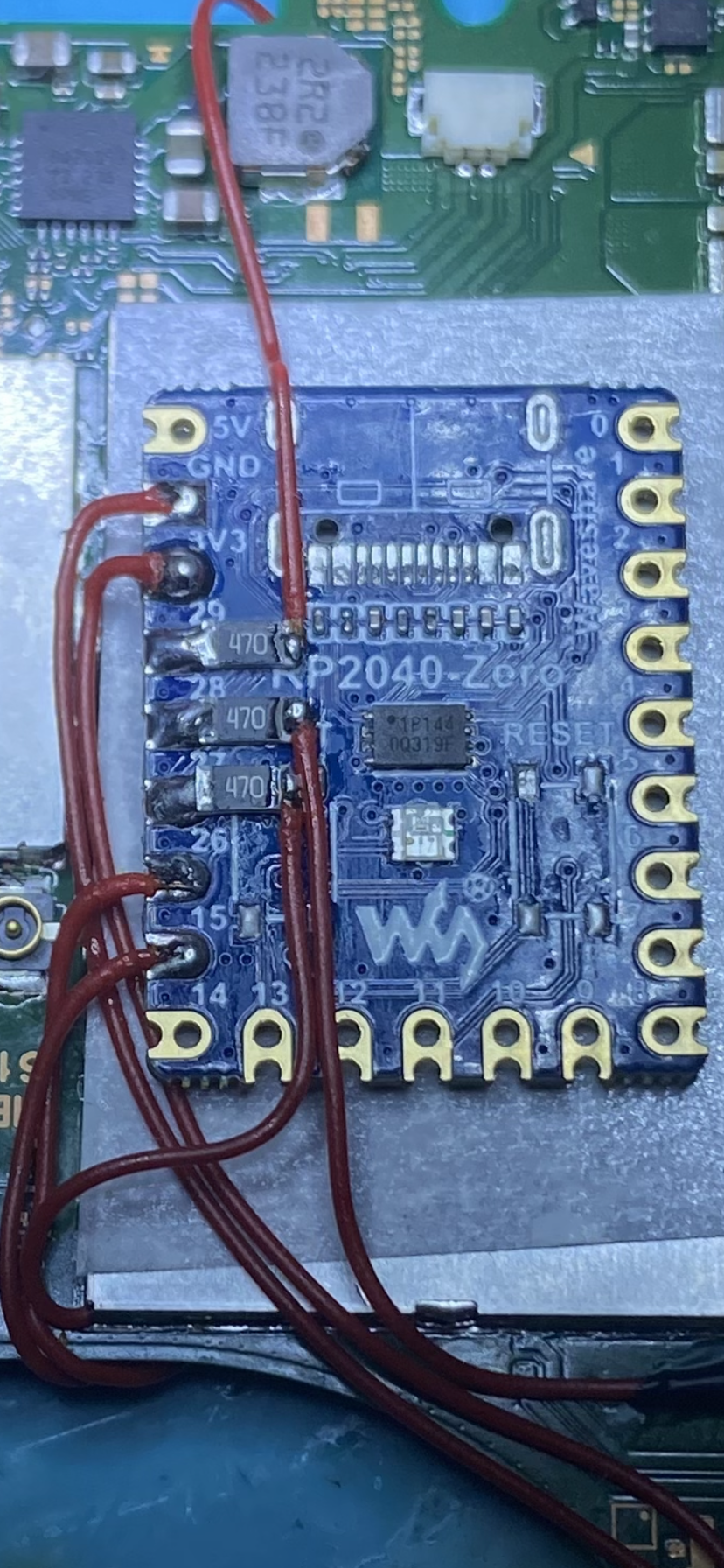

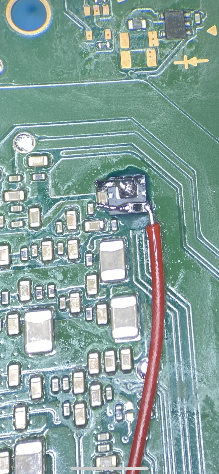

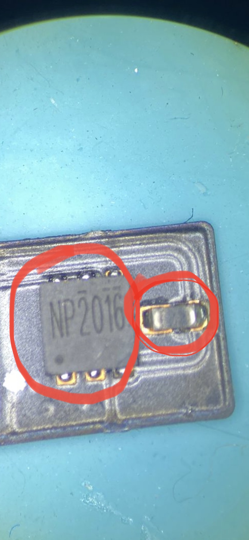

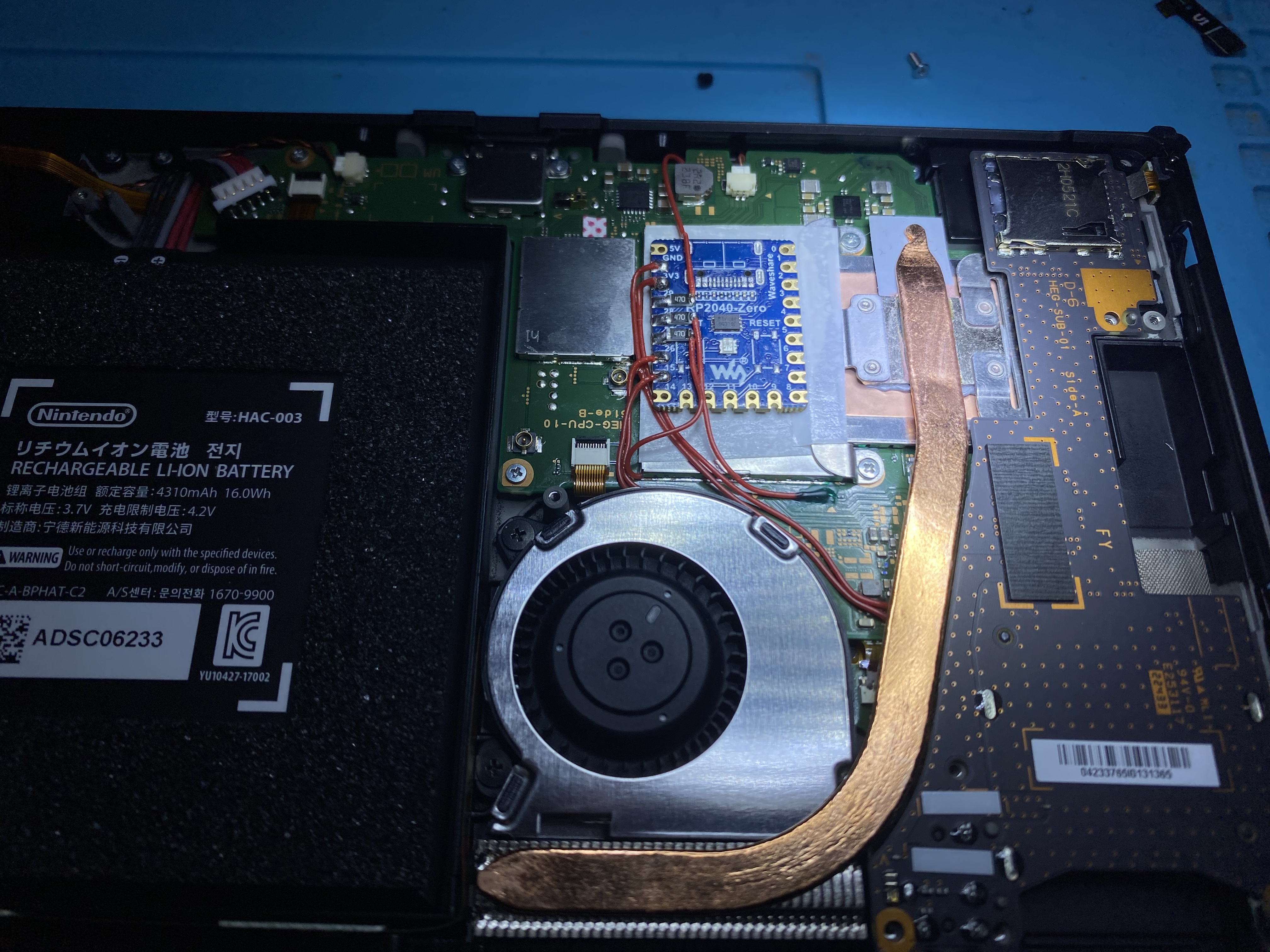

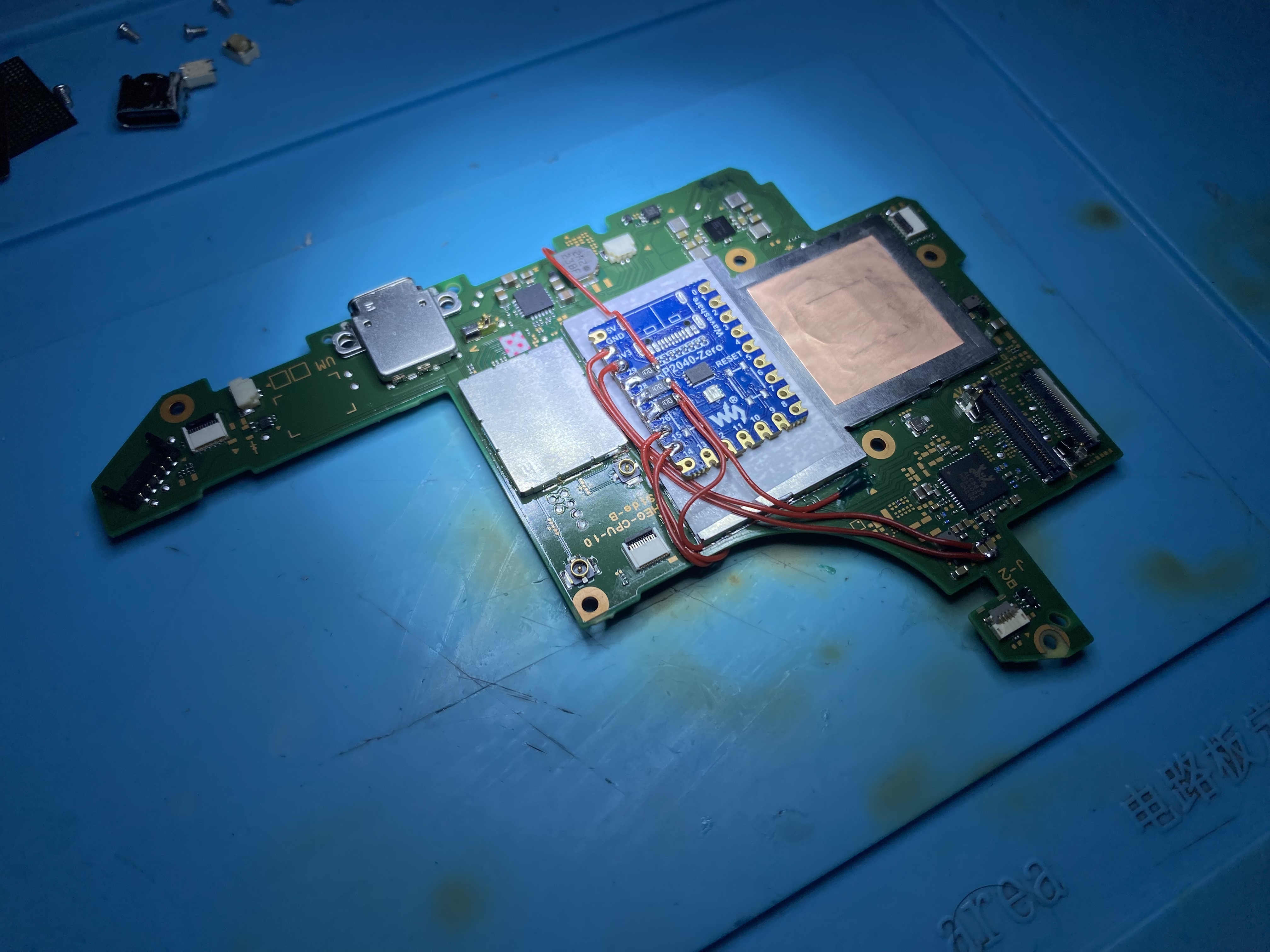

Picofly soldered on Oled with mosfet on the back pcb. I took the mosfet from the defective connection ribbon of one Hwfly. I used some thin copper wire to solder on the capacitor and loaded it with more tin. Excellent glitch time.

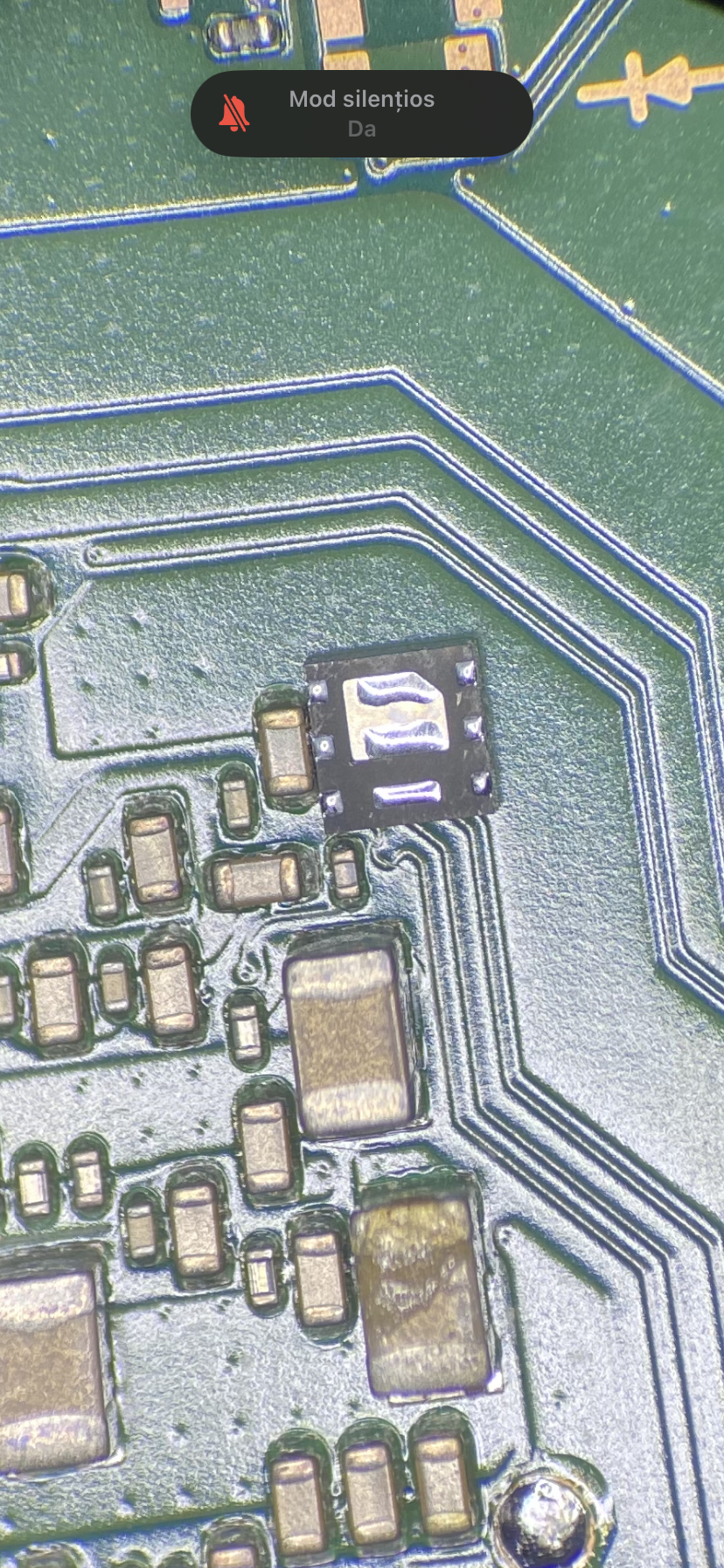

Hi, good evening,
I'm new here in forum and i need your help.
I bought a very cheap Switch V2, when i was unlocking, I realized that it already had passed in other hands. :sad:
The Caps and Pads of the positive points SP1 and SP2 on the APU was removed.
Is there a way of recover these Pads or any other alternative points to unlock it???
Looking this topic I saw it's possible to install MOSFET on the OLED's back. Can i install it on V2?
Thanks for your attention.
See the images bellow.
Nice work. What's your glitch time?
