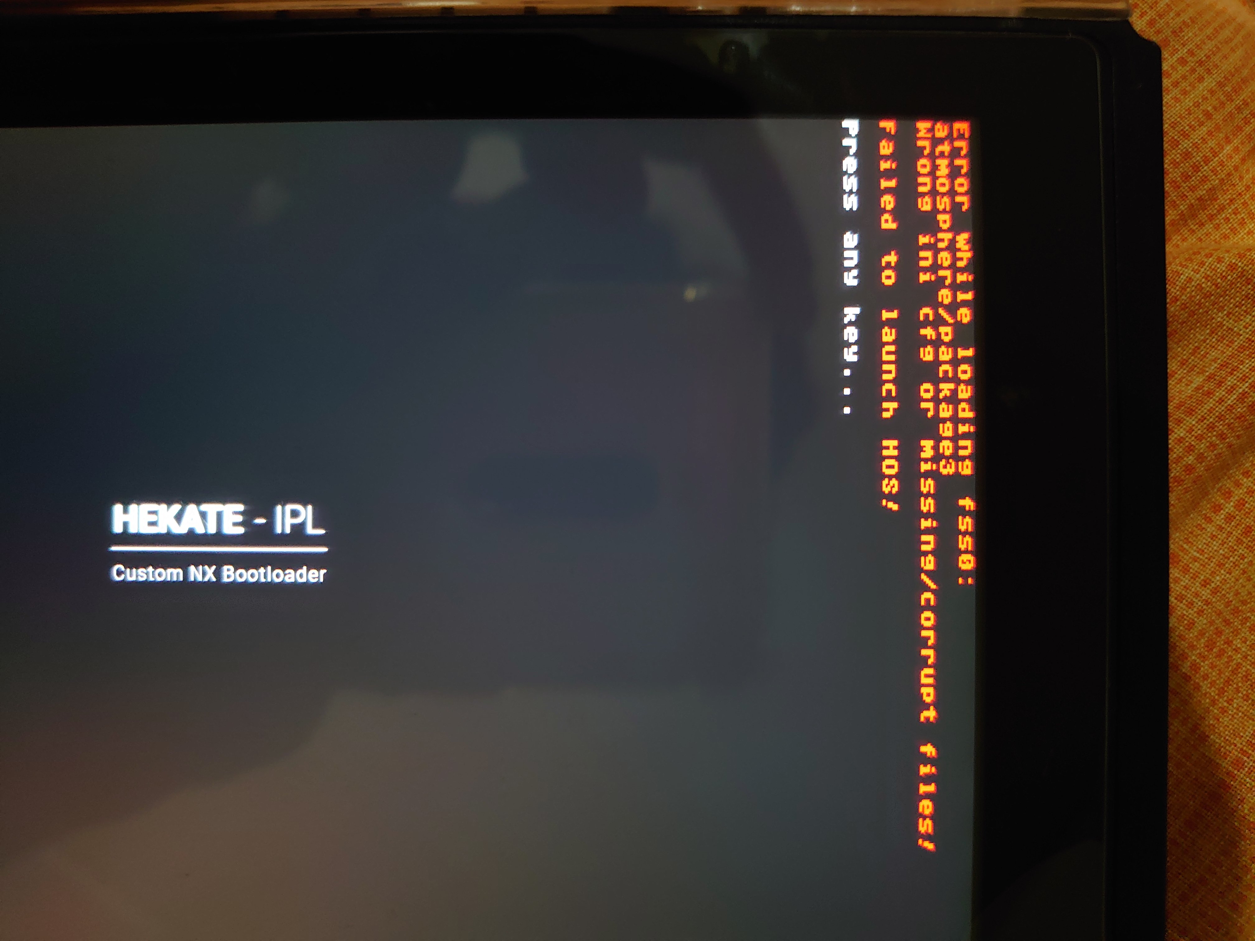

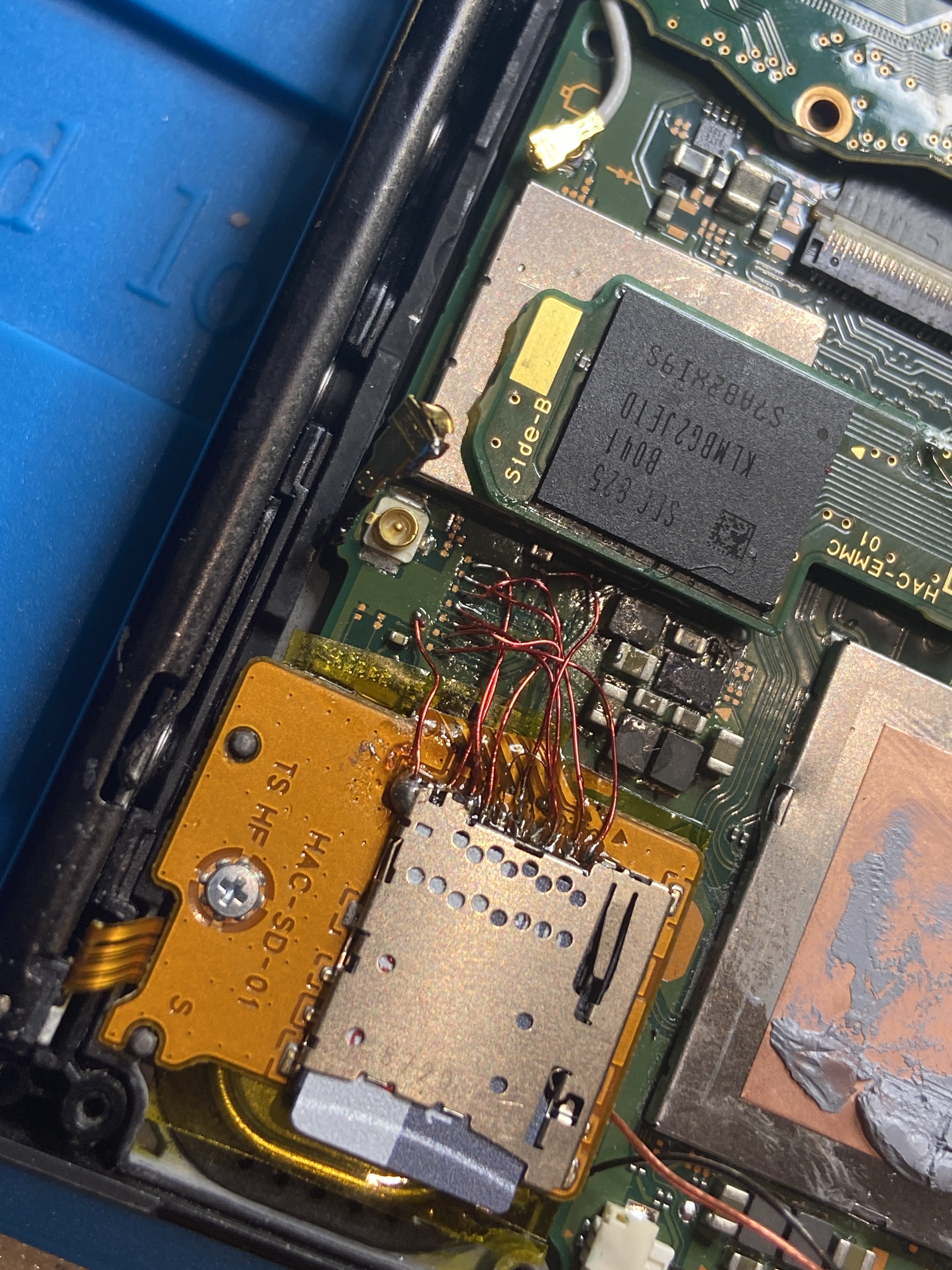

I did a fun little project. V2 modded but with broken SD card slot. I manually soldered each connector to the motherboard and got into Hekate, I got this message although SD card info was shown correctly. It boots into main screen and SD card size is shown in data management.
