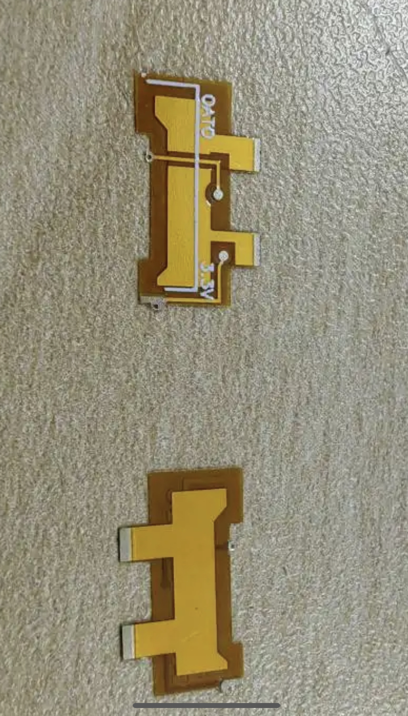

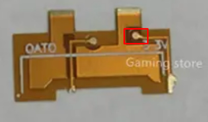

Do these dat0 adaptors look okey to you guys? I dont get whats the 3v3 trace is for. It’s way cheaper than the usual four anchor ones, but I don’t know how good they are.
I ordered some as well but haven't tried yet. That +3.3V is from the cap where you anchor it, some people use it as an alternative power source, though I prefer to stick to the caps nearby the fan connector (AIO guide scheme).
Check under the microscope that the DAT0 contact on the flex is good (half-moon) and you should be good to go.
I would mask this contact, so there will be no probability for it to short to the GND, which is the nearby anchor.
Bought the same but out of 4 different Dat0 Adapter they are the worst. The pin is nearly double as broad as on the others. So it will often connect to two nand solder balls and short them.

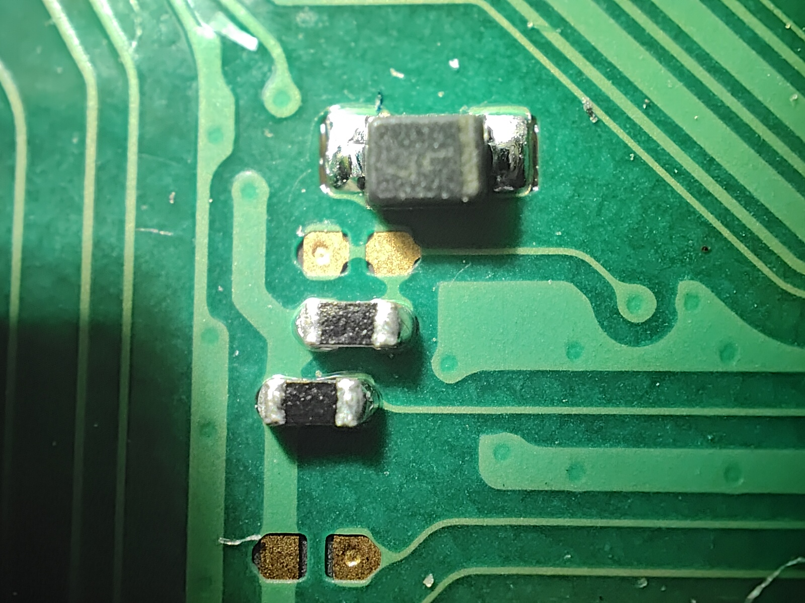

Hi everyone. My v2 board rts via has a cap/res above it, so it hard for soldering iron to access without moving other component. Is there any other point easy to access. I follow v4 guide, the pic is a bit different but this is where the rts via show. I dont want to use the via in the mmc adapter, it could be trouble if I remove it. Thank in advance
Same here. Got the same one with the chip a while back. It was to thick, and the achor points were shorter than usual. To many issues. Ended up using an old "corner" model I had as a spare.
Edit: now that you mention it, I guess this (connecting to 2 solder balls) might have been the problem with it all along. There was no chance i could get it to work for more than 2h. Nice catch.
I have grown to hate any dat0 adapter that ISN'T the 4-anchor. I've tried 3 other types and they all gave me issues. The one 4-anchor install, that I did, worked 1st try.
I'm now fully onboard with @Dee87's opinion that it's better the get a stencil and solder paste, to then reball the emmc and set your own permanent dat0 line. Easier said than done but you'll save money on buying adapters and attain an IMMENSELY valuable new skill. IMO, if you cannot do this, you shouldn't be messing w\ OLEDs anyway. PicoFly is an above-average-skill-mod on V1\2\Lite, OLEDs are a whole nother level.

Hi everyone. My v2 board rts via has a cap/res above it, so it hard for soldering iron to access without moving other component. Is there any other point easy to access. I follow v4 guide, the pic is a bit different but this is where the rts via show. I dont want to use the via in the mmc adapter, it could be trouble if I remove it. Thank in advanceView attachment 370165
The points in red seem to be connected. Use multimeter to confirm.
If they are you can solder like in photo (blue line/circle)
just use the left diode or right side of the top resistor, since all mark in orange are connected together

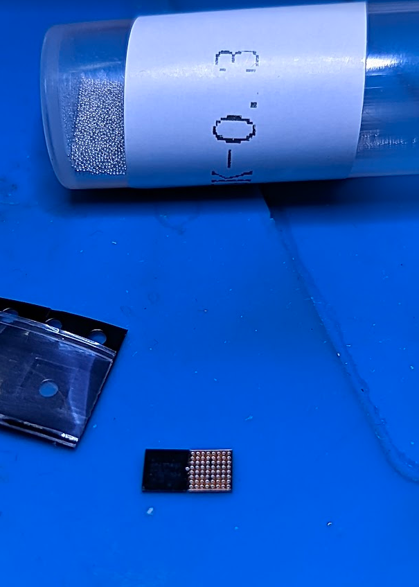

Seriously, has anyone ever rebal/replace this IC, can i done it using hot air, also any advise on solder ball size?, as this is the first time i will do any bga reball.
clean and flatten the pads before put on new MAX77812. Ball size is about 0.3mm.
And yes, you can only do this by hot air
