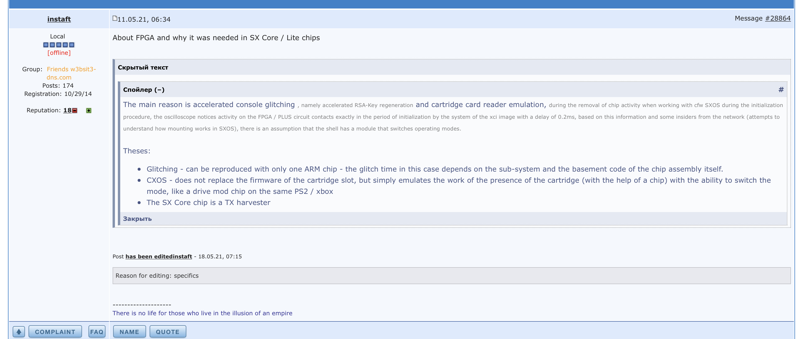

Hey, just found leaked sources about how hwfly works.
Also I read on 4pda thats fpga used to fastly generate rsa keys to emulate cartridge. I am not completely understand what does it mean. Looks like it is wrong machine translate.
Can you provide a link to the exact post?
