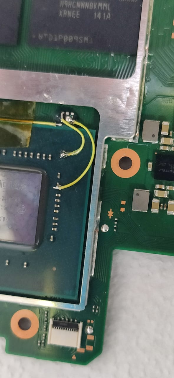

hello to all friends I'm following this post, I wanted to congratulate the developers and the guys who are always helping this incredible work.. I hope I can contribute a little with the guys, I leave my installation that I use in my game, switch oled, only 1 mosfet and fast boot .. thank you all

I know there are consoles where v2.5 works, and 2.6+ does not, so you can try different firmwares (2.5, 2.61, 2.64)

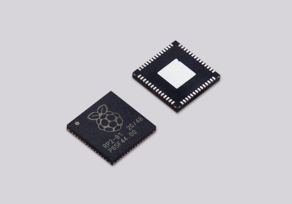

Hi All. I'd like to tackle a new challenge with Picofly. My local vendor does not sell rp2040 as a whole board, but only the chip. How hard would you say it is to DIY this into a Picofly?
Pretty smooth. What's the AWG or mm?
There are several members currently in the process of beta testing some hardware boards that rely on soldering their own RP2040 onto the board. The McFly is going to be open-sourced once the 4 beta testers receive their boards and confirm working installs. At that point, you could use the files provided to build your own board or pay an online service to do it for you.
