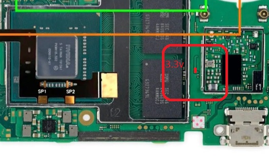

I'm not sure, but It can be posible that battery was plugged on.
If the battery was still plugged in, it's possible that you accidentally shorted those 2 pads with your soldering iron when you accidentally removed that cap. Even when the 2 pads are shorted for only a second it could cause damage to other components on the board.
Unplug the battery, clean all flux residue with alcohol, remove any bridge that was made. Remove the rp2040.
If you have trouble removing the flux, and you have a hot air gun, heat up the flux to 100°C and add alcohol to dissolve the flux and clean it again.
If you have a multimeter, check continuity between the 2 pads. If it beeps then you probably have a short somewhere else on the motherboard. (maybe something is getting hot on the motherboard?)
If it doesn't beep, you could try turning it on.
You could also try measuring the voltage on those pads, one pad should read +/- 3.3v, the other should read 0v.
The switch should work without that cap.
If the switch still does not turn on it's best to leave the battery unplugged for now and let somebody who has experience with switch motherboards have a look at it.

The 3.3V cap soldering point is a dangerous point,this tiny cap is super fragile and easily broken and missing by soldering heat built up by seconds.The 3.3V wiring diagram mess up the micro soldering work.Just use the alternate point.
I didn't use the alternative point and my switch brok

Tonight I will take the console to a person who is dedicated to fixing consoles.
The Raspberry, the flex and the cables are disassembled and the console is closed, but with the battery connected.
It is increasingly clear to me that I have made some kind of short circuit but I don't know where, so I will take it to a professional.
What I do know for sure is that no smoke or burning smell came out, so if it is a short circuit, it may not have broken anything but it is unable to power on. I have also thought that it is a problem with the 3.3v regulator that is near the point to be soldered.

I tried to bridge those pads without capacitor, but that was after the Switch Lite doesn't boot.
Is It dead or can a professional repair it? I was talking with a guy who repair Switch consoles. He told me my Nintendo should power on without this capacitor so he needs to check everything in motherboard carefully.
I highly suggest you send it to someone who knows what they are doing. Shorting cap pins is the last thing you should have done. That's exactly as if you short the pins of a battery. I think by now at least the small 3.3v regulator is dead if not something else.
