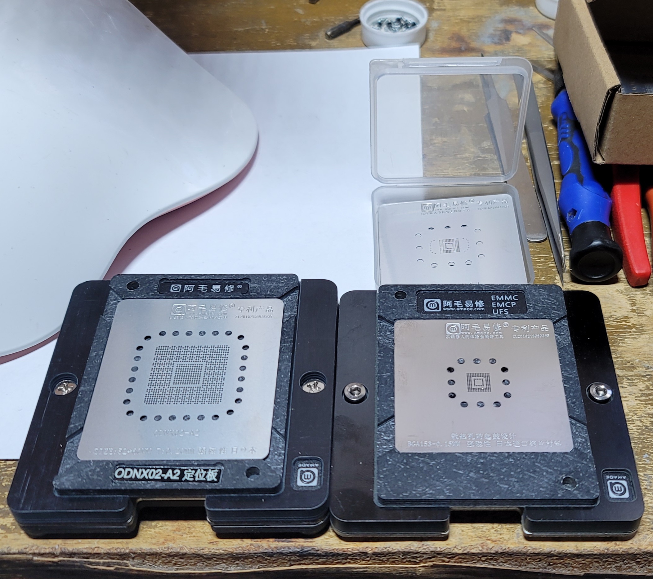

@Dee87 I don't see how those holders would work with the stencil you linked, though (I also have a multi-stencil for NSW but mine's lacking the emmc, thought I had one :sleep:)

I fully believe the only thing(s) holding me back from accomplishing anything is having experience with the proper tools. Time to research\buy holder(s).
All you really need is a heat gun, 0.15mm BGA153 stencil and solder paste, some flux, a decent scraping tool to scrape paste into the holes, and a pair of tweezers to hold the stencil in place while scraping and applying heat. I reballed an EMMC recently just to try in case I'd have to at some point, see pic. I simply placed the emmc on a napkin for some movement resistance, then placed the stencil on top and aligned it, then held it in place with tweezers. I applied flux after melting the solder balls and applied low heat to melt the flux and loosen the chip from the stencil.
The holder and alignment kit linked above probably makes things easier and I would buy it if I were to do reballs every day, but as long as it's just occasionally then eh.

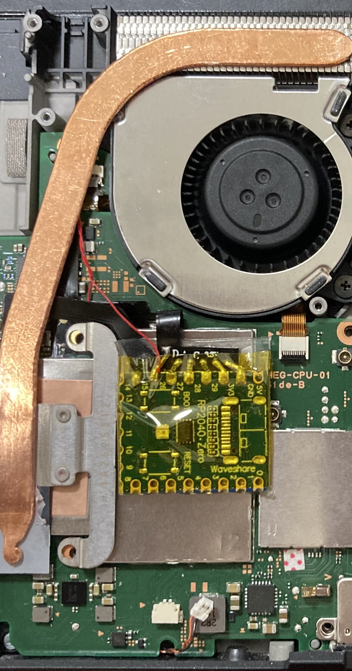

Good evening everyone, I'm new to this picofly, I would like to clarify three doubts. of the CPU, I saw some videos but I couldn't see well if and in the 3rd or 4th point of the flex if anyone has an image thank you, and does the resistor in the rst need to be placed? I saw some mentioning him.
Bridge 3+4 = this will eave 2 pins on the left and 2 pins on the right unsoldered. This is the way.

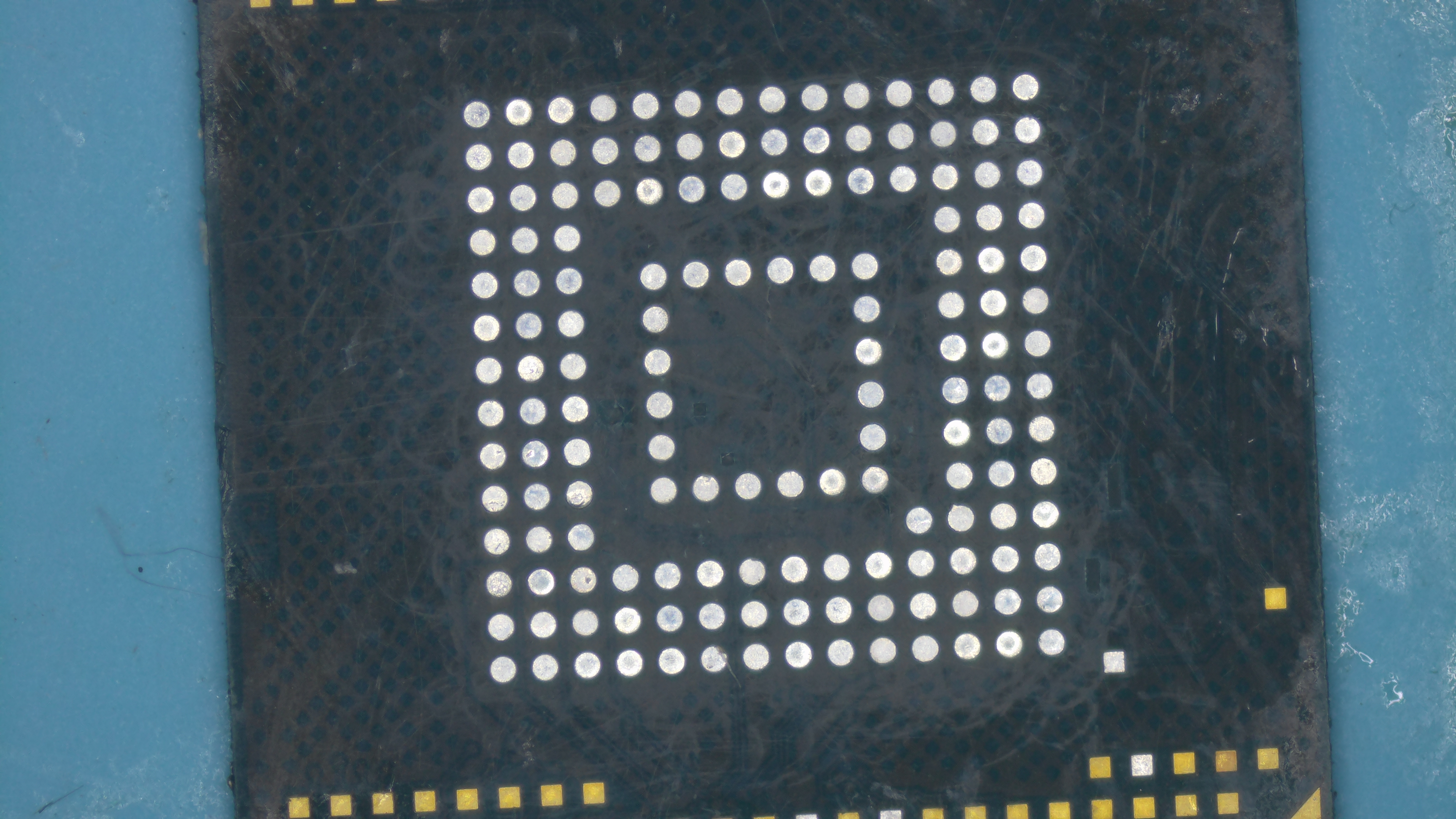

i do apply low melt solder to everything before i wick it away after that i always apply another round of low melt to get the rest of it wicked away
example from some test emmcs
thanks for the tips much appriciatet :-)
Emmc isnt to hard to reball, just be careful as they dont like to much heat and will kill them. If you have a nand backup you can work with more confidence - Pics look good. :)

yeah they arent made for those holders thats why eather goona try it first by handy and if that doesnt work im gonna cnc some holders :)
