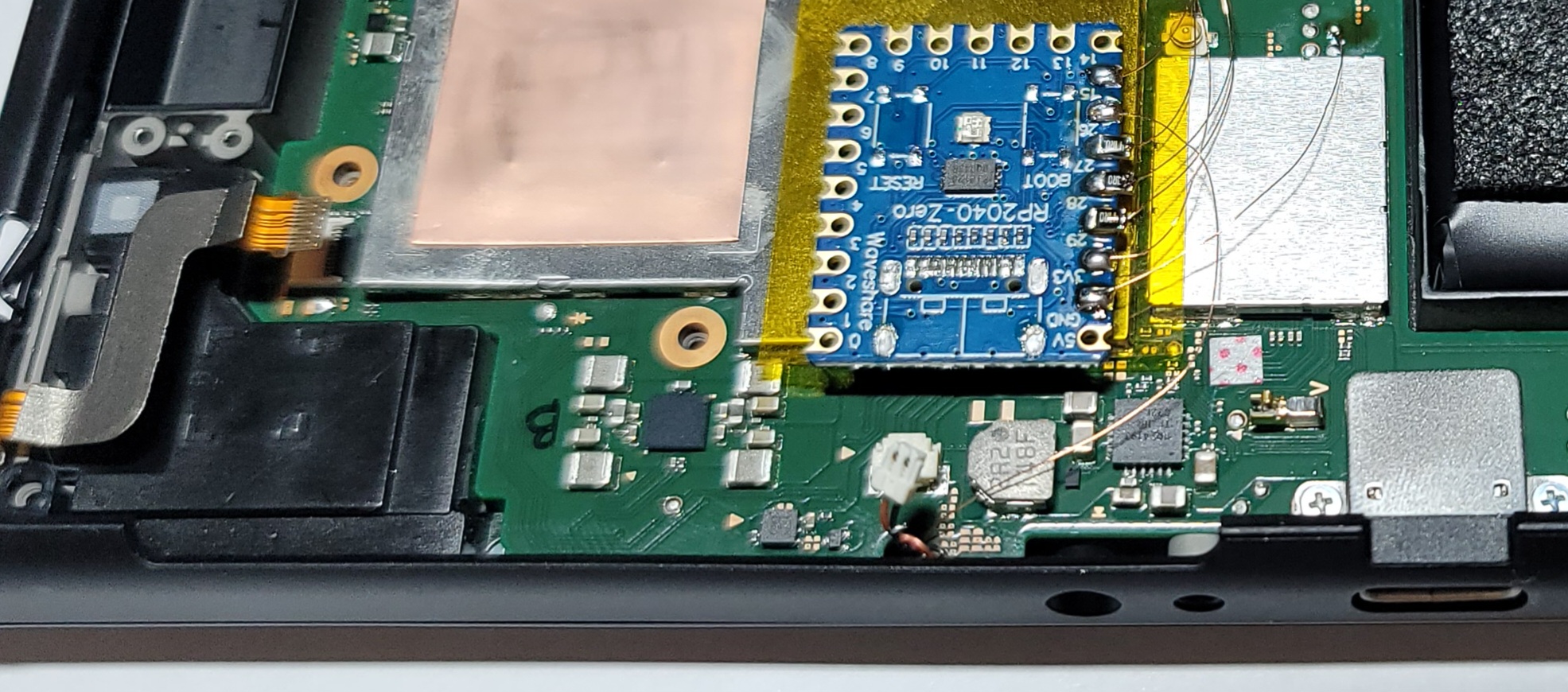

Last question, i have an OLED, after removing usb c and buttons ( probably regulator) does it fit on the back without cutting bulging anything? Anyone know the best spot/placement?
Reactions: Donnie-Burger
Kapton tape over chip once all tests are good to avoid any shorts. Cut kapton tap a little smaller to not cover wifi connection. No bulge. I re-routed reset wire around coil to not cover bq and get smashed by thermal pad.
Sorry mate, with this configuration, are you able to close everything well w/o trim the back metal shield?
Regards
Regards
Yeah with kapton tape covering chip so nothing shorts and tape also holds it in place. Wifi cable can be tricky to connect, you can route wires better but you get the idea. Can also put resistors facing inward and route cables that way or flip chip and wire other side but I wouldnt pinch any cables under heatsink/pipe like some do, simply route them around shit.
