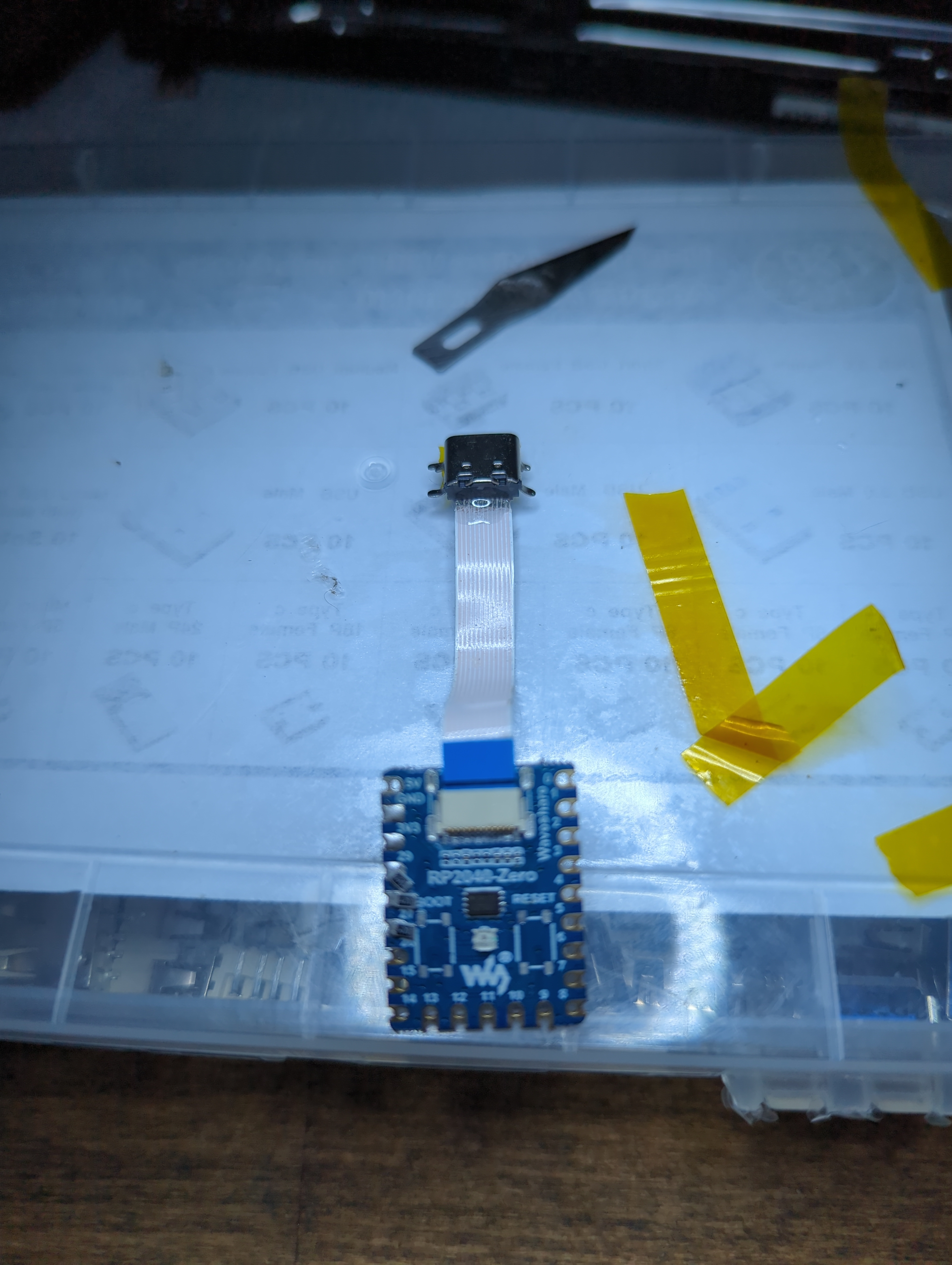

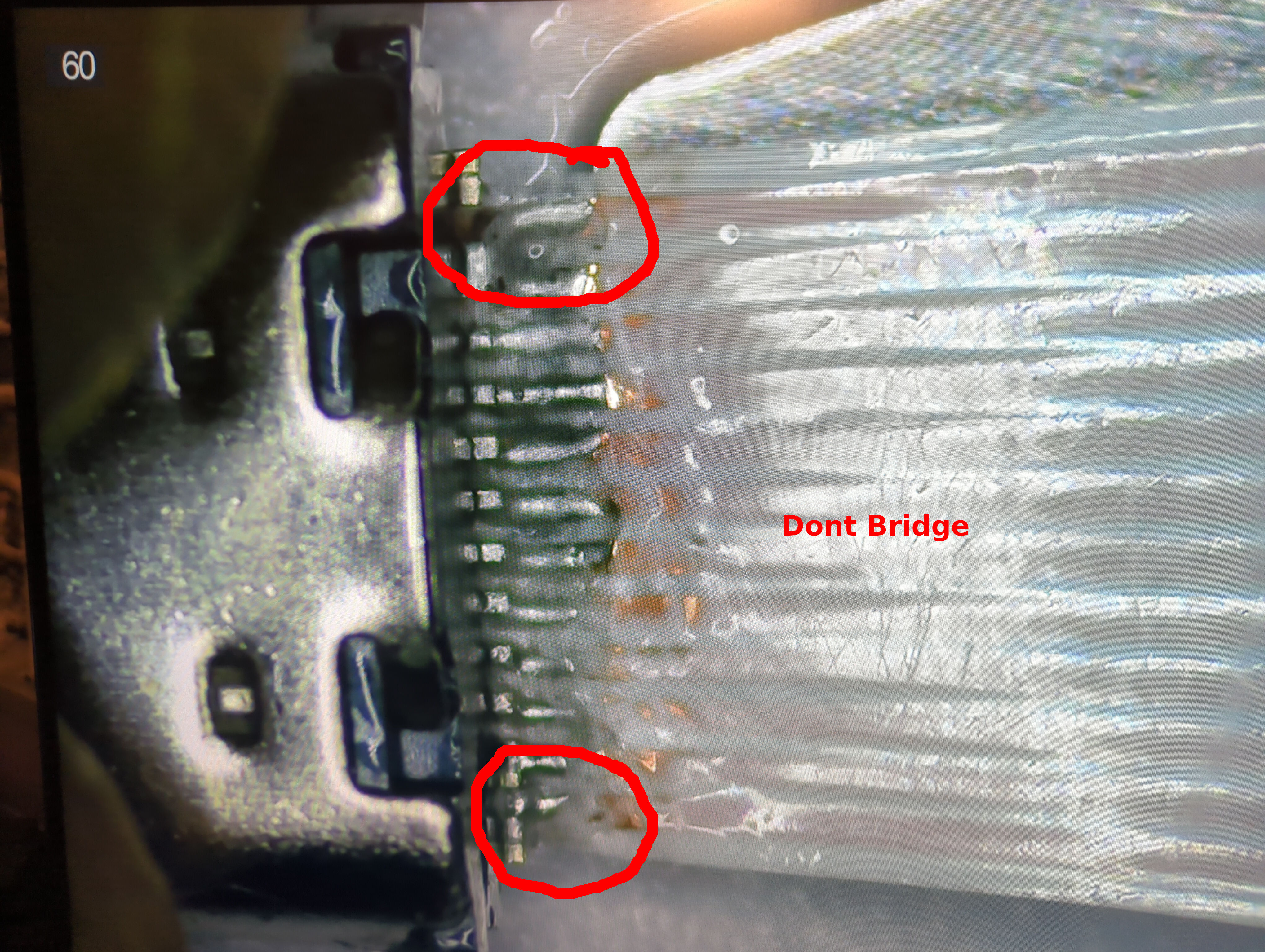

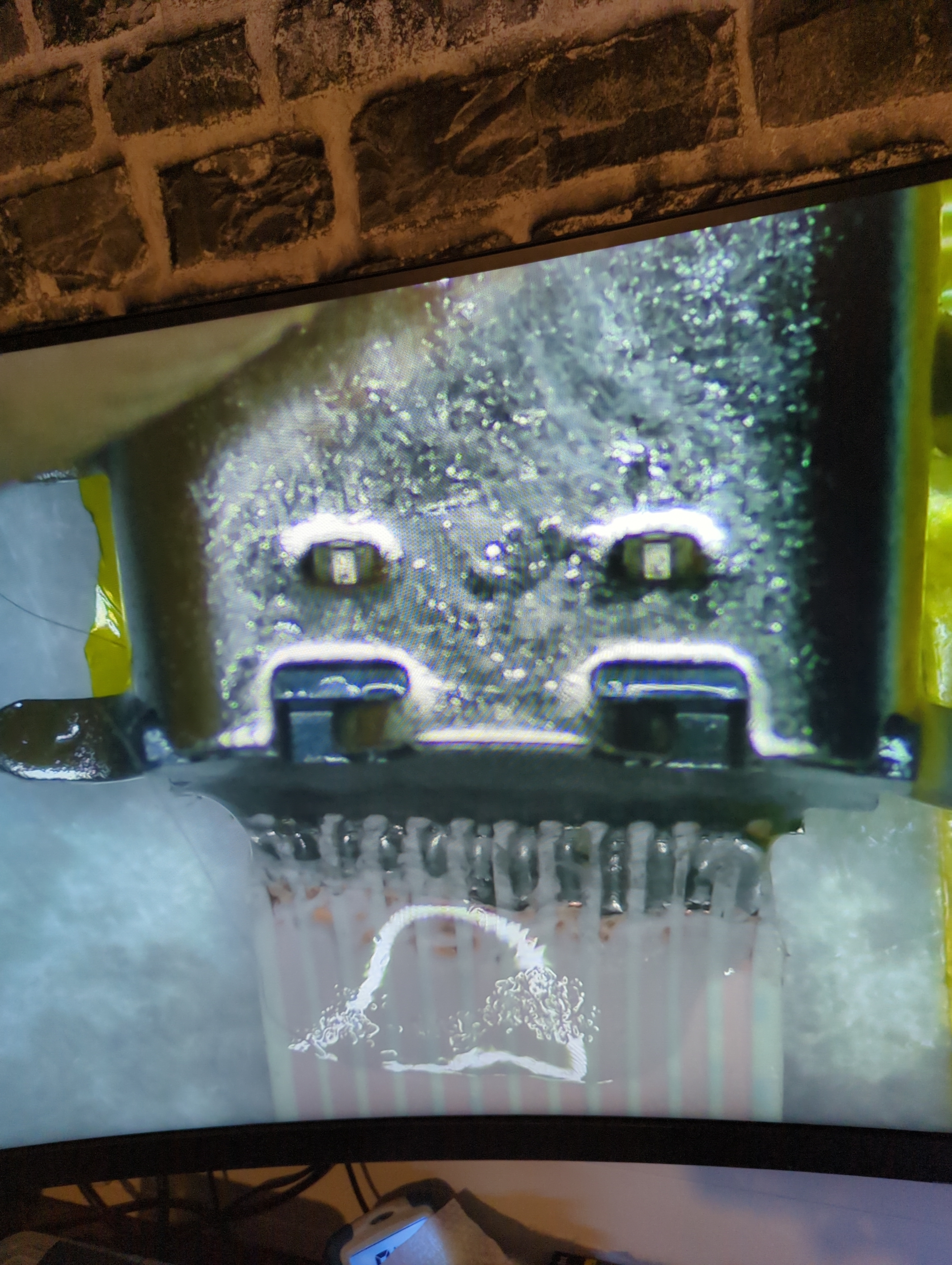

just built the adapter since i didnt have the otherside of the connector so i pealed of a bit and solderd it to it and addes some uv resin for streng and well guess what im able to flash it :-)
edit: i realized the picture is uploaded showed outter bridges so i added it so no one bridges THEM xD
View attachment 360557View attachment 360579
