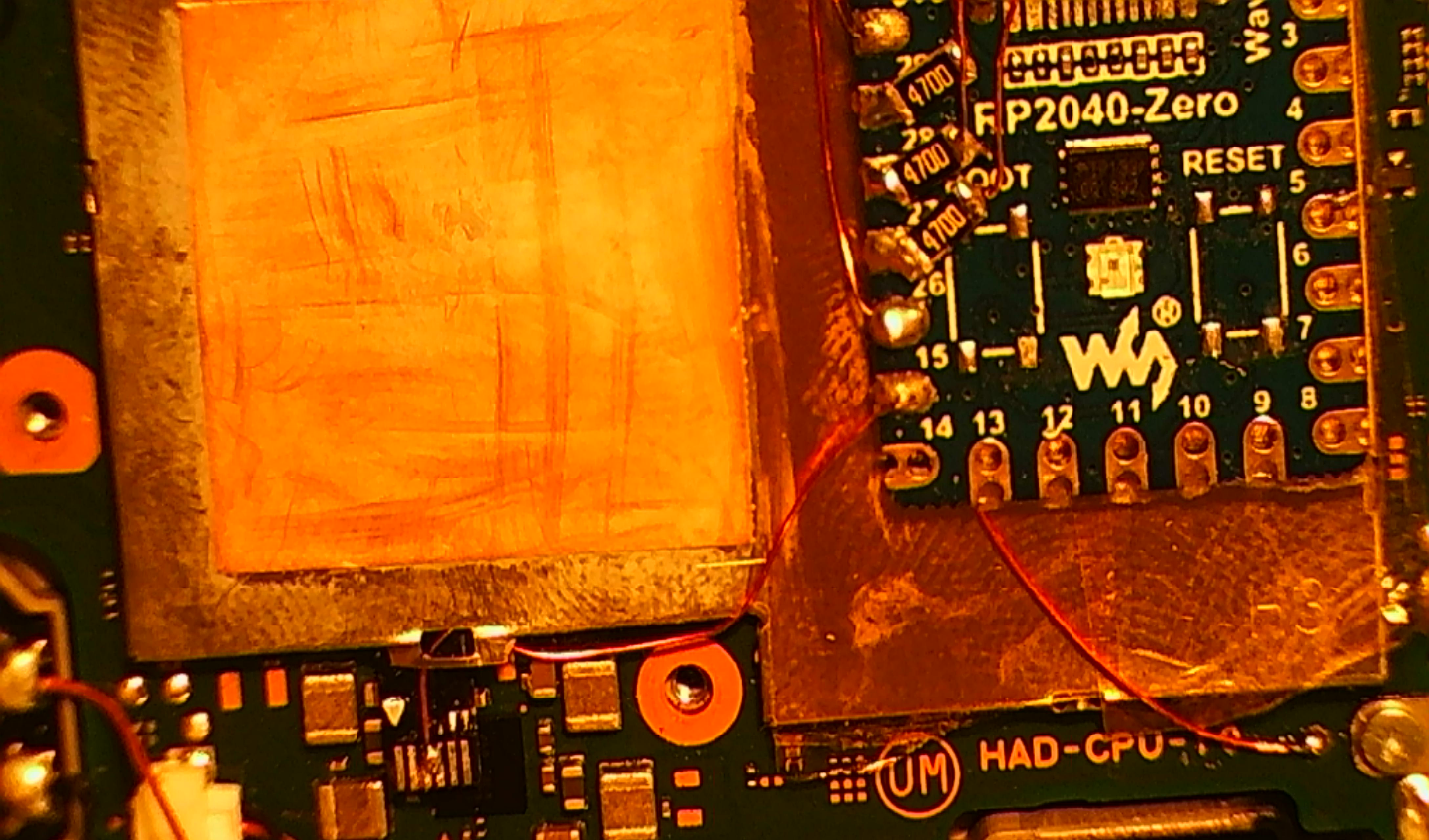

Hey all.. installed on a V2, removed the HWfly to play with the rp2040.. I enabled RGB on back, I get Blue/ purple and OFW Boots instantly. I have a V2 flex cable install. All Points show Value.. I've tired another RP2040 without any desoldering and resistors facing forward but get the same issue.. thanks for any help..
Would adding a line to the 2nd pad on the Flex cable change anything as thats the other trace line on the flex cable?
sorry for orange photos not sure why it took them like that

you have bridge the flexcable. It's only suppose to be on one line. (Image 2)
Double checking those are 47ohm resistors and not 470 ohm resistors
Check your emmc. It will show on it
Good eye, you just ruined my day lol.. all i have is 33 ohm resistors and the Switch Boots right away to Hekate.. I need to order the 47 ohm .. Thanks for catching that..

If I remember right, it's just the middle finger that needs to be solder on. Else you probably make it short out.
this is the v2 flex cable it looks like a single trace line going into both pads, i soldered to one just the make sure..
