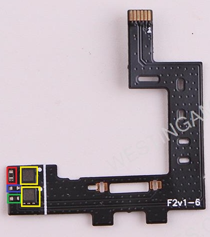

Can someone please give me the values of those resistor, red, blue, green, and those two mosfets in yellow ?View attachment 360567

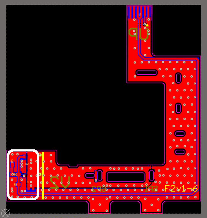

Also do you know with which software can we open leaked HWFly leaks schematics/ board files ? I tried Eagle/Kicad they are not working. Altium works but layout of pcb seems broken (see where the mosfet emplacement should be in white):
Thanks :P
Green is 2.2k Ohms
Blue is 0k Ohms
Red is 2.2k Ohms.
(here’s the shameful reason why I know about this now)
https://gbatemp.net/threads/hwfly-lite-cable-components.626438/

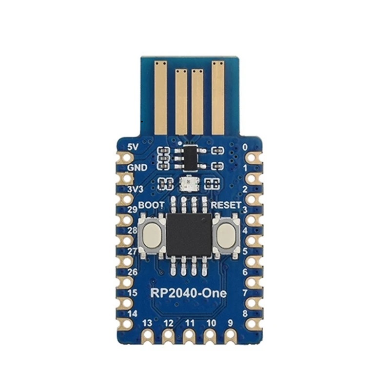

I had to cut a window for my Trinket M0. Been running that way for years now w/o issues. I did put some Kapton tape over the rough edges because I take apart all the time and don’t want to get a sheet metal metal cut.
Why are there wires running across the fan? Is that just temporary?
The wires are just laying so I could cut out the window for the rp2040
