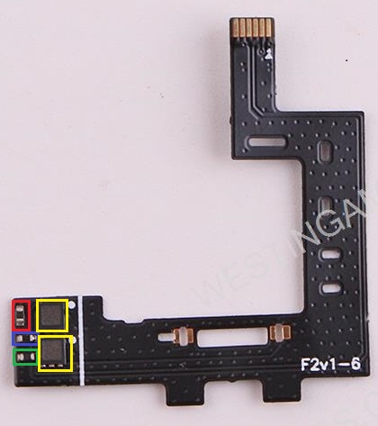

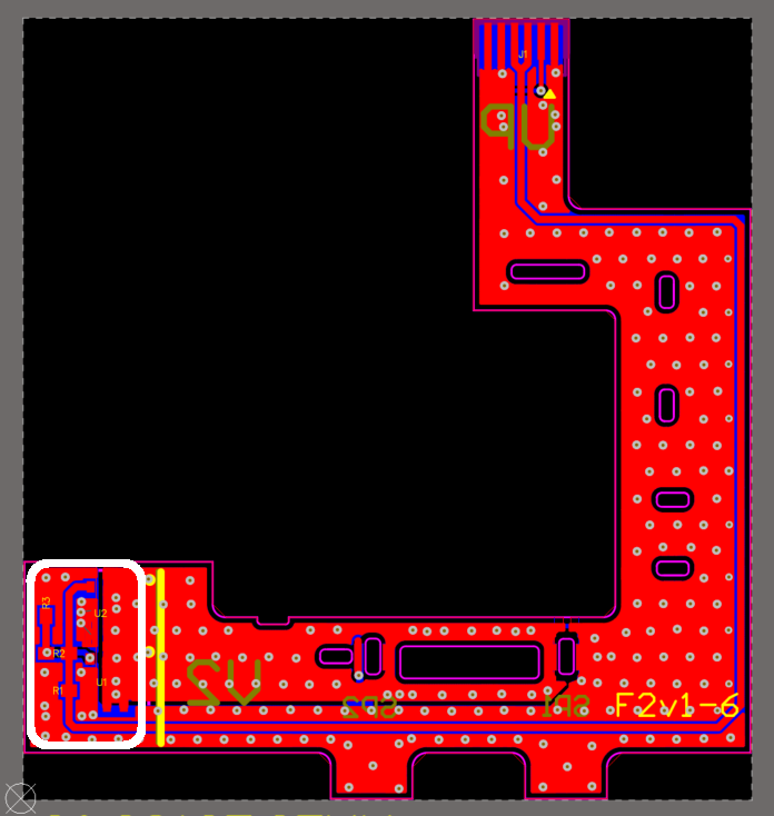

Can someone please give me the values of those resistor, red, blue, green, and those two mosfets in yellow ?
Also do you know with which software can we open leaked HWFly leaks schematics/ board files ? I tried Eagle/Kicad they are not working. Altium works but layout of pcb seems broken (see where the mosfet emplacement should be in white):
Thanks :P

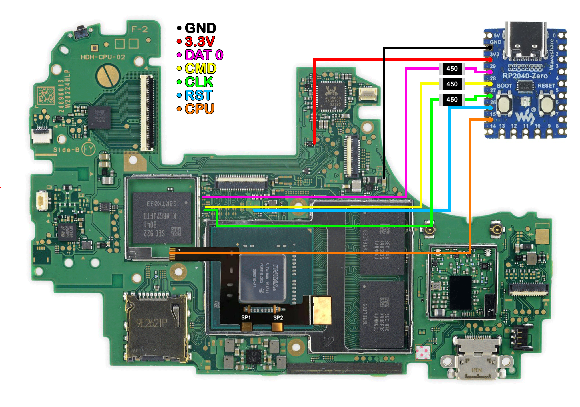

A: Erista (v1), Mariko (v2, Lite, OLED)
Q: eMMC types support?
A: Tested on Hynix, Samsung, Toshiba, SanDisk
Q: GREEN, but instant reset
A: Check your soldering, clean flux. If does not help = add 20K-30K to RST
Q: Do I really need 47 Ohm resistors?
A: You can skip them, however in this case you will have to use emuMMC due to the line interference, sysNAND would not boot.

Hi, sorry for the inconvenience, but is there a diagram to install the chip with the hwfly Flex cables in the V2 and Oled? I saw that there is a diagram for the Lite that uses the third pin of the Flex cable to take it to the "cpu" pinout on the rp2040, I don't know if this also applies to the V2 and the Oled
