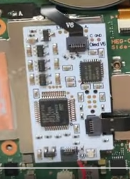

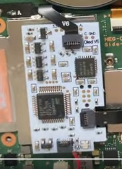

the Instinct-NX is no way a rp2040. Just look at it.
nor of these are rp2040 and rp2040 do not use external flash, think
Instinct is a gd32 with gw1n fpga. It’s not rp2040.
Forget lack of external nor flash; just the lacking external xtal is a dead giveaway.

I don't disagree. What I'm looking at tells me there's a 2040 variant. Might not be out yet and might not ever be out, but it was prepared for it.
Not surprising TBH, RP2040 chips are very cost effective, much cheaper than legit STMs and could probably be cheaper than the GD32 as well, if the cost of gd32s goes up manufacturer will probably change to 2040 to keep price down
