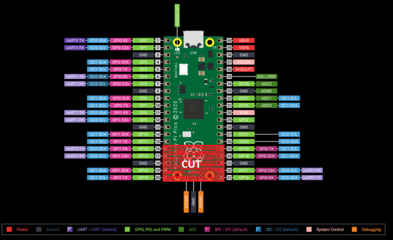

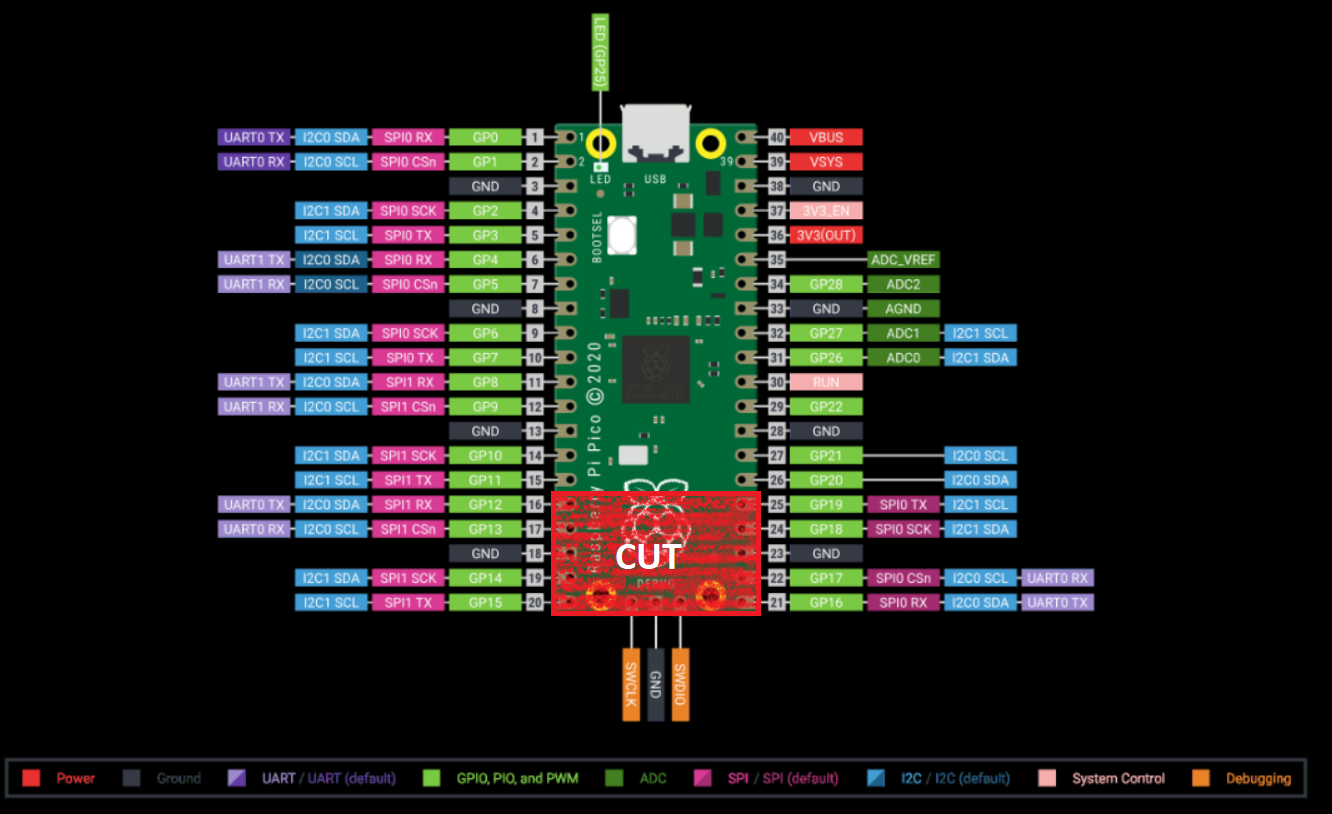

One question, it would be very difficult even cutting the Raspberry Pi Pico to make a variant
RP2040
pin 1(GP0)-2(GP1) - Reset
1-pin GND
2-pin 3V3
3- pin 29 - GP29 - ADC3
4- pin 28 - GP28 - ADC2
5- pin 27 - GP27 - L2C1 SCL - ADC1
6- pin 26 - GP26 - L2C1 SDA - ADC0
7- pin 15 - GP15 - L2C1 SCL - SPI1 TX
Rasperry Pi Pico
1- pin 3 GND
2- pin 37 3V3
3- pin 29 - GP22 but this is only digital
4- pin 34 - GP28 - ADC2
5- pin 32 - GP27 - L2C1 SCL - ADC1
6- pin 31 - GP26 - L2C1 SDA - ADC0
7- pin 15 - GP11 - L2C1 SCL - SPI1 TX
RP2040
1-pin GND
2-pin 3V3
Rasperry Pi Pico
1- pin 3 GND
2- pin 37 3V3
Thanks again for your work, fascinating
i dont think it would be smart to cut it cause u have a multilayer board there and maybe missing some traces later on .
might work but u might have issues and a complete non functional board later on
RP2040
1-pin GND
2-pin 3V3
Rasperry Pi Pico
1- pin 3 GND
2- pin 37 3V3

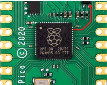

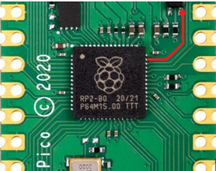

If it was easy for me, I would buy it and I would get rid of the above problems, but from my country it is difficult to import and
The board I have is the Pi Pico, the ADC3 can be obtained by following a microprocessor pin, what is connected there is a sensor Of temperature. The goal is to have other possibilities. Greetings
Reactions: binkinator
aha. I understand your situation. I think you are going to need different firmware to trigger the correct pins, no?

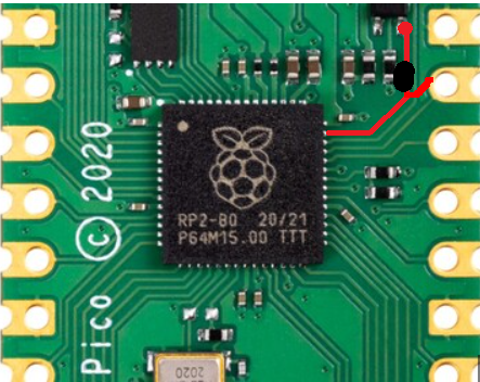

if the other pins are in the correct position maybe jut cut the line and move it to a otherpin that is not needed?
maybe like this yes?
