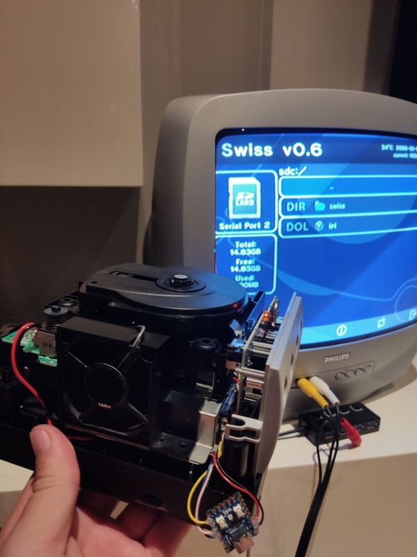

Pico W is not officially supported yet but it should work. There is definitely an issue in your wiring if you get no video output. Post pictures of your install.
Oh my god I definitely thought I replied to this after I l liked it, anyways I finally got it to work just today. It turns out it was my wire gauge, I was using 30 AWG, I switched to 26AWG and it worked
EDIT: here's a pic of what my install looks like
