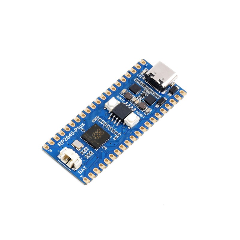

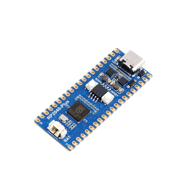

Save yourself all that work and just get a Pico with USB C on it:
Normally, I would but I am also using this as an opportunity to learn, possibly make something I have never attempted before, and if it works, it would be usable on the Pico W, which doesn’t have a equivalent to the one that you showed. The other concern is that Picoboot’s creator has already said there will never be official support for clones. Now the one you linked might currently be identical to the Pico in every way except the USB port, but that could change without warning and then someone still has to switch, pray the changes don’t affect their ability to use Picoboot, or work their ass off.
Besides, I like the idea of staying true to @hdx ’s main branch since it should be the base for anyone else’s branches.
EDIT: Also, the Picoboot’s GitHub has already confirmed that the Pico W will be officially supported.
