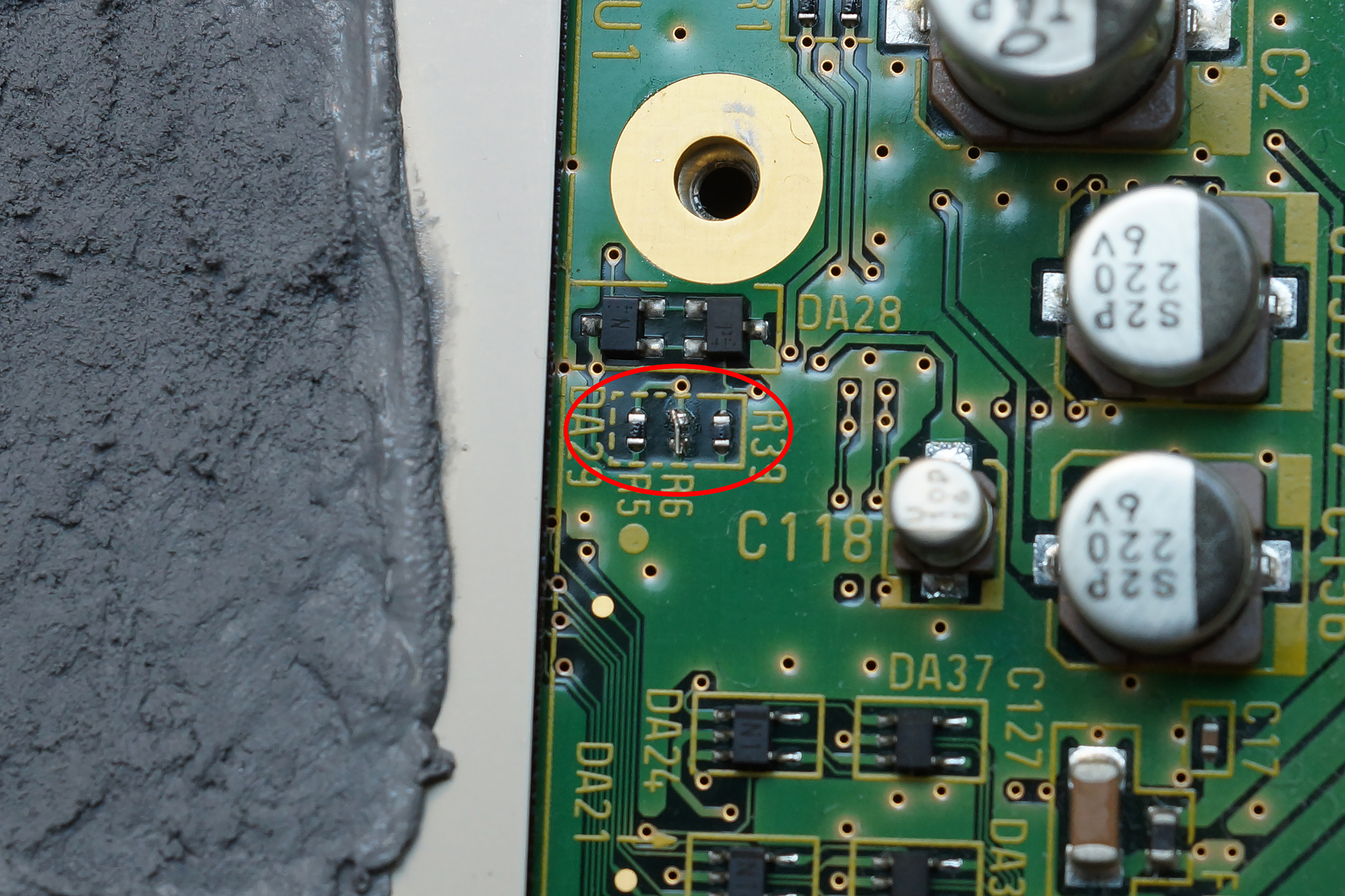

Installed PicoBoot and it works great. But there is a problem: I have a JP version of the console and I turned it into US by soldering a jumper on the pad R6 next to the CPU. So, after installing PicoBoot, the console reset to Japanese when I load the vanilla IPL. Is there a solution??

Pico is region free.

I soldered a piece of wire as a jumper and converted the console from Japanese to American version. But after installing Pikoboot, the interface returned to Japanese again, even with this jumper
