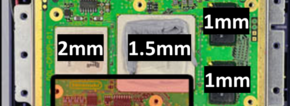

  • During the work, I replaced the thermal pads. If you want to do the same here there are the thickness:
