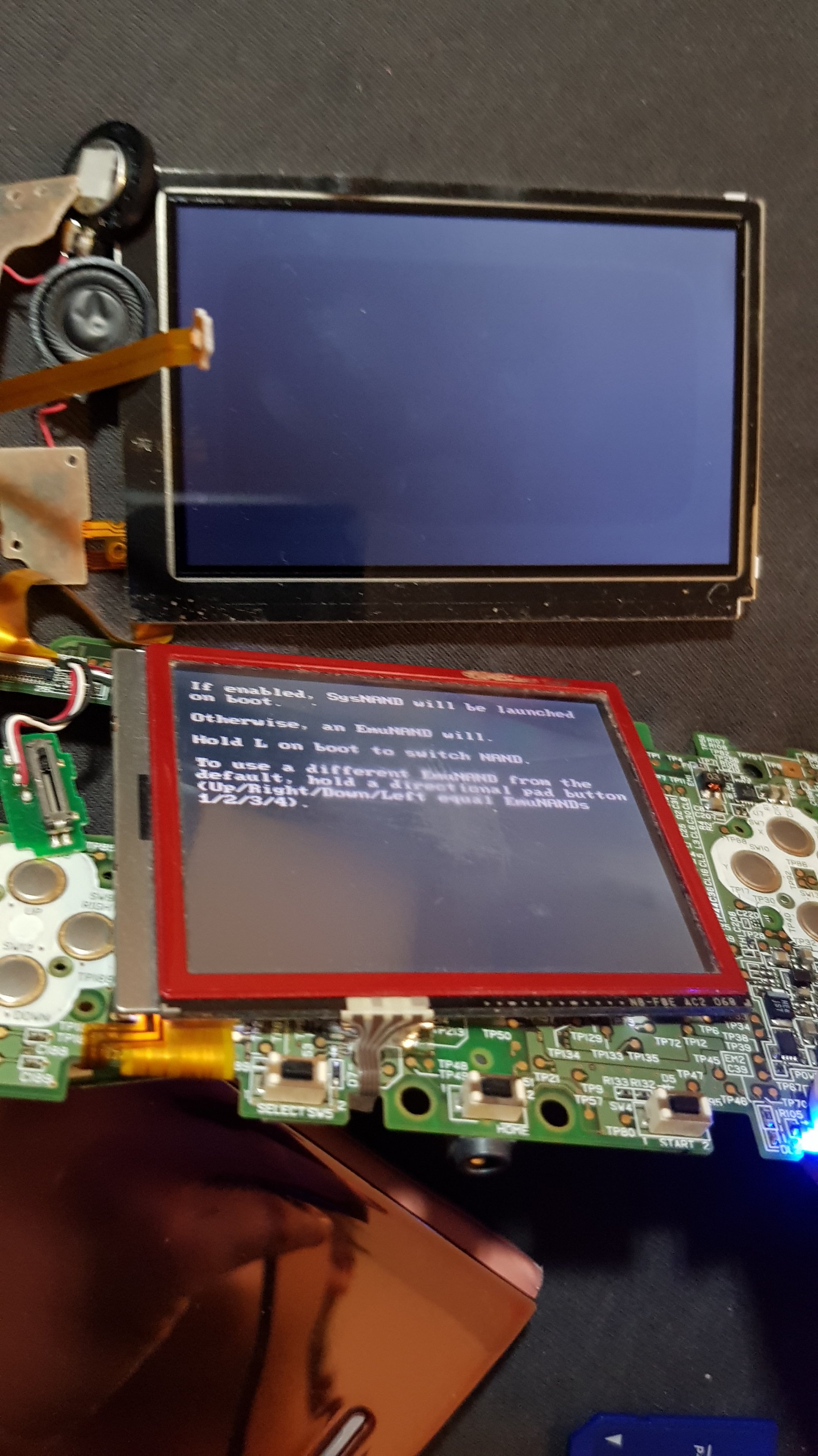

Yeah, it's working with the new SD card reader
But it still won't boot the SafeB9SInstaller
Now the 3DS won't turn on anymore. The blue light illuminates for 3 seconds and then turns of. I can hear a pop from the speakers, but the F fuses are fine...
