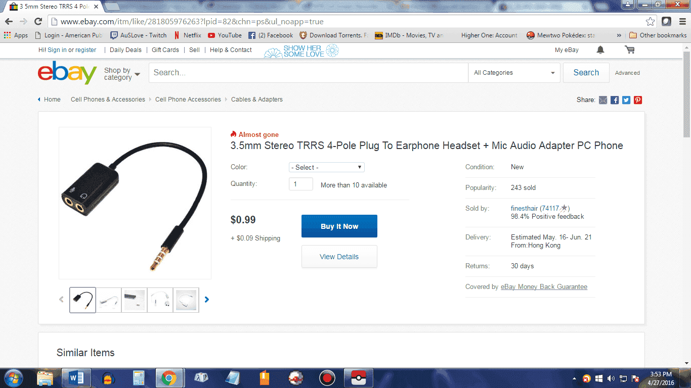

Mine has the same, a built in mic and a dual headphone/mic jack. The problem is that "most" of those dual jacks on Laptops are 3-pole 3.55mm Jacks which can only support ONE audio in/out at a time. The ones with the headset mic icons are 4-pole 3.5mm jacks (the same ones smartphones use) and will support audio in and audio out on the same port. Other wise you need to purchase a 3-pole to 4-pol3 3.5mm adapter. Something like this: View attachment 47157
I think I'm gonna try the 4 pole one, I bought a 3 pole not knowing. I'll keep you updated, thank you. Do you use the 4 pole 3.5mm aux cord
No mine is 3-pole Male-to-male. I use it on a PC that has an actual "line in" source as well as a separate 3.5mm jack for mic and headphones.
