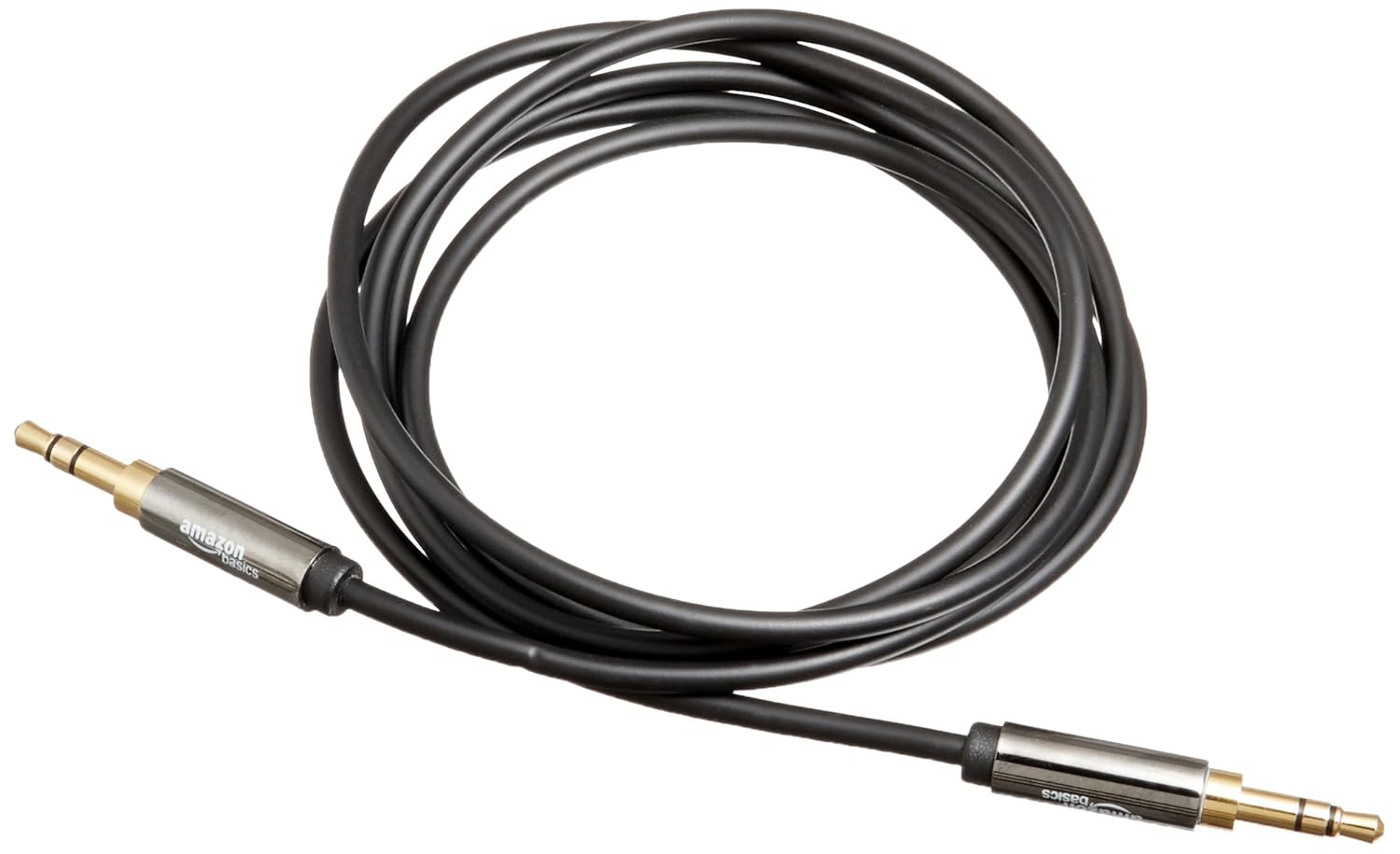

final question i cant recall coming across it in this thread but how do you record audio?
With something like that
