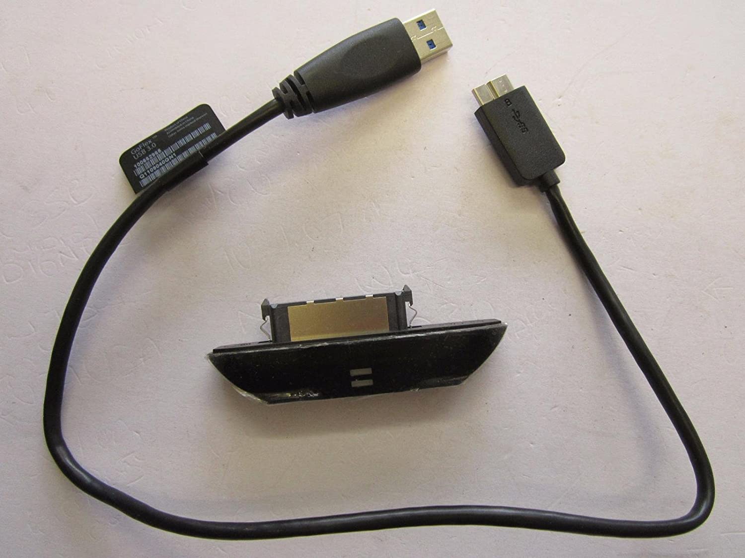

I actually use raw/bare drives all the time, I just use a usb to sata adapter, or the attachment that came with my Seagate goflex drive. I don't know if they still make those, but those were/are sweet. I got 4 of them back in the day 2x1tb with usb2.0 adapters, and 2x1.5tb drives with usb3.0 adapters, and an extra esata adapter. I find the usb 2.0 adapter works better for the wii, so when I'm using it on my wii I use that, but then to access the same drive on my PC I can just pop in my usb3.0 adapter. And the adapters can just attach to any 2.5 bare drive so it makes my normal sata to usb adapter kit redundant.
Tldr, everyone should have one of these drives, buying one is like also getting a sata to usb adapter that works on bare drives

Amazon doesn't have a good pic of the adapter, but here's a pic

I actually use raw/bare drives all the time, I just use a usb to sata adapter, or the attachment that came with my Seagate goflex drive. I don't know if they still make those, but those were are sweet. I got 4 of them back in the day 2x1tb with usb2.0 adapters, and 2x1.5tb drives with usb3.0 adapters, and an extra esata adapter. I find the usb 2.0 adapter works better for the wii, so when I'm using it on my wii I use that, but then to access the same drive on my PC I can just pop in my usb3.0 adapter. And the adapters can just attach to any 2.5 bare drive so it makes my normal sata to usb adapter kit redundant.
