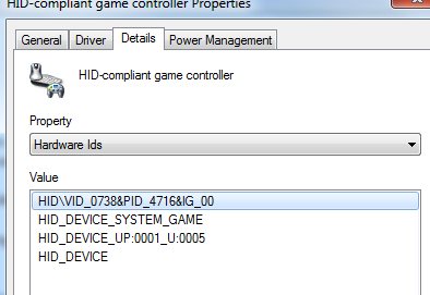

Confirmed... Madcatz 360 USB controller is HID... 'cause I attached it to PC and these are the VID & PID values
VID_0738
PID_4716
But when I test it in HIDTEST on Wii...it stays loading
"Getting list of HID compatible devices..."

Very interesting indeed, but I wonder if Nintendont still thinks it's using the Xinput API instead.
but it's an hope... at least it could be possible to add support on future loader or hidtest (.dol) ?
If the devs needs more info about the hardware values (other than pid/vid); just ask me... I really want to get this controller working with Nintendont
