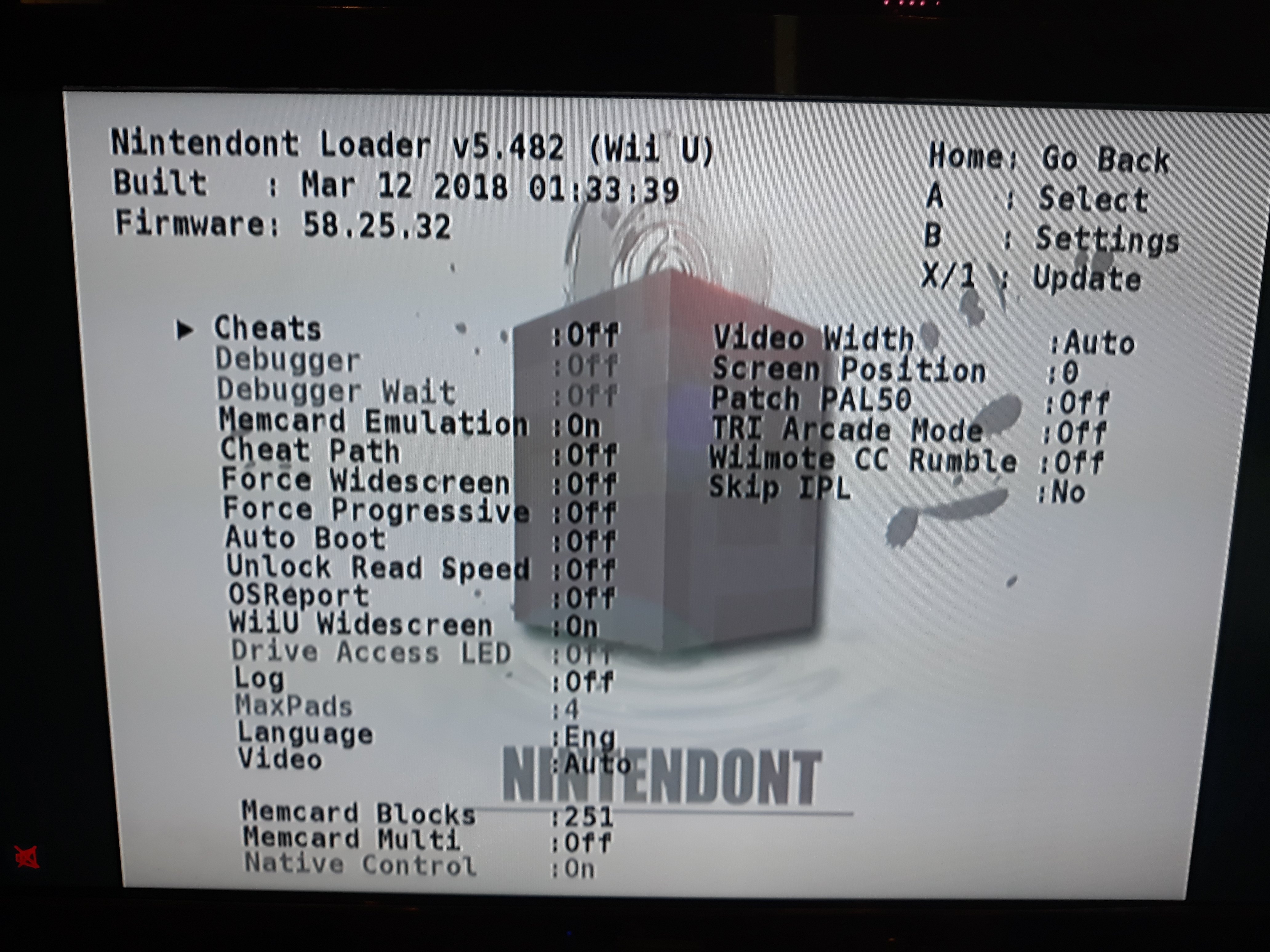

take a picture of your nintendont settings.~on vwii if you can.

I'm pulling my hair out here, ive tried different roms, different hdd, tried thru a loader (but I figured I should be able to make it work directly in nintendont first). Also fiddled with all the settings multiple times.
My WiiU has had issues, as in the HDMI port stopped working so i have to use the component cables, but i doubt that will affect this?? And its very frustrating because ALL of my controllers work in the nintendont menu, including the gamecube ones with mayflash adapter. So it should just work when i load the game, but it doesn't :'(
Also some more information -
I dont run any CFW other than Mochi (but i dont run Mochi prior to launching vwii since there is no need for CFW for Nintendont? right?)
I am on 5.5.1
I used the tutorial for hacking the vwii that is sticked on these forums [The Definitive vWii Hacking Guide!], so i installed the recommended CIOS files. [d2xv10-beta52-vWii].
Also have installed the Modified IOS 236 as per the tutorial
I tested with Mario Kart Double Dash and Mario Party 4.
The games dont boot at all thru the USB Loader (USB Loader GX, could be a settings thing i didnt spend too much time) but they do atleast boot thru Nintendont via the HBL.
I am using a usb thumb drive, since i dont have any hdd's spare right now, ive tested with two different models/brands.
If i can provide any more information for someone to help me let me know!

you have native control set to on on the settings... wich makes any controller not read in game...urn that off you must have turned that on on usbloader or on the actual wii since native only works on original wiis, if you ant turn it off because its locked just delete your config file on usb and sd wherever it is and make a new one without turning it on.
Didn't even see that on. I don't know why no one has made Nintendont automatically turn it off when it detects a Wii U. Hey @FIX94, calling you.

Wow, so because it was blanked out, i assumed it knew it was a wiiu, and that the native control setting was just there as placeholder because it cannot be used for wii u.
I cant believe that is all it was...i swear i tried to change that setting earlier.
Anyway, seems my gamecube controller is now working!
thanks so much.
