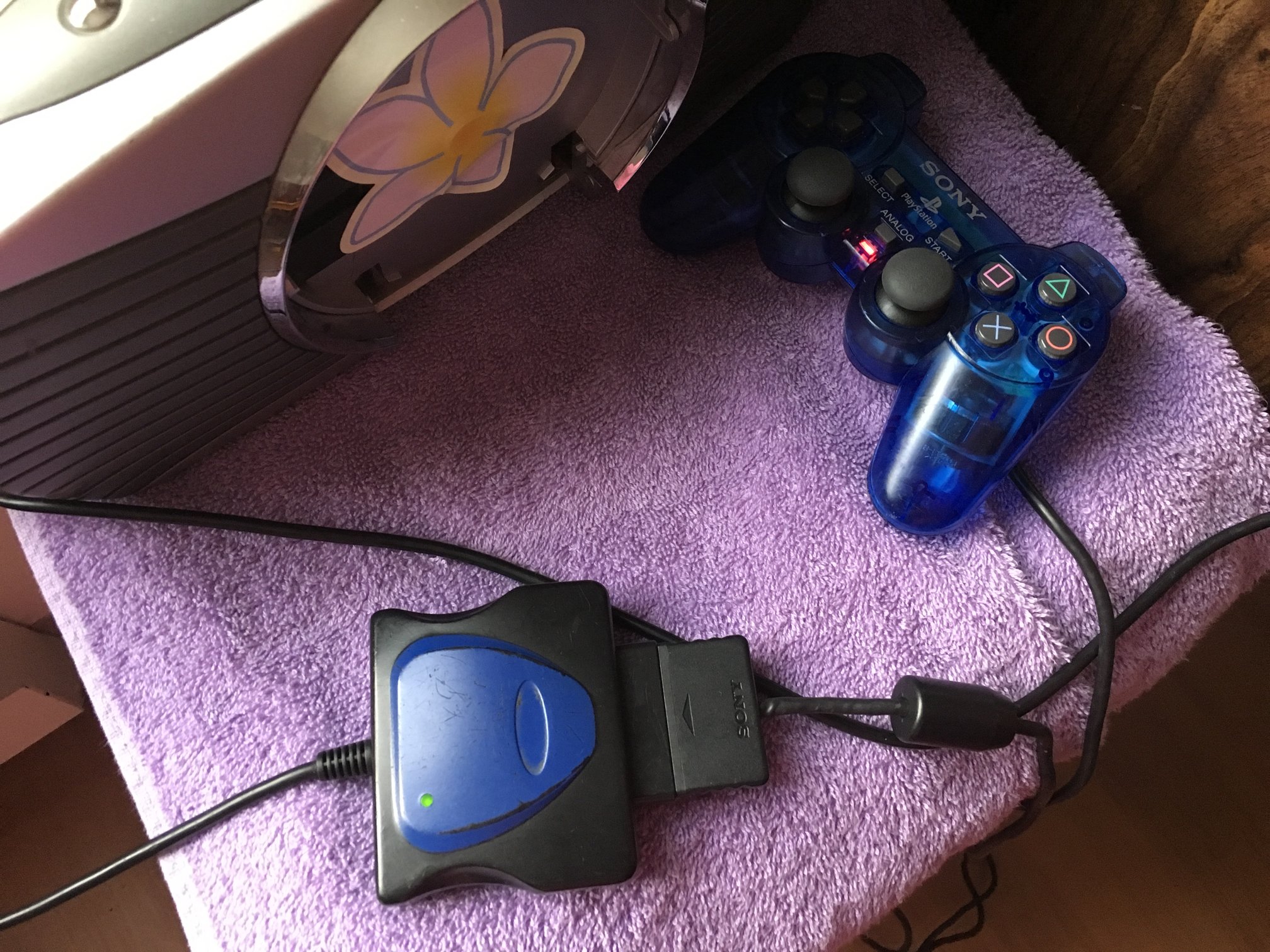

so after even using a newer Nintendon't one that has tones of ini control files in its folder I still cant get my ps2 controller to work with it ..the tester shows it works but the Nintendon't doesnt read it -_- need a new update to support usb keyboards cause its methods are failing the tester is pointless sure it reads it shows the numbers shows its compatible but doesn't help when the program its used for cant read it ..
on top of that getting out of Nintendon't when you sadly learn the controller doesnt work IS A PAIN IN THE REAR I literally have to hard boot the wiiu just to get out ..wow I gotta say this is not a easy program ..
A PS2 controller shouldn't need anything to work with it. Just delete any controller files and plug it in to a USB port. Reading the numbers in HIDTest doesn't mean it works with Nintendont. It just shows you the values the controller is sending. Have you not read the controllers section of the OP?
I have tried no controller ini! thats what i did th very first time i loaded nintendon't DOESNT WORK! unless its supposed to be in a specific usb port I have yet to get it working this program is frustrating! yes ive been through everywheres I can NOTHING HELPS
I think they think a usb ps2 works but in all I dont believe it and im annoyed that its listed as one that works but doesnt -_- ive tried everything, no config config, put it on the root of sd card then put it in folder marked controllers .. then moved both those to usb where the games are ... seriously ticking me off ... heck I even got a ps2 ini from retroarch that actually states the adapter https://github.com/libretro/retroar...7866cc9b2/hid/PS2-PSX_Controller_ Adapter.cfg renamed it to controller.ini
nope no go, nothing works...
not a single ini ive tried or found makes this controller work but HID tester on the wiiu shows it working quite well they seriously need to update this thing to support more HID controllers and pc keyboard would be nice -_-

You must have some issues ...
there are like hundreds of ps2 usb adapters, each adapter has diferent pid,vid values and such you cant just get a random ini and hope it works lol, nintendont added all the inis that were made by people no one made an ini for your adapter thats it..., people cant make inis for adapters they dont own since they have no idea what the values are.
also that retroarch ini adapter would never work on nintendont at all becuase it doesnt follow the nintendont adapter structure, inis are not a generalized thing, you cant add support without having them and seeing the values they produce.

if on hidtest your vid/pid value do not match this then its useless to you, since its a diferent adapter, just because you use a ps2 adapter doesnt mean you can randomly pick a ps2 ini out of another adapter it doesnt work like that since every adapter sends diferent values for every button.
You need to make your own ini

I has tried that ... MY PS2 - PS2 Adapter to the back bottom usb of the WiiU Nintendon't and the USB LOADER GX Nintedon't pulls the game up but the buttons don't work..

My ps2 controller needs a adapter to go into the wiiu o.O...
it doesnt have a usb end it has a ps2 controller end thus the adapter ..
yea I tested Nintendon't alone it still doesn't work but all the games work and load up but the controller doesn't make the game start ..

I don't know what to tell you. Unless someone else has that adapter you'll either have to try to make an INI yourself or perhaps try picking up an inexpensive HID controller from Walmart or somewhere like that. You can play games with Nintendont with just the Wii remote and a nunchuck or a classic controller or Wii U Pro controller, too. The OP has a list of HID controllers and adapters that are known to work.

THANK YOU GreyWolf got a newer Nintendon't reinstalled it then refollowed the mapping controls this time it worked !!! thank you for your patience and thank you for not blowing up on me !

you forgot ps2 controllers arent usb lol, so you cant connect them to the console directly xD, only ps3 and ps4 controllers are usb.
