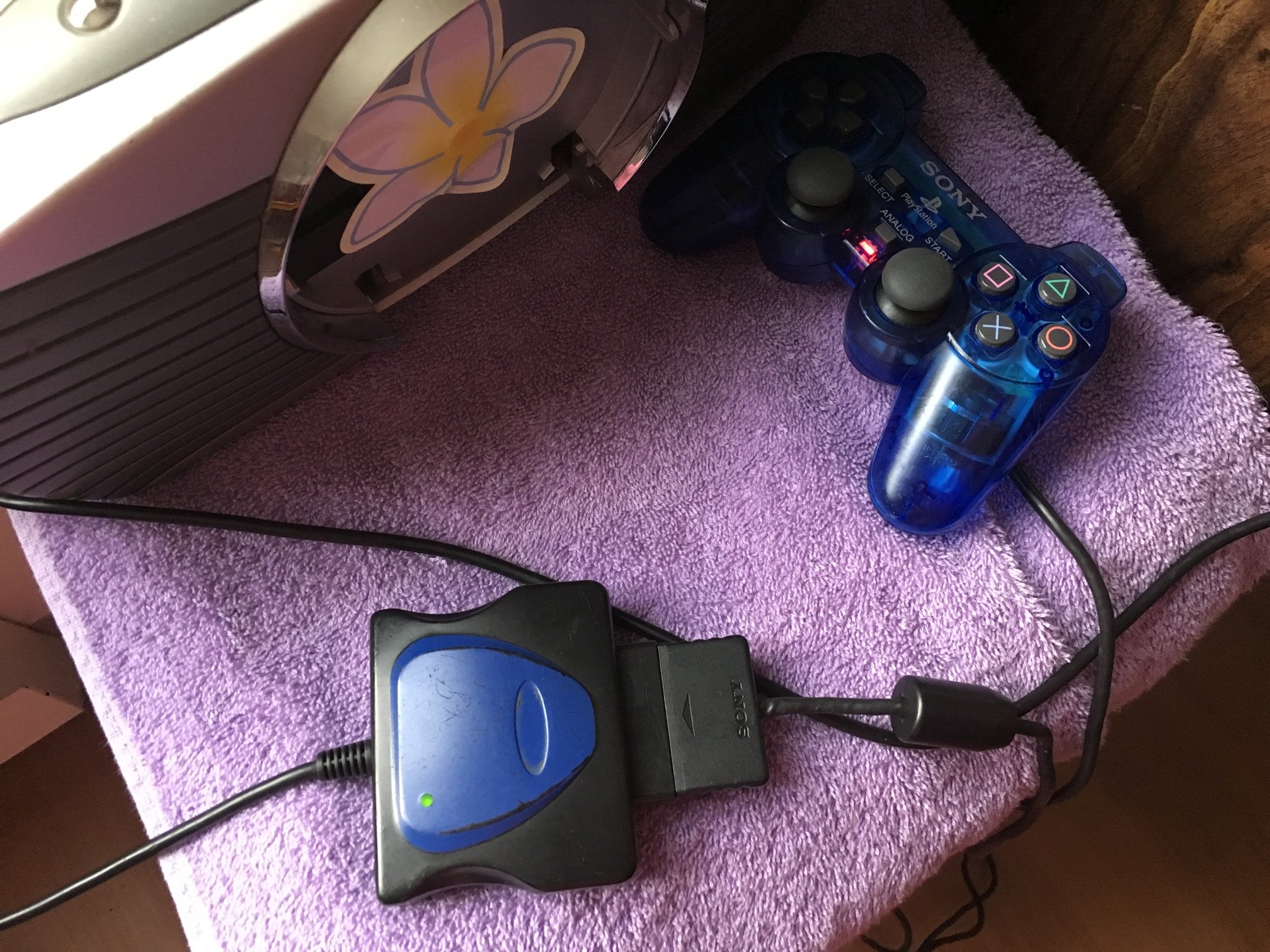

Ok I have Usb Loader GX, loading a Gamecube.iSO with Nintendon't. I have a ps2 controller through a usb adapter, Tested it through the Homebrew HID tester. My controller works numbers move but Nintendon't won't recognize the controller no matter where I put it .. any idea why, Or how to get it working ..
Thanks for any replies
What kind of adapter? I don't think you can use a hub.
I hope thumb nails make the picture bigger but this is the usb adapter its old o.o so i dont know the brand
I even tried to use a USB keyboard x.x the games show and load but no buttons make the game work ..though like I said that tester states it should work ...( the usb ps2 controller) the keyboard fails to work in the tester or games..
if the adpter doesnt have an ini made for it you need to make it yourself if that is an usb adapter that is. nintendont doesnt make inis automaticaly neither does hid test, you have to manualy do them, nintendont has alot of adapters and known controllers on memory if its not putting an ini for that adapter is becuase it didnt find any match.
As for the keyboard I'm not sure USB is supported. If you have a Gamecube keyboard and ports on your console that should work, though. The keyboard USB commands would have to be translated and I don't think FIX94 added that.
Ok im slow ..so in steps how would I go about making this ini file? Thank you to anyone that can help me

My controller adapter is this:
PS2 Dual Shock 2 controller
I even tried to use controller_PS2-030 renamed to controller.ini put that file in the root of the sd card tried to place it in the root of the USB drive even tried to place it in the games folder ..even tried the above with no renaming ..
[STEREN PS2-030 DUALSHOCK TO USB ADAPTER]
VID=12BD
PID=E002
Polltype=1
DPAD=1
MultiIn=1
MultiInValue=01
Power=6,01
A=5,04
B=5,08
X=5,02
Y=5,01
Z=5,20
L=5,40
R=5,80
S=6,08
Left=4,06
Down=4,04
Right=4,02
Up=4,00
RightUp=4,01
DownRight=4,03
DownLeft=4,05
UpLeft=4,07
StickX=0
StickY=1
CStickX=2
CStickY=3
LAnalog=0
RAnalog=0
