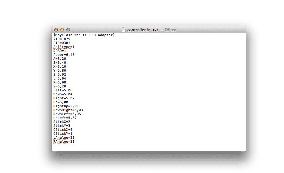

I uploaded my controller.ini file (I had to add the .txt extension to upload it) When I use the analog shoulder buttons on the classic controller and do the hid test, when nothing is pressed, HID test reports 6,00, when left shoulder analog=6,04 when right shoulder analog=6,08, but they do not pick up any analog sensitivity - it is as if they are just a digital button press. When I play the same game with the dolphin emulator on my iMac through the same HID setup (may flash classic controller to usb adaptor), the analog works fine, so I know the classic controller and the may flash adaptor has the potential for analog.
isn't it normal your file have no returns lines? everything is written in one long single line :huh:
I'm not sure I understand, is my controller.ini irregular?
It is, I don't know want you did on it but, everything is written with no spaces, no line returns, all in a single long line... Anyway I retrieved the correct file on the controller repositry.
interesting - this is what it looks like on my side- this is correct, right? - spaces and line returns?
View attachment 9835 interesting - this is what it looks like on my side- this is correct, right? - spaces and line returns?
it is correct for you lol it was messed up in my side. anyway could you try this?
