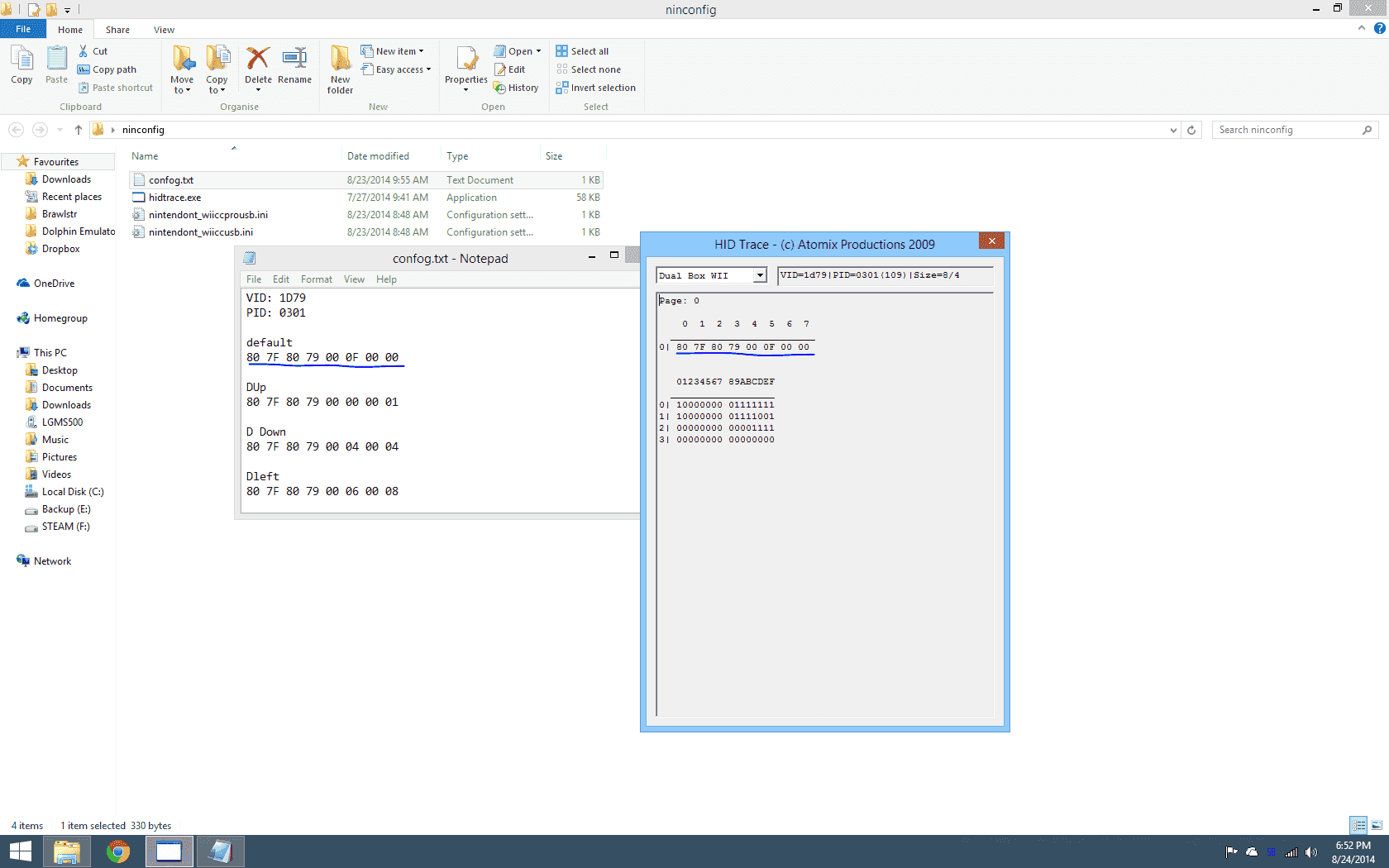

Thats strange mine is different by a few values.
Mine
80 7F 80 79 00 0F 00 00
Yours
80 96 74 73 00 0F 00 00
Guess your config won't work on mine. I'll try plugging in the classic controller till the game starts like you stated because mine never registered even with a few buttons configured.
Edit: Waiting until the game begins and plugging in the controller didn't work for me yet HIDTest gets button inputs from it i'm confused now.
I managed to fix up my configuration correctly now except for LAnalog and RAnalog but it still won't work ingame.

Edit2: Sorry about the long post but I found a program online called HIDTrace that has the same values as HIDTest on the wii. Could I use this to streamline configuring the controller better?
