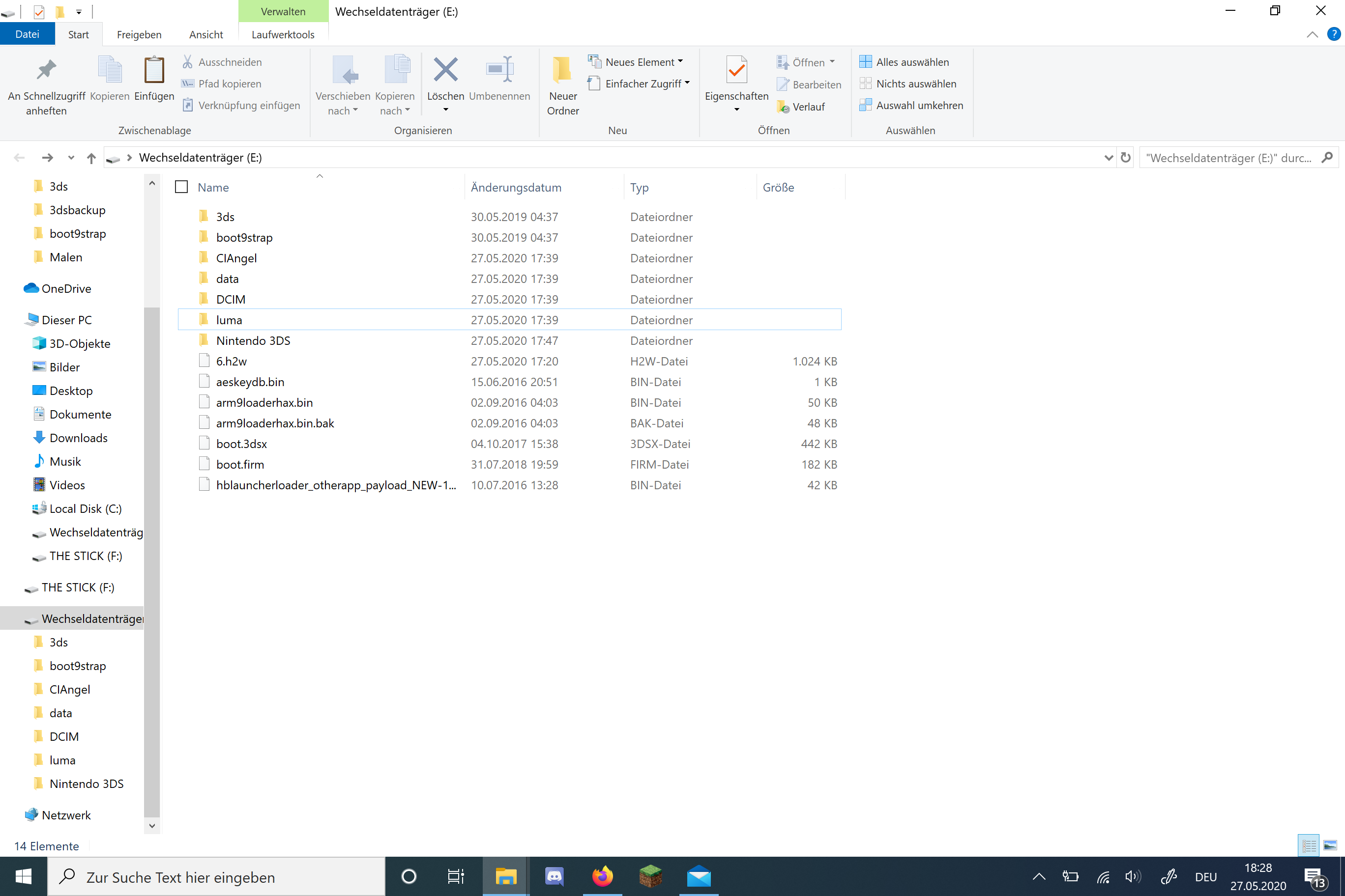

I bought a New 3ds XL, when I try to start it, the blue light stays on, but nothing happens, the screens are black.
It seems as CFW is installed on it. Attached is a screenshot of whats in the SDcard.
Maybe I can upload the contents of the SDcard later.
EDIT: I cant hear sound when I boot it, also, backlight is off.
I cant boot into recovery mode or something else.

Check if the n3DSXL actually still has B9S or A9LH custom firmware installed.
If it does not have custom firmware, rehack it with ntrboot.
If the n3DSXL is still softbricked after rehacking it, repair the 3DS firmware with CTRTransfer (Type D9) - CTRTransfer. Carefully read and follow the Instructions.
